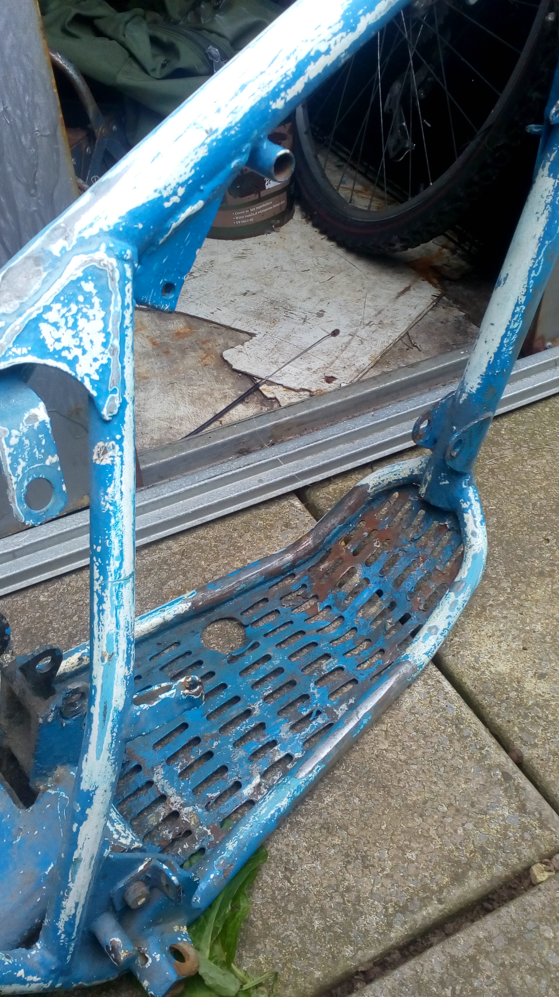

Old man Posted September 30, 2018 Author Report Share Posted September 30, 2018 Thankyou for info will look into buying black spray paint for forks when got last of paint off.The frame is white thoe but no Letter B at end the blue paint came of to easy like it was sprayed with cheap spray paint.No bash plate thoe tube with grill welded could it be a primer under blue thankyou Quote Link to comment Share on other sites More sharing options...

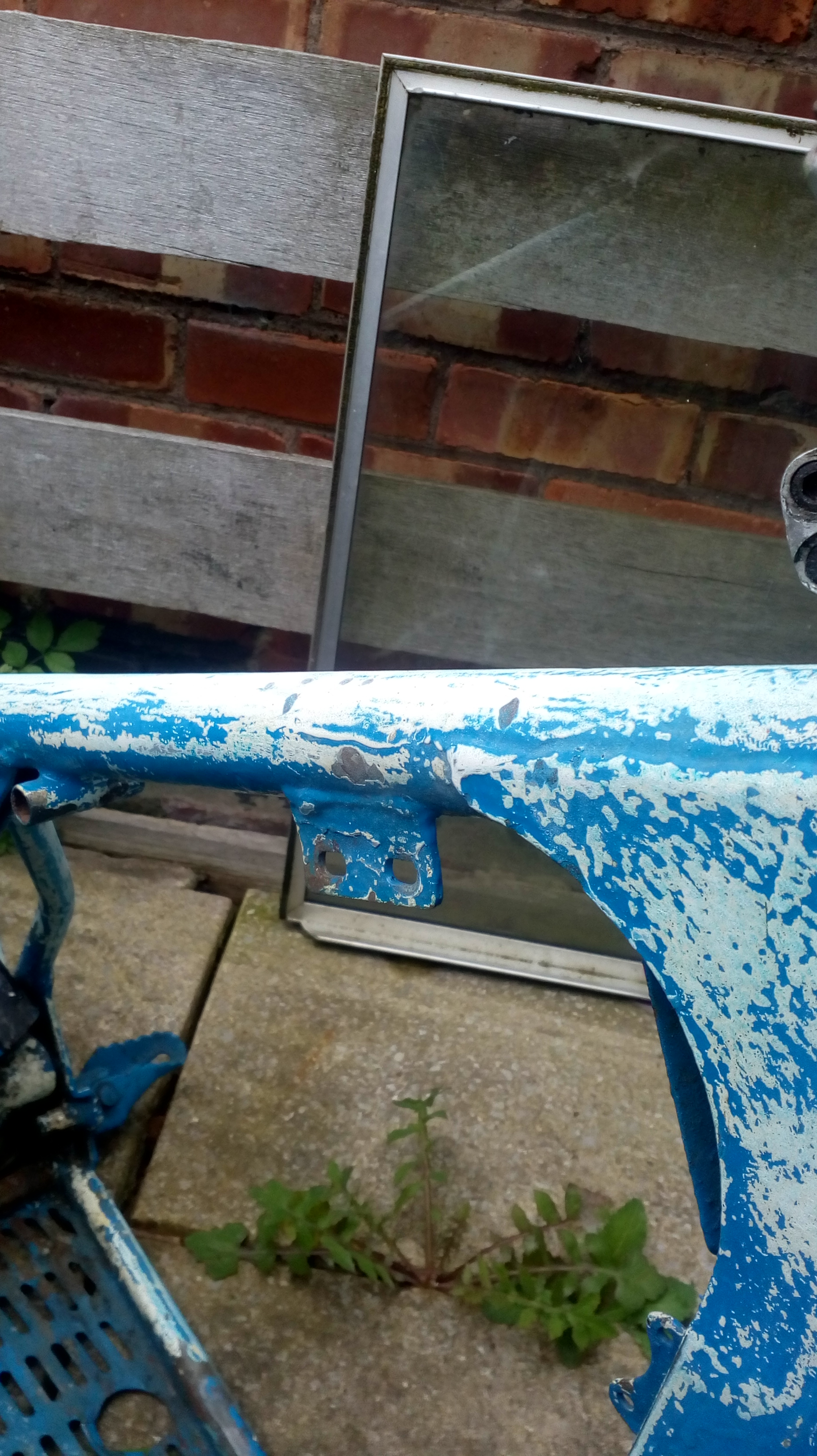

Old man Posted September 30, 2018 Author Report Share Posted September 30, 2018 Thanks for info this is the frame I was sanding other frame blue and silver underneath but this white.Is original colour blue then not white just want to put back to original looked up model chart and no pictures just 198b with bash plate colour white Quote Link to comment Share on other sites More sharing options...

woody Posted October 1, 2018 Report Share Posted October 1, 2018 Not sure if I can explain it any better than I have but whatever colours you find on those frames, you're asking what the original colour was for a 198 and that is silver. Remember how old those frames are, they may have been blasted clean of paint in the past and repainted any colour, and more than once. Originally, the B was white, the A was blue and the rest were silver (excepting the smaller capacity models) 2 Quote Link to comment Share on other sites More sharing options...
Old man Posted October 1, 2018 Author Report Share Posted October 1, 2018 Thankyou sir both frames go blue who ever done it white done a good job thoe thanks again for info Quote Link to comment Share on other sites More sharing options...
