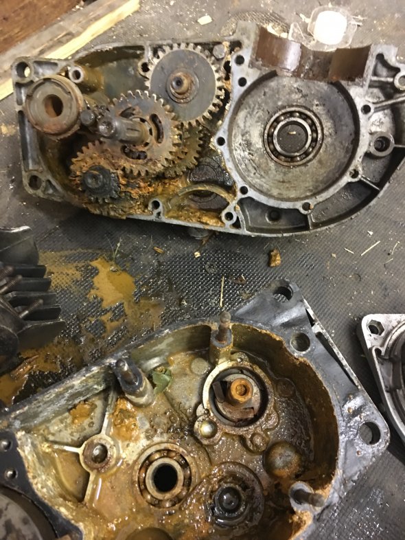

Cribbs74 Posted October 6, 2018 Report Share Posted October 6, 2018 Finally was able to split the 151 cases today. What a horrible mess inside. I think this thing sat outside for quite some time. I sure hope the 125 internals from my other engine will swap into this case. piston is still stuck in the cylinder, so will have to remedy that. Anybody know where I can find a parts catalog for cheaper than the $100 they want on Ebay? A photo copy would work fine. I have a Haynes manual coming, but it’s not model specific. I am attaching a couple pictures of inside the cases for fun... 1 Quote Link to comment Share on other sites More sharing options...

section swept Posted October 7, 2018 Report Share Posted October 7, 2018 Looks like everything needs to soak in diesel or Gunk for at least a month. With careful cleaning many of the parts will be reusable apart from the bearings. Quote Link to comment Share on other sites More sharing options...
Cribbs74 Posted October 7, 2018 Author Report Share Posted October 7, 2018 (edited) Thanks for the parts manual info. Definitely cheaper, shipping will cost the same as the manual I am sure. Some of it looks useable, hoping nothing is too pitted. I’ll soak it and see. So, I removed the piston. I was able to save the piston, but the sleeve is cracked at the bottom. It was bored over .075 so it was pretty thin. Not sure if I broke it or it was already broken. My 125 Engine has no sleeve whatsoever, so I guess I need a new sleeve and piston. Any suggestions? Thank you for the help and replies. Ron Edited October 7, 2018 by Cribbs74 Quote Link to comment Share on other sites More sharing options...
