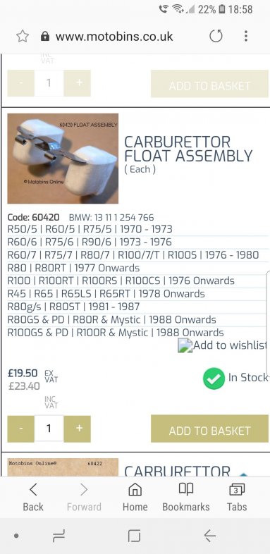

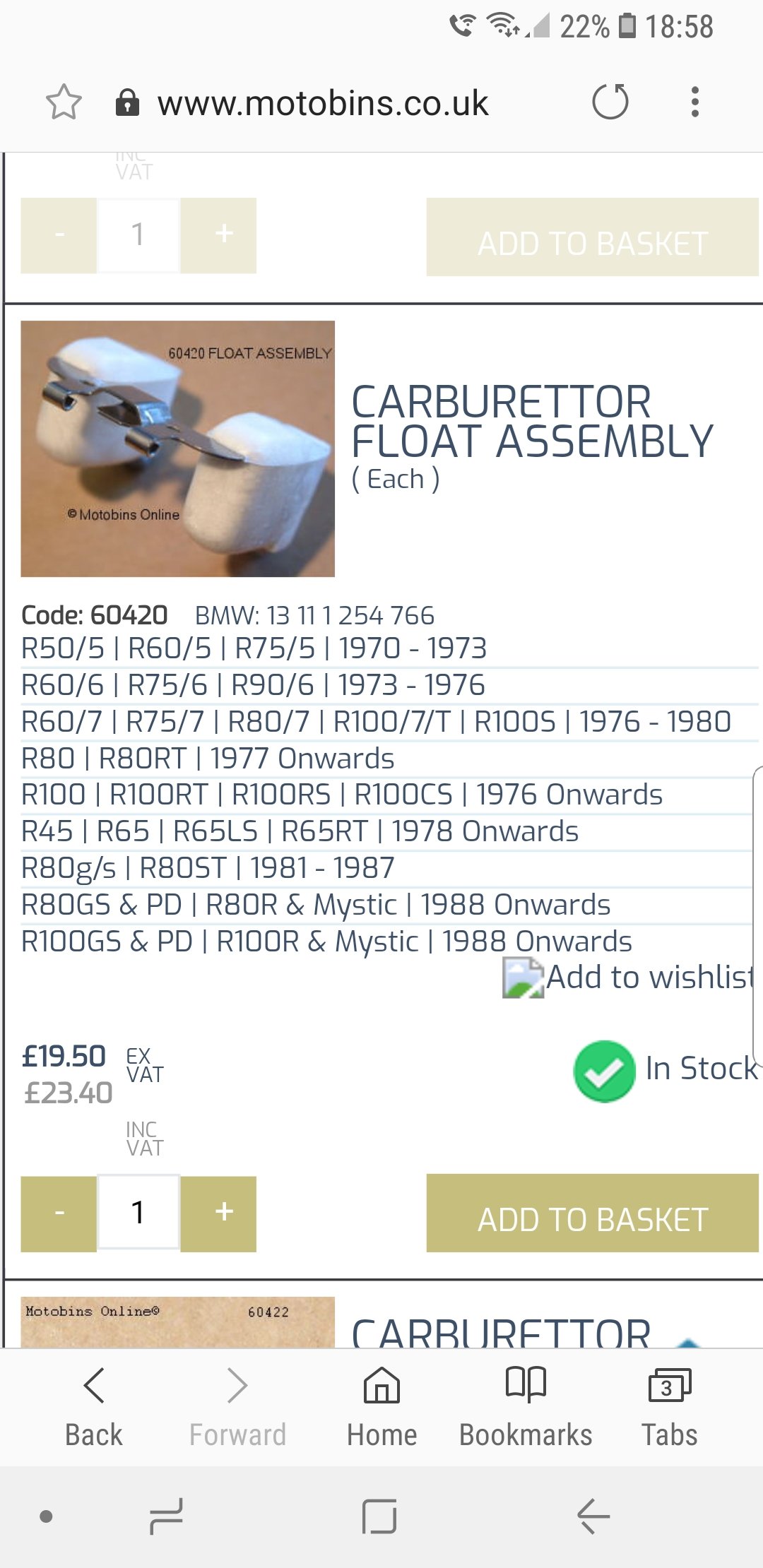

evo boy Posted February 19, 2019 Author Report Share Posted February 19, 2019 11 hours ago, bill black said: I have a BM , motobins and motorworks in the UK will have parts they're where I get all my bits Regards Bill Thanks Bill. I have found a float that looks right. Doesn't anyone know If this is? Quote Link to comment Share on other sites More sharing options...
petorius Posted February 19, 2019 Report Share Posted February 19, 2019 Just bought a float listed for BMW myself.The seller was on ebay but looks as though mine was the last one as they are no longer listing it. Looks the same as you have shown and fits fine in Bultaco Bing 84 or whatever it is. From memory the Bing part number is 300 or 301. Quote Link to comment Share on other sites More sharing options...
