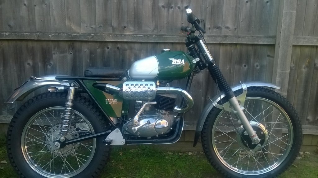

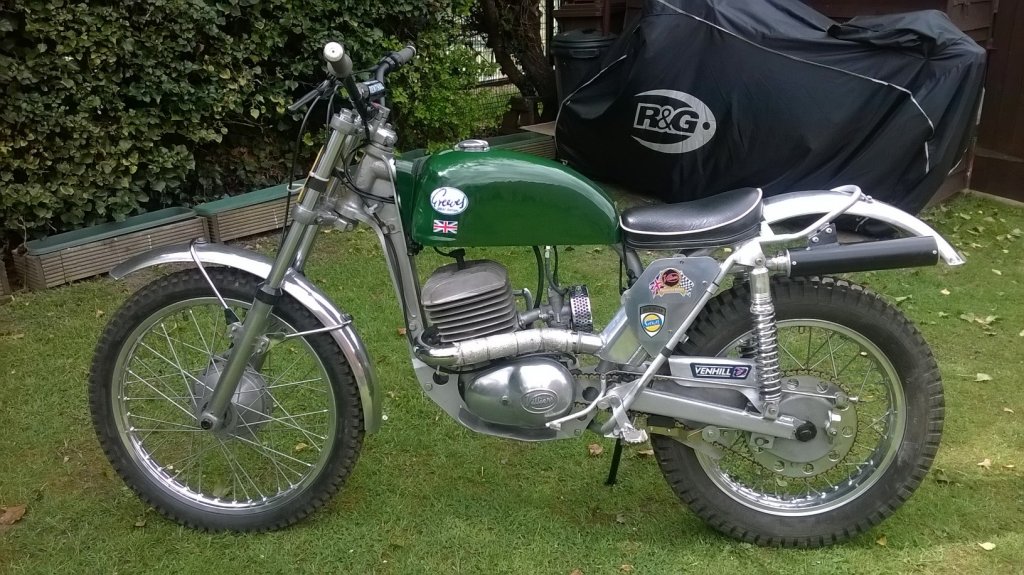

trialsrider46 Posted October 13, 2018 Author Report Share Posted October 13, 2018 16 minutes ago, ruffmutt said: Simple answer to your gearing problems trialsrider46, fit a Villiers engine, lol. Here is the Greeves. Love the thing great to ride. Here is the Bantam ready to ride this weekend Also a great ride. Quote Link to comment Share on other sites More sharing options...
