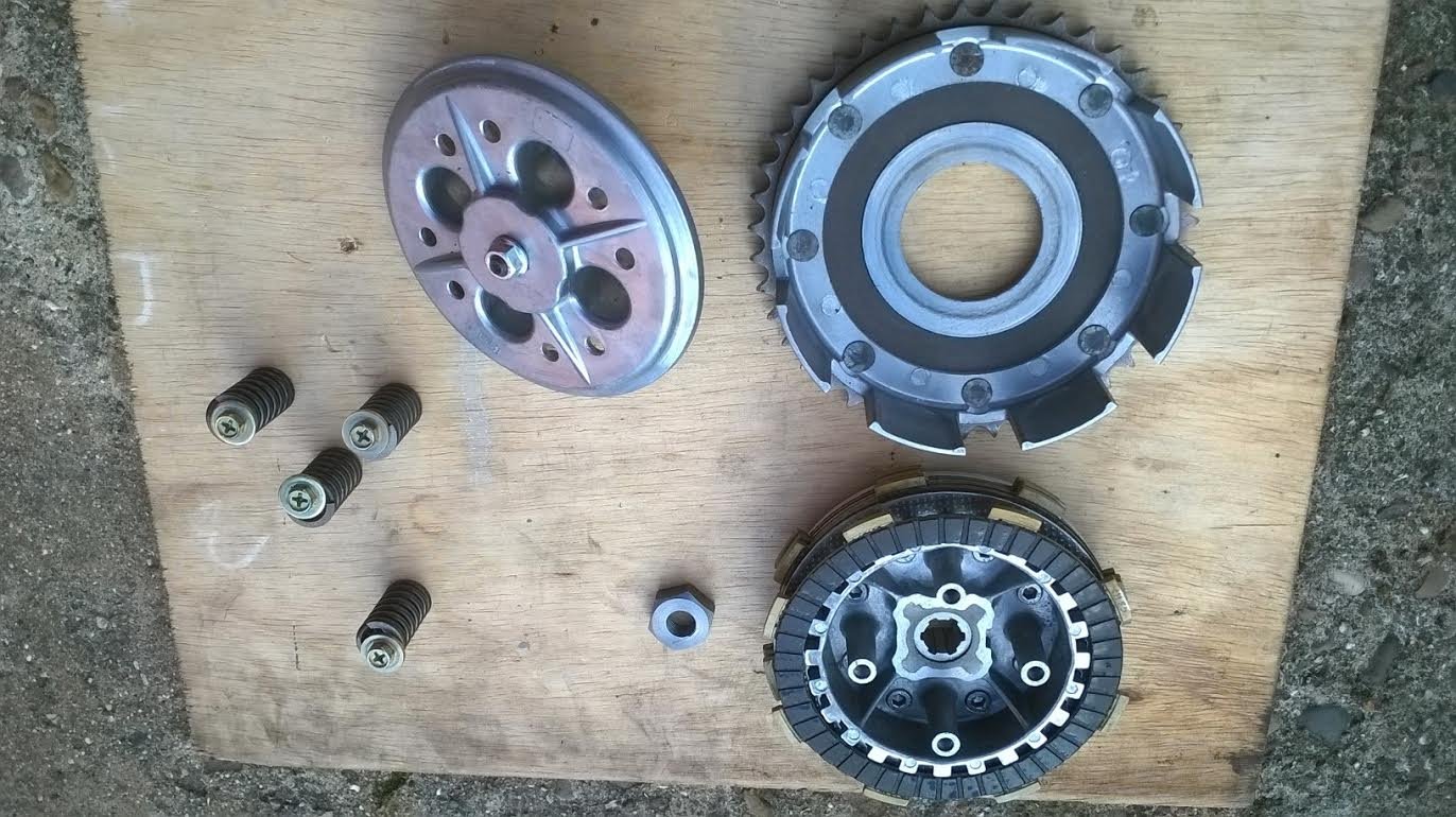

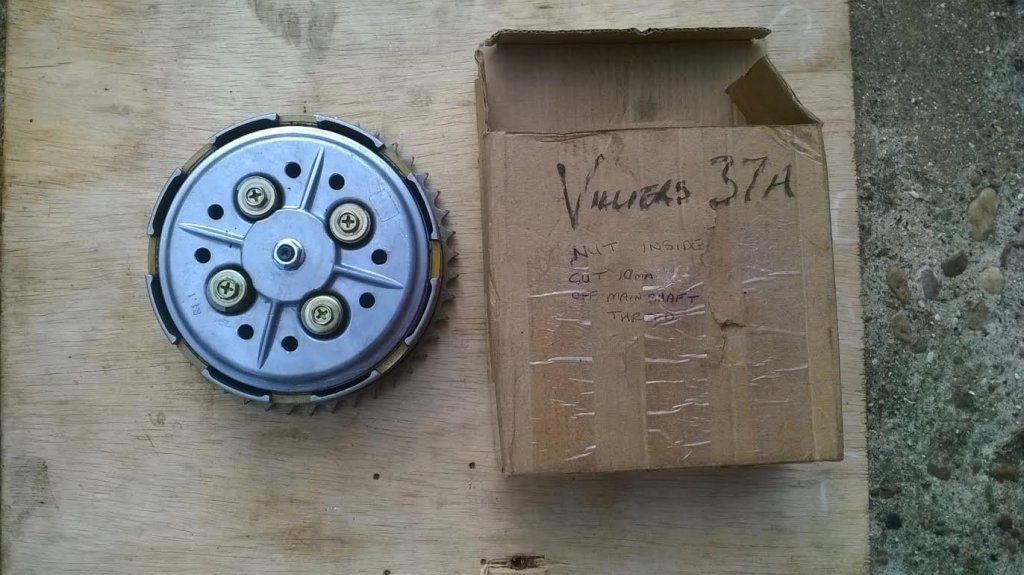

hewson Posted November 20, 2018 Report Share Posted November 20, 2018 Villiers Yamaha conversion clutch , i never got round to fitting it , but you after cut 10mm off main shaft i was told ... Quote Link to comment Share on other sites More sharing options...
old trials fanatic Posted November 20, 2018 Report Share Posted November 20, 2018 Same base unit as used on the Bantam conversion. Think they are from Harry Stanistreet originally. Quote Link to comment Share on other sites More sharing options...
section swept Posted November 23, 2018 Report Share Posted November 23, 2018 On 11/20/2018 at 7:52 PM, old trials fanatic said: Same base unit as used on the Bantam conversion. Think they are from Harry Stanistreet originally. Expand He who built the Arrow engined Drayton? 1 Quote Link to comment Share on other sites More sharing options...
