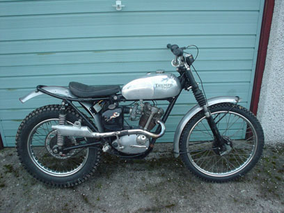

steve+cub Posted January 5, 2006 Report Share Posted January 5, 2006 Hello folks, I have just arrived on this forum, I recently bought a '63 trials cub and I am looking for advice on the best way to get the front forks set up, or should I just replace them with a set of Cerianis I have ? Quote Link to comment Share on other sites More sharing options...
totalshell Posted January 5, 2006 Report Share Posted January 5, 2006 If your forks are halfway original ( on the outside at least) stick wth them heavy weight cub forks are as almost as rare as hens teeth, if the ones on the bike are already 'not of british manufacture' and useless bin them and try the ceranis. difficult to give specific advice without knowing exactly what they are externally and internally the best advice would be to ride them , a fair bit, and decide for your self what more you would want them to do. Quote Link to comment Share on other sites More sharing options...
steve+cub Posted January 5, 2006 Author Report Share Posted January 5, 2006 are these heavyweight forks? Quote Link to comment Share on other sites More sharing options...

triton Posted January 17, 2006 Report Share Posted January 17, 2006 Steve, stick with it,if you have an Amal concentric carb give it an overhaul check the slide is not worn if so fit brass one. Fit some Venhill cables teflon lined, too clutch and carb. Set carb tick over and mixture correct plus ignition timing, it should pull away from tickover smoothly without touching the clutch the engine has good torque for its size. Fit Miller type fork stays they prevent the forks twisting as the stays per your pic may do. See cub pic in Miller catalogue. www.trialsbits.co.uk in Swindon are a good company for pre 65 spares. Ray Small has a business only manufacturing Cub mods, very helpful with loads of info (no web site) tel 023 8069 3183. rgds Triton Quote Link to comment Share on other sites More sharing options...
