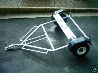

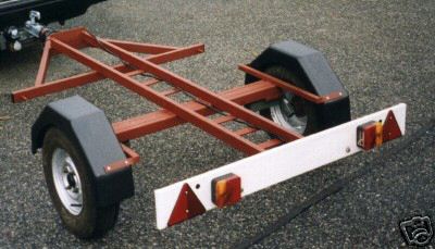

I've considered shortening my trailer but the lads i've spoken to all said when the bike is sumped you lose the suspension for tying down. Therefore the bike tends to bounce on the sump and not ride on the trailer so well. Stand the trailer up on a wheel or hang it on a wall if you can before you shorten it.
Link to comment
thanks for the pics,but they are not the ones i`m looking for.The bike actualy rides on its sump,so if any body has a pic,please post it.The reply about the bike not towing as well because of this,is a point i hadnt considered,but is something i will bear in mind.

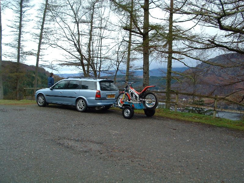

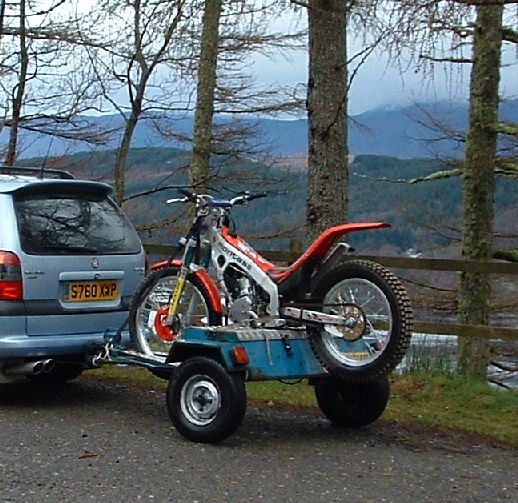

I think this is what you're after, sorry i don't have any close up pics, my brother has the trailer now. I'll attempt to get some close up's,but can't promise anything as the last I heard it was locked in the garage and he's lost the keys!
Anyway the trailer is a simple affair made from box section, chequer plate and mini indispension units. It towed very well (over 100mph-not on public :D roads obvoiusly)and was easy to store.

Not a good idea to travel with bike on the sump, all forces going thro bash plate etc.
The rearmost part of any trailer should have the lights and triangles on it.
You can buy folding trailers.
(BEFORE ANYBODY SAYS THIS IS AN AD, WE DONT SELL FOLDING TRAILERS)

hughesy,that just what i`m looking for.If you could get any close-ups,that would be great. :D:blink:

I've been thinking of something like this for ages. Been thinking of some sort of sprung mounted rubber platform to sump the bike on. Not much spring, just enough to take up slack with straps.
Hughesy's looks as close as I've seen. Looks like storage space as well in that is it???
Also was thinking of square section brackets level with the sump area to drop a lightweight frame in to which provides a number plate BEHIND the bikes.
I reckon with those two trailers shown and a few more ideas thrown in someone could get to the perfect trailer for those of us with limited storage space.
The advantage of Hughesy's for me is the lack of anything behind the wheels. I have bushes that I can lose the whole of the towing hitch in to. All that would be left is the wheels.
Does it lift up on end without destroying the lights. If not, maybe just a couple of small struts to support it.

Yeah, there is storage in the box, enough for all my ****ty gear and petrol. When carrying two bikes I used a light board bungied to the rear wheels of both bikes as the lights on the trailer were obscured.
The trailer stood up on it's a*** end fine without any supports, though this was more to do with luck than judgement.
