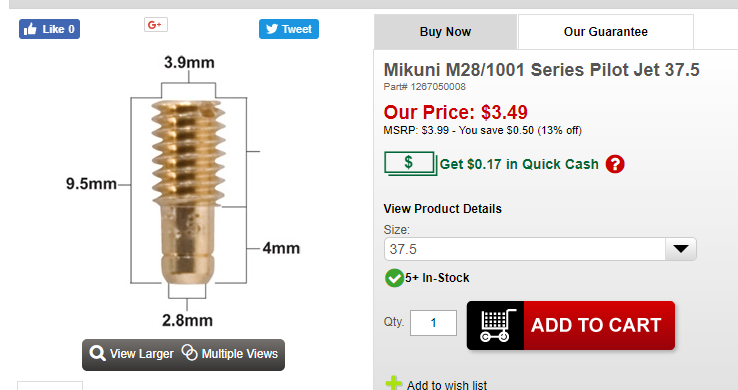

RD4ME Posted November 22, 2018 Author Report Share Posted November 22, 2018 OK - great - I'm going to order a #37.5 and a #40 jet. I've removed my stock #35 from my Mikuni VM26SS and have measured it. Pretty certain it's the M28/1001 series - but hoping someone might be able to confirm? Quote Link to comment Share on other sites More sharing options...

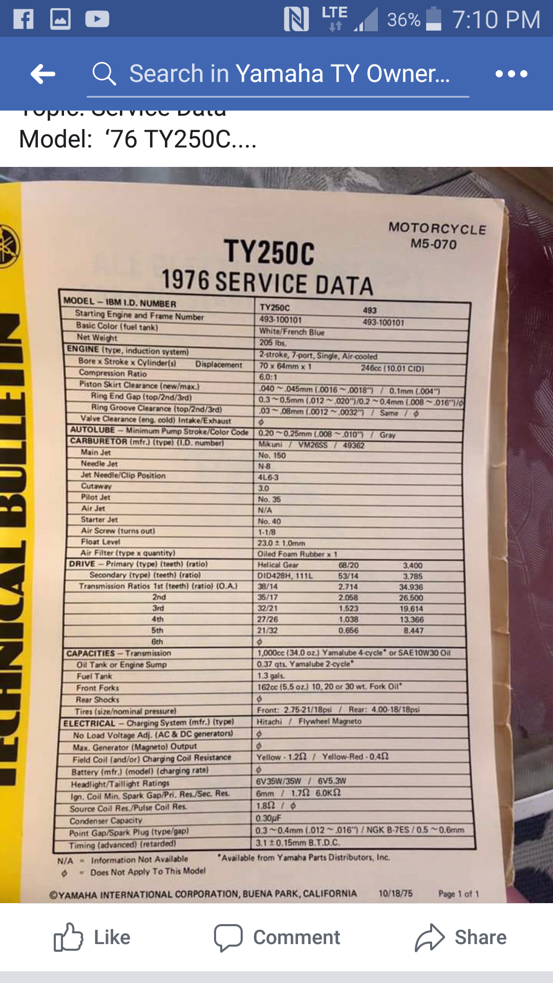

Junglejeff Posted March 19, 2019 Report Share Posted March 19, 2019 It's for c model but specs should be the same.Hope it helps working on your bike. Quote Link to comment Share on other sites More sharing options...
