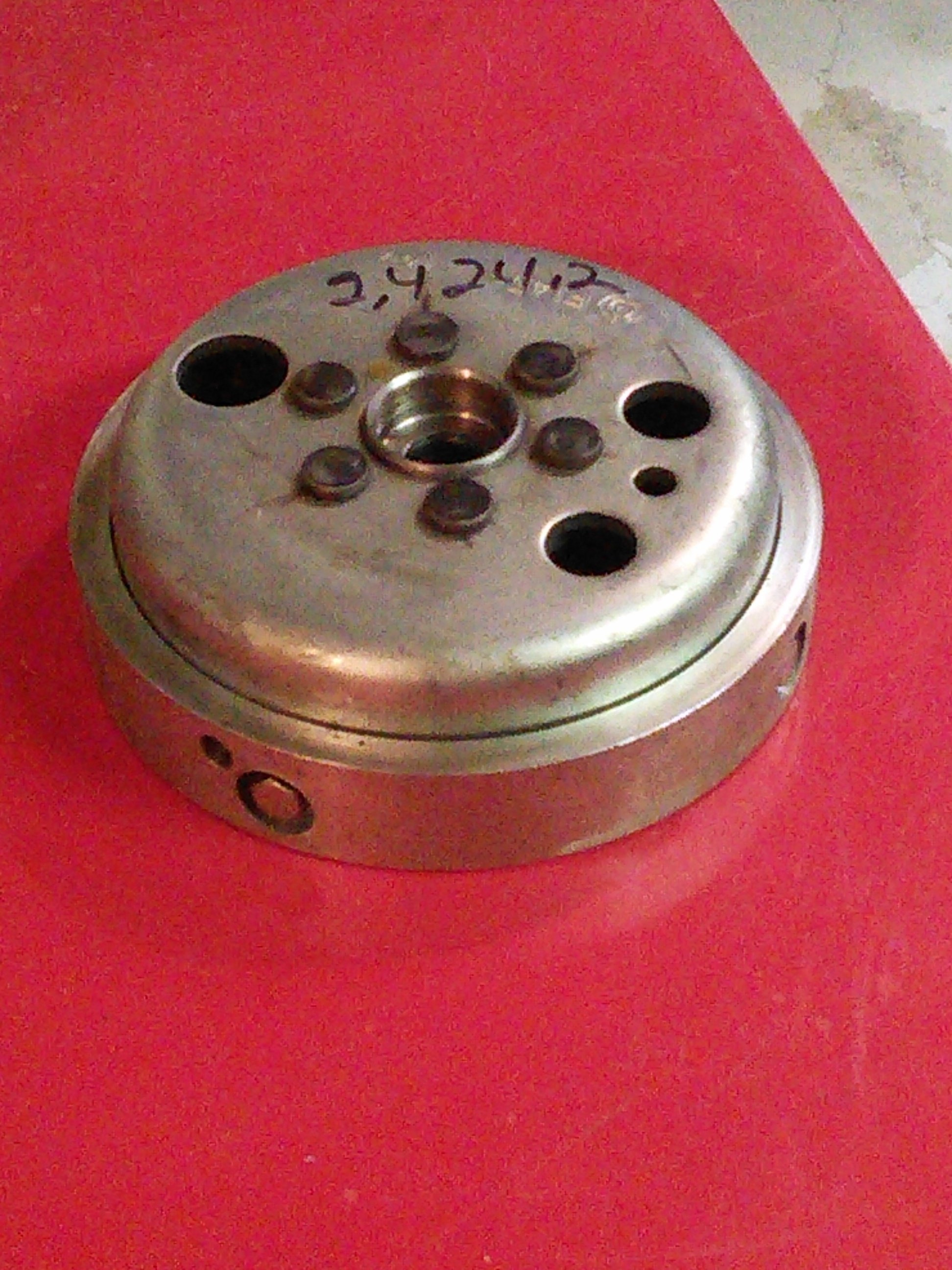

guy53 Posted November 21, 2019 Report Share Posted November 21, 2019 Here is a picture of a B model ( here in Canada ) Guy Quote Link to comment Share on other sites More sharing options...

feetupfun Posted November 23, 2019 Report Share Posted November 23, 2019 (edited) Jon you can fit in a much larger weight band than the one in Guy's photo. I'm working on a 360cc TY250 motor at the moment and it has a weight band that is at least twice as heavy as the one in Guy's photo. People tell me that the weight band on this 360cc motor looks like what was fitted to the 320 Majesty motor. The owner of the 360cc TY250 I'm working on told me that the huge weight band flywheel was fitted to his Yamaha factory supported TY250 in 1975 at the same time as the Yamaha fuel injection was fitted, to tame the motor down. The super-heavy flywheel was then fitted to this 1977 TY250 motor when it was converted to 360cc (in 1977). I'll post up a photo of the flywheel soon. Edited November 23, 2019 by feetupfun 3 Quote Link to comment Share on other sites More sharing options...
