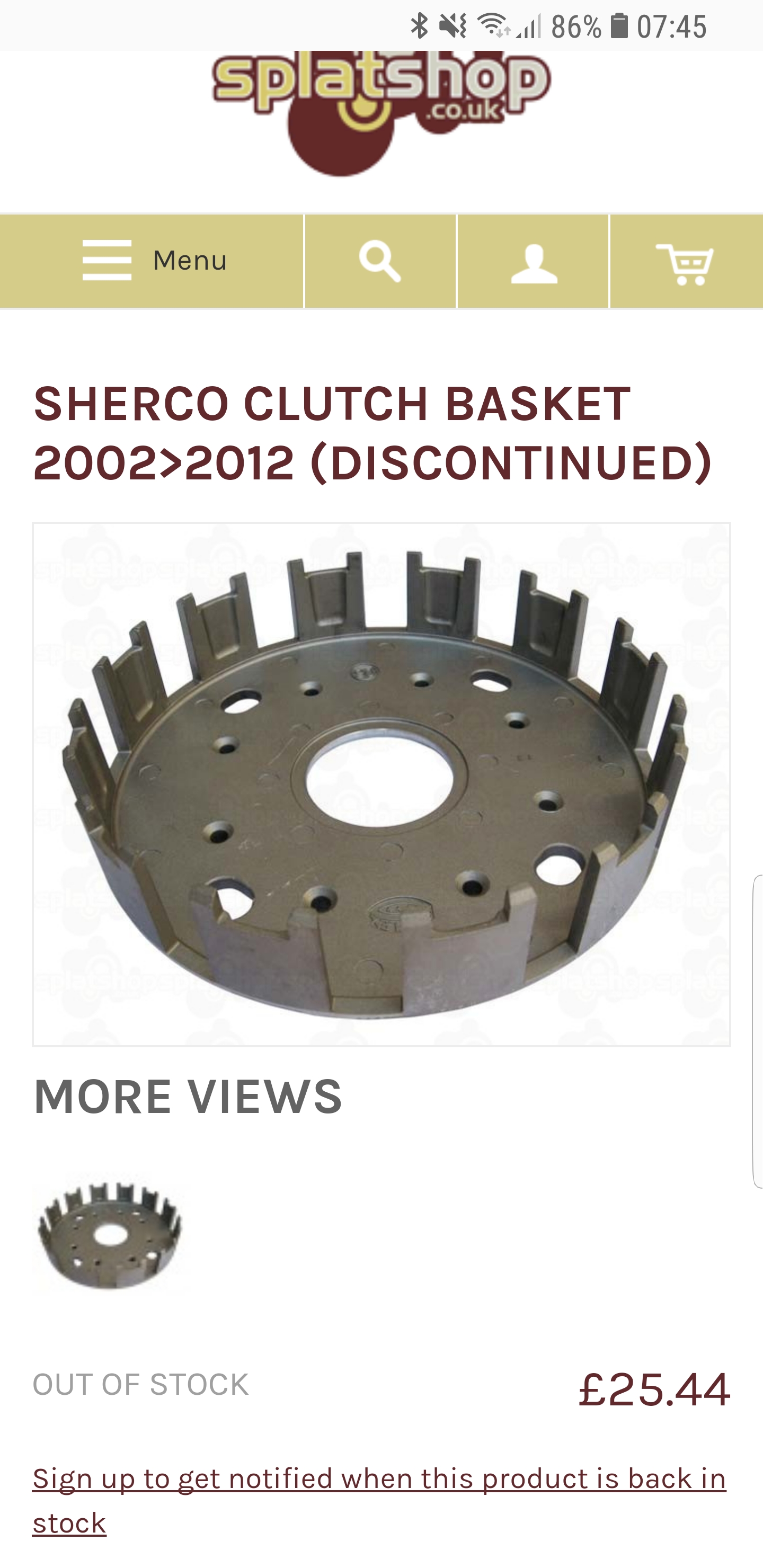

Tom103 Posted November 3, 2018 Report Share Posted November 3, 2018 I am looking to replace the clutch on my 2007 290 as it's sticking/dragging quite a bit. The plates seem to have a bit of sideways movement sitting the basket. Would this be from someone filing the grooves out of the basket previously? There are some grooves in the basket now so would like to replace it as I put new plates in. Only trouble is I can't seem to source 1. Everywhere seems to be out of stock and it's labelled as discontinued on splat shop. Any ideas where I could source 1? Thanks Quote Link to comment Share on other sites More sharing options...
pauls320 Posted November 3, 2018 Report Share Posted November 3, 2018 CSP (costa special parts) makes a beautiful but a bit pricey replacement. Splat sells them on the site. I would call or message them to see if the 2013 + complete basket gear assembly is the oem replacement that cross references up for your application....scorpa version used this too. Please post back afterwards and let us know what you find out. Quote Link to comment Share on other sites More sharing options...
