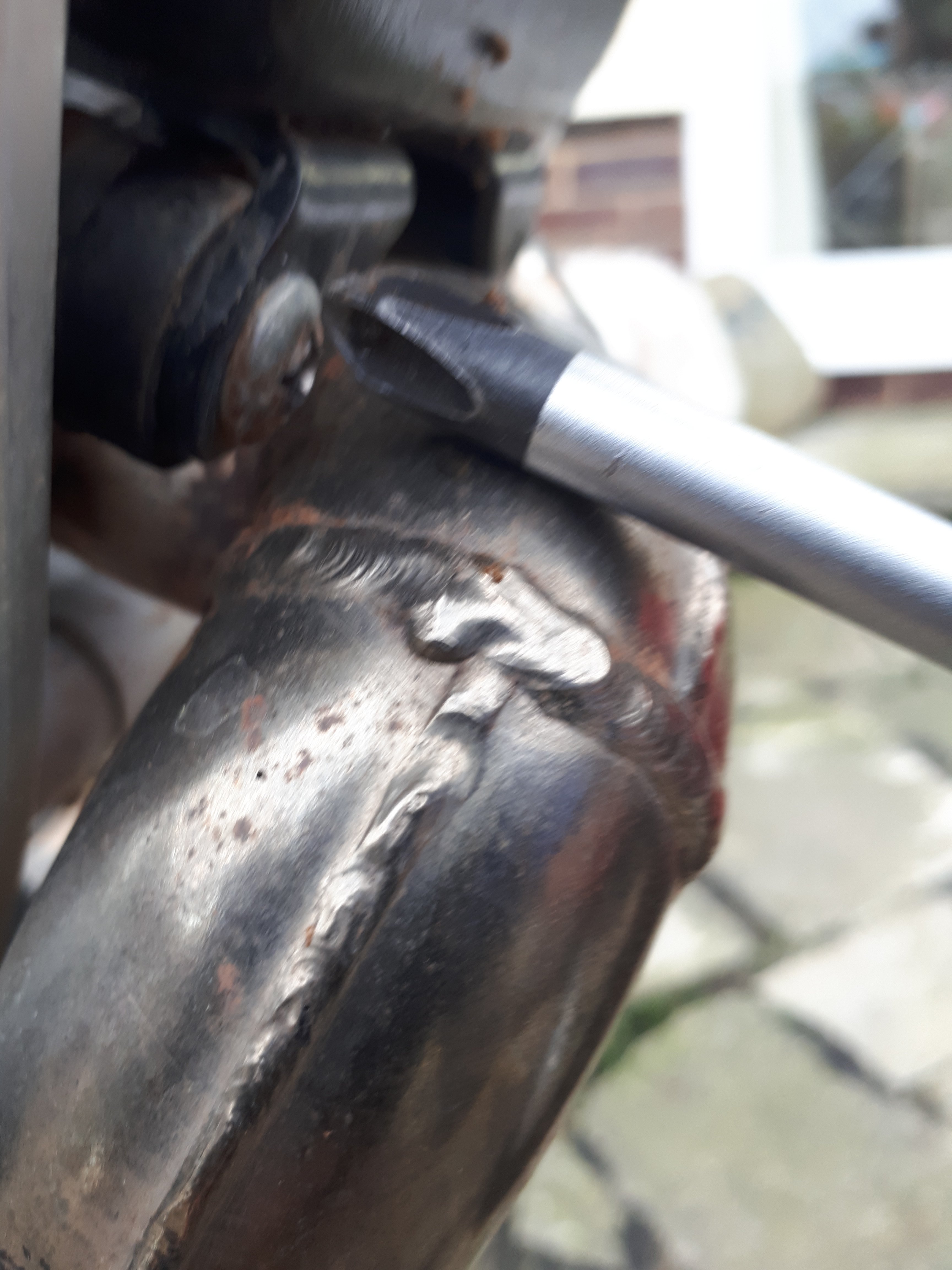

Bigusdickus Posted November 25, 2018 Author Report Share Posted November 25, 2018 (edited) Ok I have given up.I can't get at the wiring from above. I think that's ok I will tip the rad forward, then this little design gem stopped me in my tracks ? is it normal to have to remove the exhaust to get the rad out. Any advice will be much appreciated. Rich. Edited November 25, 2018 by Bigusdickus Quote Link to comment Share on other sites More sharing options...
Bigusdickus Posted November 25, 2018 Author Report Share Posted November 25, 2018 I appreciate what you are saying the problem is how do you diagnos a fault on an engine that's in bits ? I am not a novice I have worked on bikes all my life. The way I see it have been sold a bike with a fault am prepared to try to sort it out to a point. When it's spread out on the floor just so you can get at the wiring it's very frustrating. Rich. Quote Link to comment Share on other sites More sharing options...
