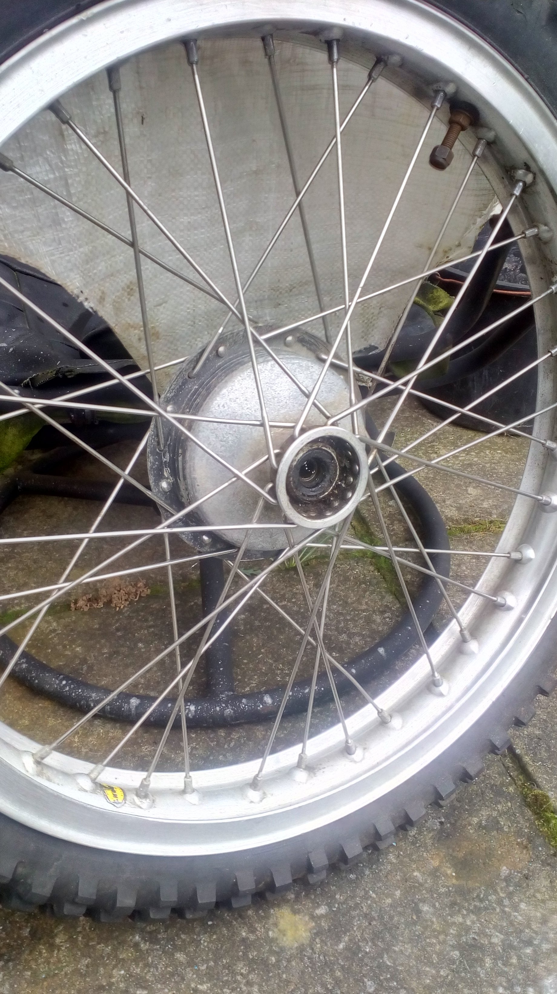

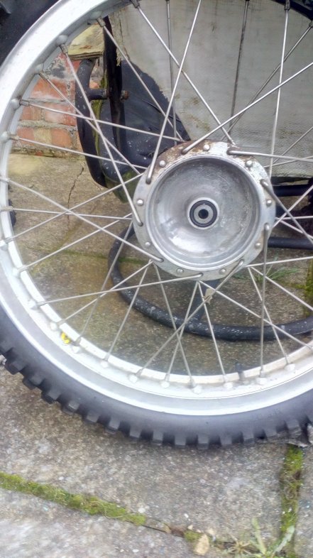

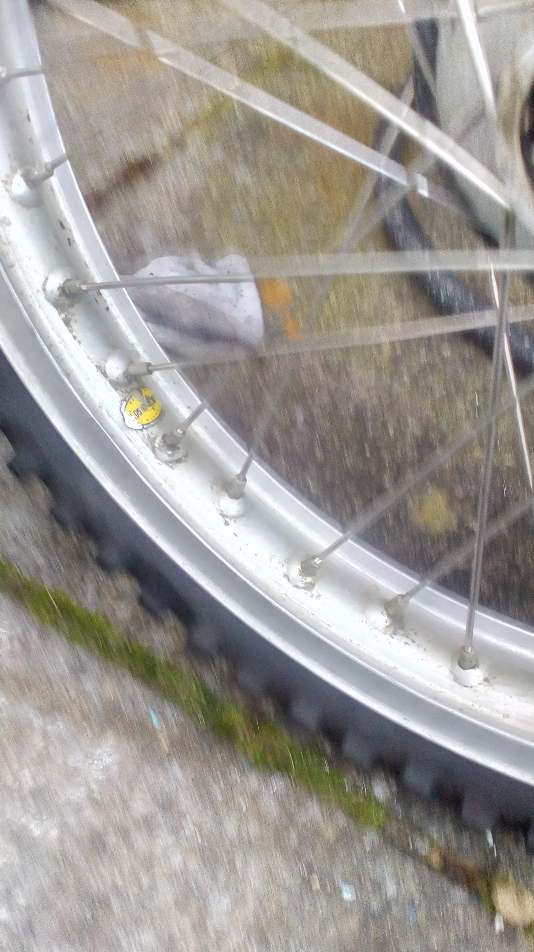

Old man Posted November 24, 2018 Report Share Posted November 24, 2018 Hi could anyone help what bike this is from. On rim Me 1947 and brake arm screw has Bultaco m80.There is a akront sticker but no writing on rim. Quote Link to comment Share on other sites More sharing options...
lorenzo Posted November 24, 2018 Report Share Posted November 24, 2018 Looks like Bultaco, but model ?, can't be sure.... Need to see other side of hub. Quote Link to comment Share on other sites More sharing options...

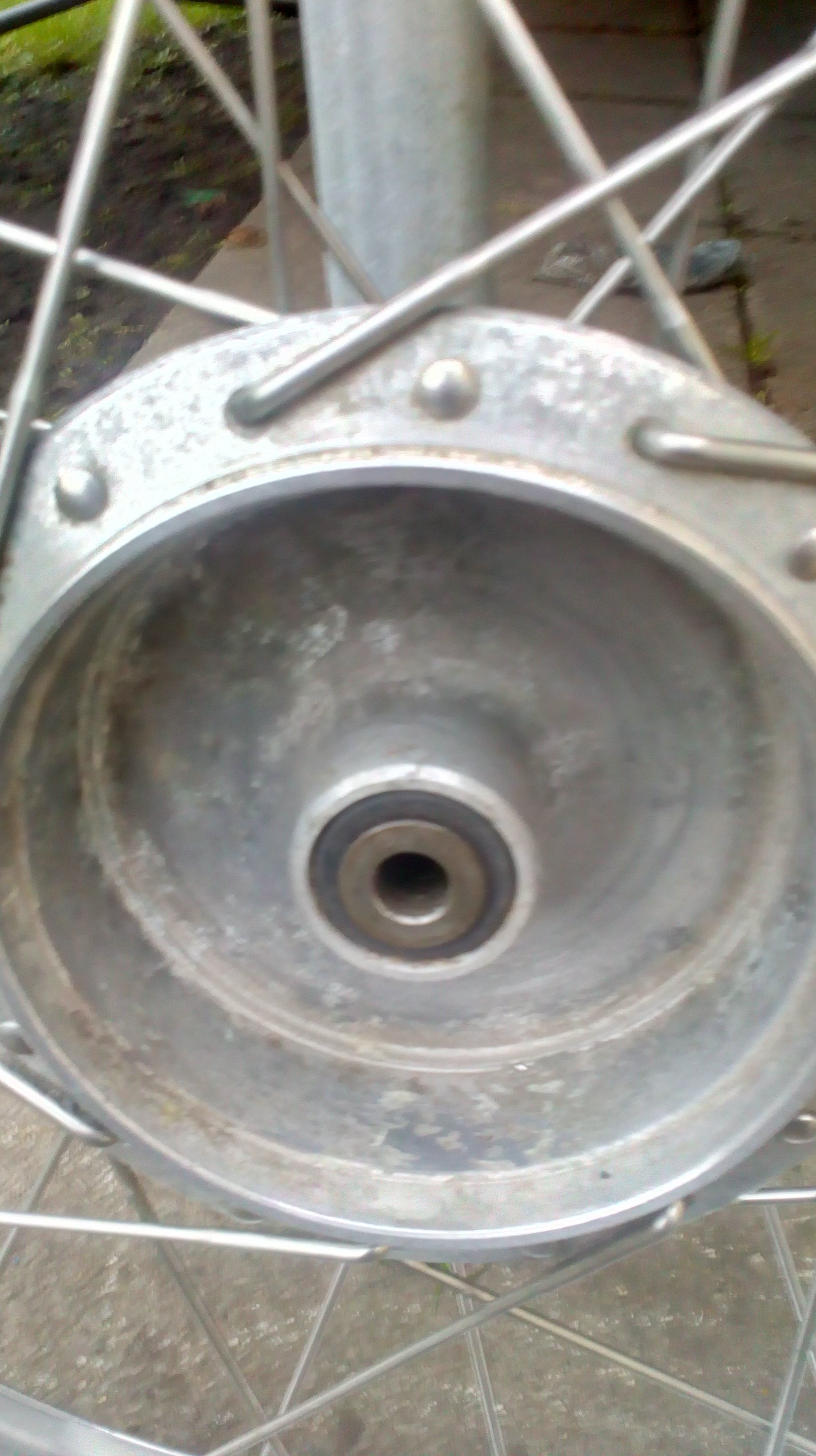

feetupfun Posted November 24, 2018 Report Share Posted November 24, 2018 and what is the brake drum ID? Quote Link to comment Share on other sites More sharing options...

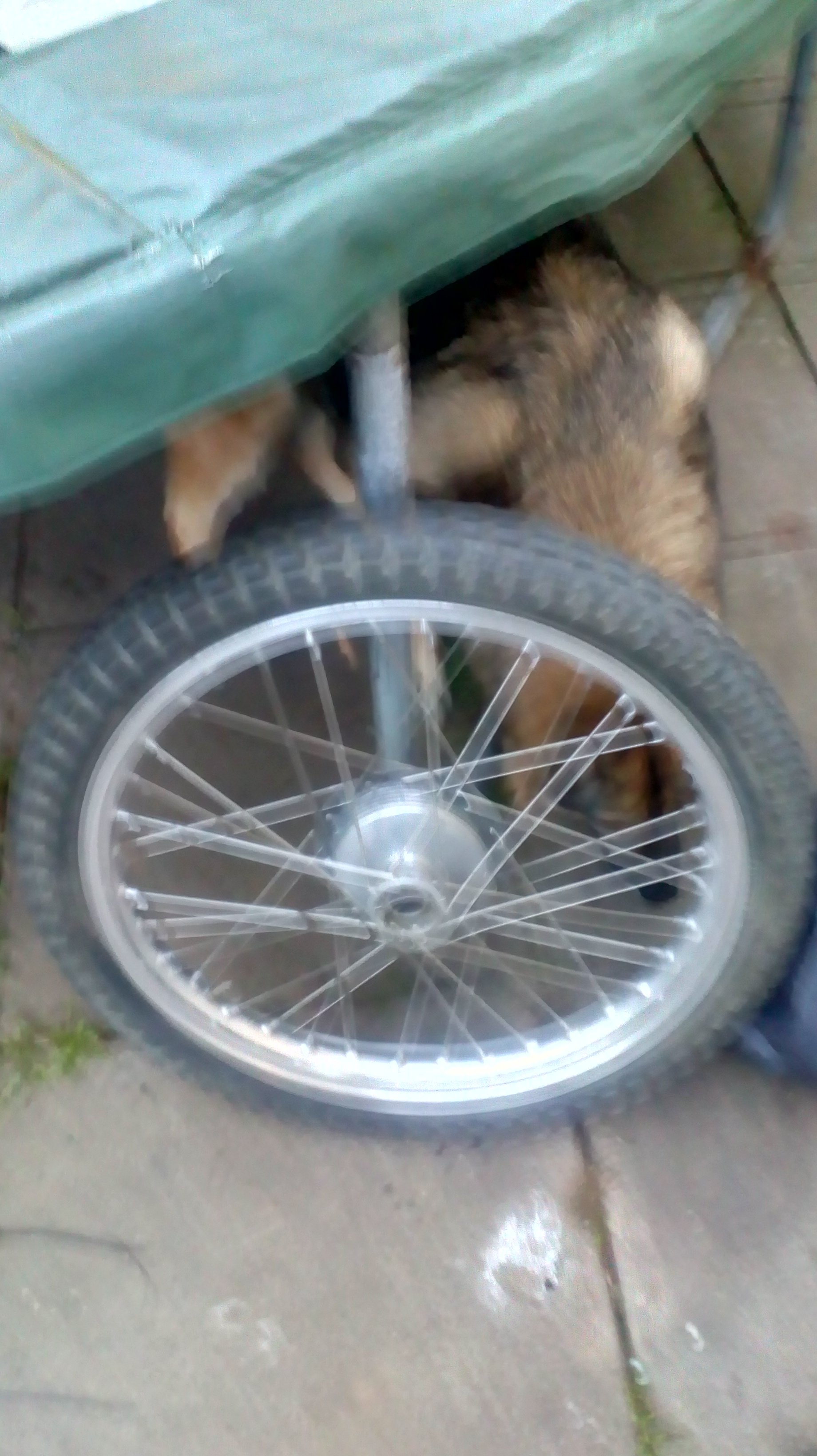

Old man Posted November 24, 2018 Author Report Share Posted November 24, 2018 Hi don't see any marking the other wheels don't have the rims up turned and have dome in middle.Has Motorcross on tyre but that means nothing as tyres change. Quote Link to comment Share on other sites More sharing options...
greychapel Posted November 24, 2018 Report Share Posted November 24, 2018 looks exactly like the hub of my 76 m159, not sure when they introduced that style hub Quote Link to comment Share on other sites More sharing options...
woody Posted November 24, 2018 Report Share Posted November 24, 2018 That style hub was fitted to Sherpas in 1972 on the M91/92, but it had a normal rim, that flanged type was last fitted to the previous model 80 with full width hub (on the front) Pursang and Alpina also have that style hub but slightly bigger in diameter (on Pursang at least) Sherpa diameter is 125mm so if it is bigger it is Pursang or maybe Alpinaa 1 Quote Link to comment Share on other sites More sharing options...

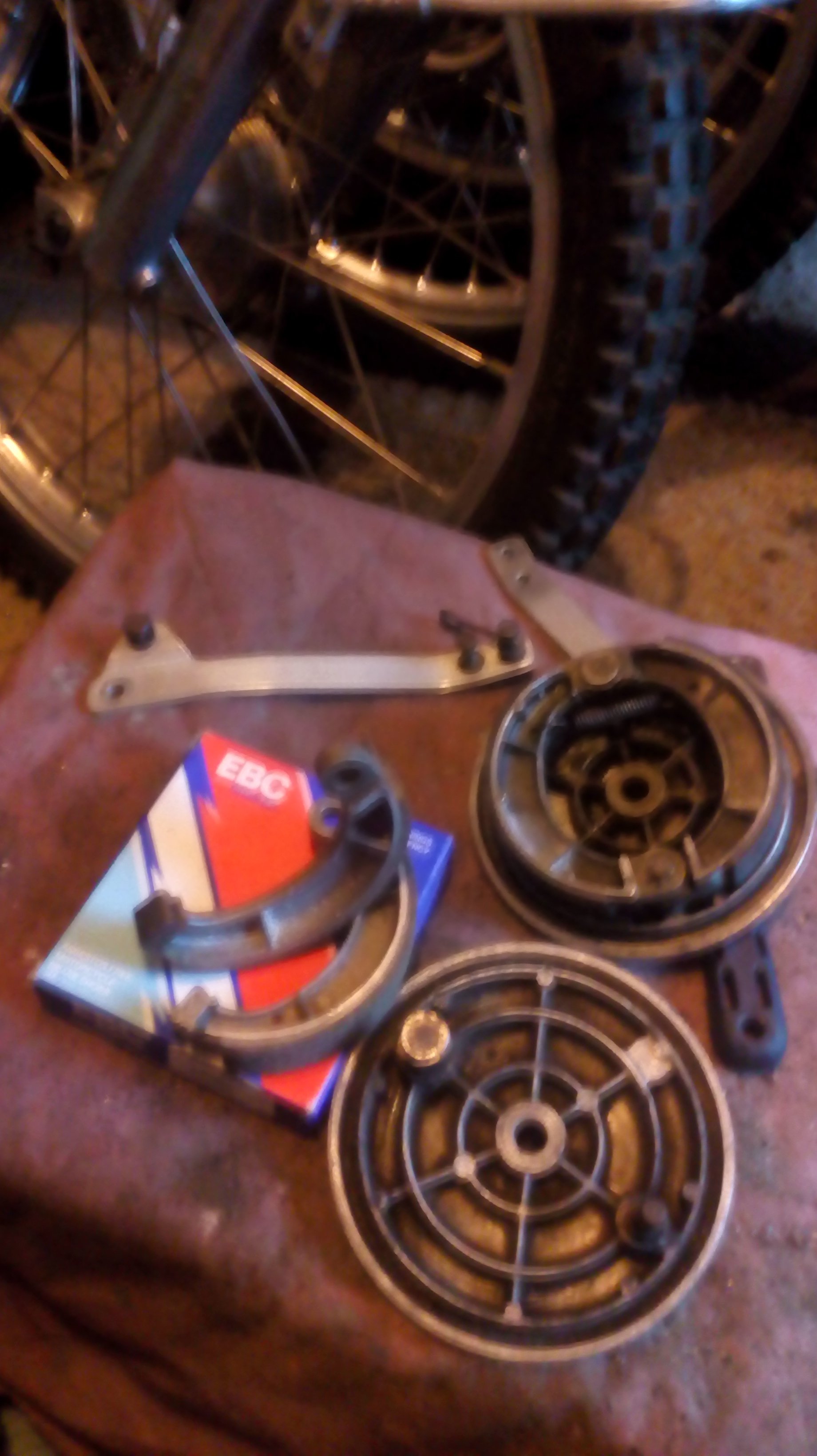

section swept Posted November 24, 2018 Report Share Posted November 24, 2018 (edited) My M80 has a lot of reinforcing webbing cast into the hub, yours doesn’t. Everything in your photos points to early Bultaco...late 60’s to early 70’s. Brake shoe spring doesn’t look right (I could be wrong). Brake drum looks as though there is no cast iron lining, my M80 has this so your wheel may be approximately 74 on and possibly a Pursang component, I think the wheels are all the same but the wheel spindles may differ. Edited November 24, 2018 by section swept Quote Link to comment Share on other sites More sharing options...
section swept Posted November 24, 2018 Report Share Posted November 24, 2018 (edited) 1 hour ago, woody said: That style hub was fitted to Sherpas in 1972 on the M91/92, but it had a normal rim, that flanged type was last fitted to the previous model 80 with full width hub (on the front) Pursang and Alpina also have that style hub but slightly bigger in diameter (on Pursang at least) Sherpa diameter is 125mm so if it is bigger it is Pursang or maybe Alpinaa My M80 is a1972 and has the full width style hub, except the drum is cast iron lined and the bearing housing is heavily webbed. It also has Arkront rims. Think the full width hubs were pre 73/4 fitting. Reckon your close at Pursang or Alpina Edited November 24, 2018 by section swept Quote Link to comment Share on other sites More sharing options...

Old man Posted November 24, 2018 Author Report Share Posted November 24, 2018 Thankyou to all just did not look right to other wheels with those rims pointing up.Found akront stamped in rim hidden under dirt but nothing else Quote Link to comment Share on other sites More sharing options...
woody Posted November 24, 2018 Report Share Posted November 24, 2018 The rim is normal Akront fitted to most bikes in 60s to about 1972 when Bultaco, as well as Montesa and Ossa all swapped to flangeless rims. On Sherpas, that style hub used a flangless rim but it's 40 odd years old and in that time could have been fitted with a replacement rim. A MK5 (maybe MK4 as well) Pursang used a flanged rim with that type of hub. You will have to measure the inside diameter of the hub. As mentioned before 125mm is Sherpa, possibly early Alpina also. Pursang will be 140mm I think from memory. They look the same in appearance. You're going to have to know which for the brake shoes your going to need as you can't use those... Quote Link to comment Share on other sites More sharing options...
lorenzo Posted November 24, 2018 Report Share Posted November 24, 2018 (edited) If the brake drum is 125mm. diameter, it's a Pursang wheel. (Pursang pre-mk. 9 - this used 140mm. hub/brake). Further identification points are the extra flange on the l/h. side of the hub, and yellow Akront label. This is supposedly a stronger wheel overall than a Sherpa item. First Sherpas with conical hub were machined and polished. Later Sherpas were less "finished", retaining the extra flange and were fully painted. Spokes also changed from stainless butted with alloy nipples to steel during various iterations. As stated by woody, flanged type rim was used to 1972, flangeless thereafter. Mod. 80 Sherpa and Mod. 85 Alpina both had full-width type hub of 125mm. and flanged rim. It'll certainly need brake shoes.......what state is the brake drum in ? . Edited November 24, 2018 by lorenzo additional info. Quote Link to comment Share on other sites More sharing options...
Old man Posted November 25, 2018 Author Report Share Posted November 25, 2018 The brake shoes went in bin after took photos yesterday as they wear down to metal.The hub is bad this was a spare wheel the original is missing 2 spokes so need to get some.I bought some shoes awhile ago as one shoe is broken and need replacing. Quote Link to comment Share on other sites More sharing options...
bult360 Posted November 26, 2018 Report Share Posted November 26, 2018 On 11/24/2018 at 10:28 PM, lorenzo said: If the brake drum is 125mm. diameter, it's a Pursang wheel. (Pursang pre-mk. 9 - this used 140mm. hub/brake). Further identification points are the extra flange on the l/h. side of the hub, and yellow Akront label. This is supposedly a stronger wheel overall than a Sherpa item. First Sherpas with conical hub were machined and polished. Later Sherpas were less "finished", retaining the extra flange and were fully painted. Spokes also changed from stainless butted with alloy nipples to steel during various iterations. As stated by woody, flanged type rim was used to 1972, flangeless thereafter. Mod. 80 Sherpa and Mod. 85 Alpina both had full-width type hub of 125mm. and flanged rim. It'll certainly need brake shoes.......what state is the brake drum in ? . It was only the 370 s that had the bigger brake , the 250s kept the small one till end of production , The first pursang to use the non flanged rim was the mk 7 and im pretty sure the Sherpa had the flanged rims up to the model 124/125.If its a motocross wheel it can only be a mk6 pursing as the 5 had a same style hub but in steel painted black Quote Link to comment Share on other sites More sharing options...
b40rt Posted November 26, 2018 Report Share Posted November 26, 2018 Get the brake shoes back out the bin, various companies can re-line them with oversize brake lining. Useful if the drum is worn. 2 1 Quote Link to comment Share on other sites More sharing options...
