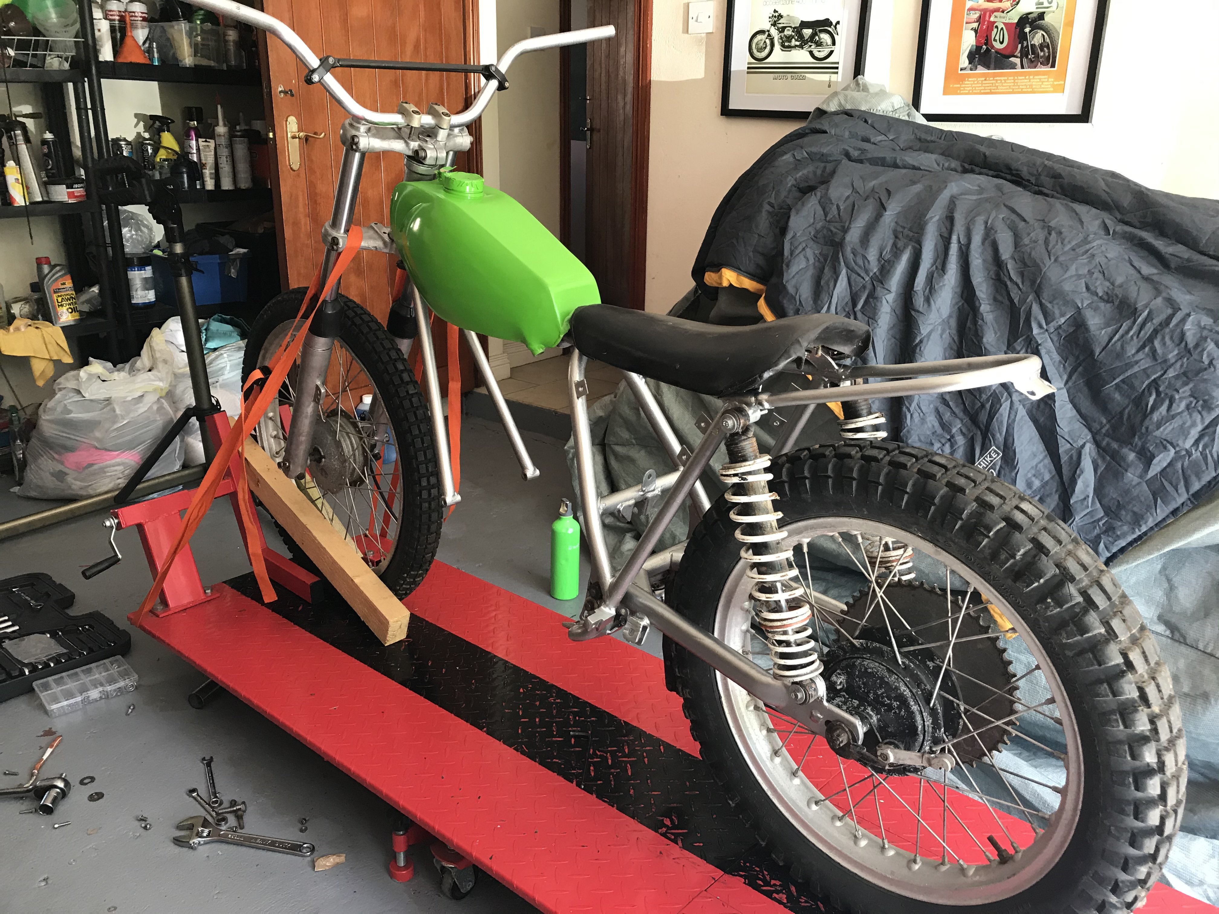

So far I’ve cleaned and painted what I can, I’m not sure the silver and green  I’ve managed to get is quite right both are a bit too bright . I’m not too fussed on that, I just want a working bike that I can ride.  I’ve got a rolling chassis , i need some parts ( see below ) but in general the build is fine apart from the engine.
I’m up for learning, and I’ve got some manuals but I think this engine has had a rough life and some unsympathetic  previous owners. Because of that I think this job is going to be a bit trickier.

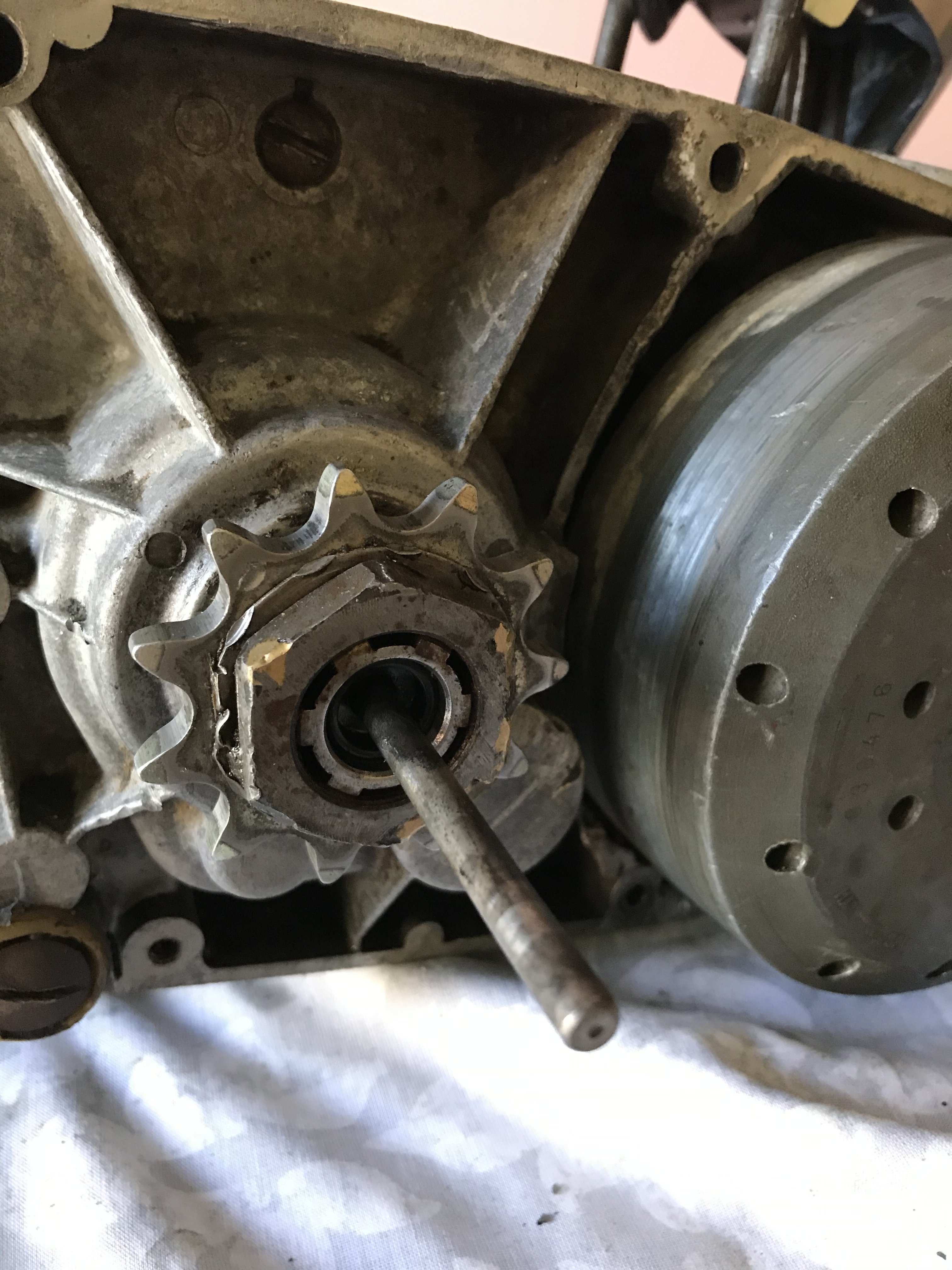

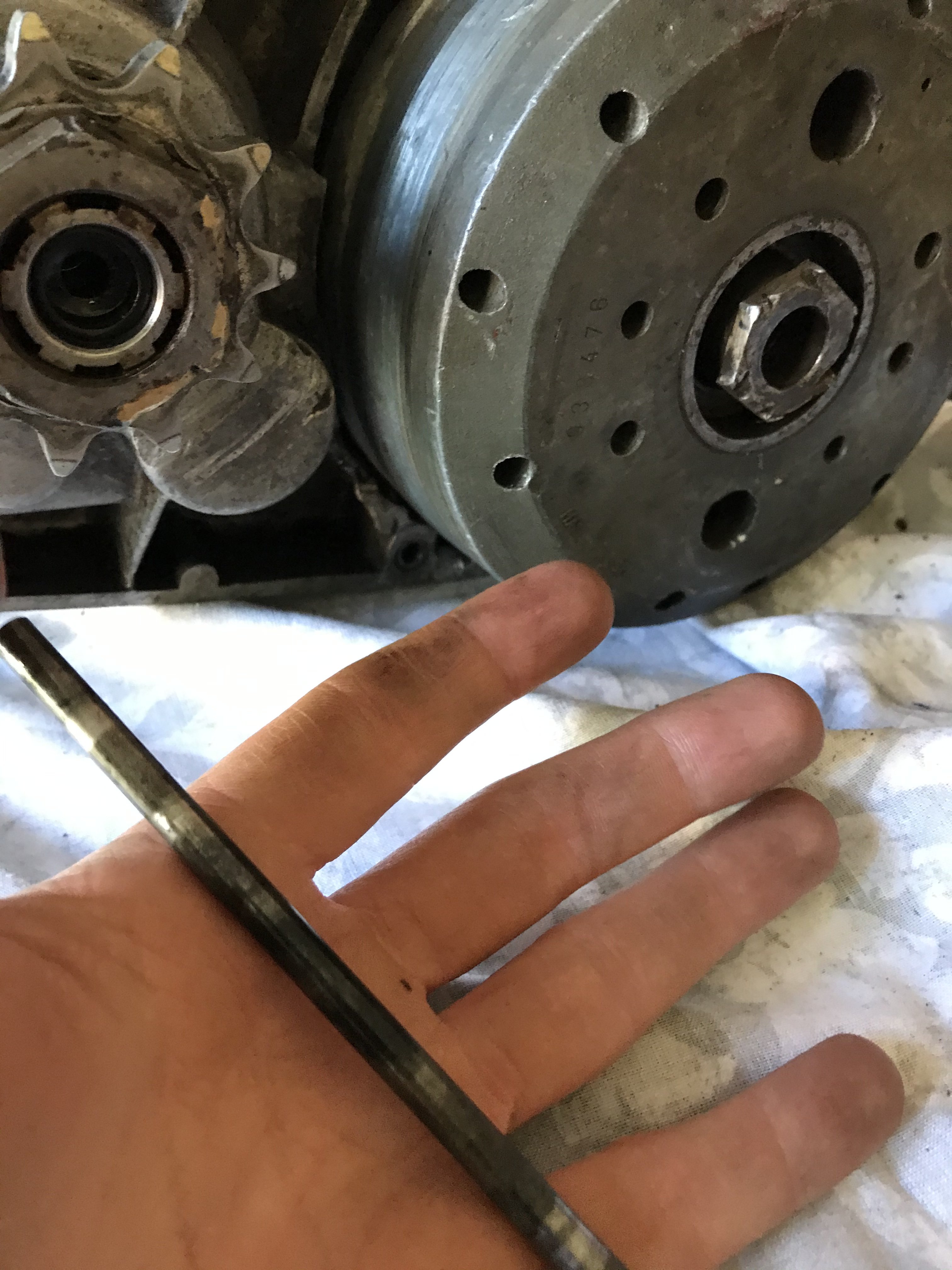

One thing that I’ve noticed is that there seems something amiss with the clutch.  As you all know, the clutch cable attaches onto a lever which turns a vertical shaft and it in turn acts on a horizontal shaft that runs through the sprocket . This little rod or shaft just shoots in and out with zero resistance. It goes in so far that you can’t see it, but if you turn the engine on it’s side it falls right out again. So as far as I can see there’s no way that can transfer any pressure through to the other side of the engine.any ideas? I’m assuming that there’s something not right internally and so the engine will require to be split to investigate. I will try to attach pictures of the shaft I’m referring to

The rod you're holding is a pushrod. There should be two pushrods in the Ossa with a ball bearing inbetween them. If you only have one that's the problem, it's not long enough to engage with the clutch on the other side of the engine. There should also be a seal in the end of the final drive shaft that the pushrod passes through, it might be there but I can't tell from the picture but if the pushrod just falls out it's either not there or so worn it needs replacing as the friction from the seal should stop the pushrod just falling out

Thank you Woody,
I’ve had a look at the exploded engine diagram and can see that there should be another pushrod on the other side.  It has the same part number so at least I know that what I need is identical to what I already have.
