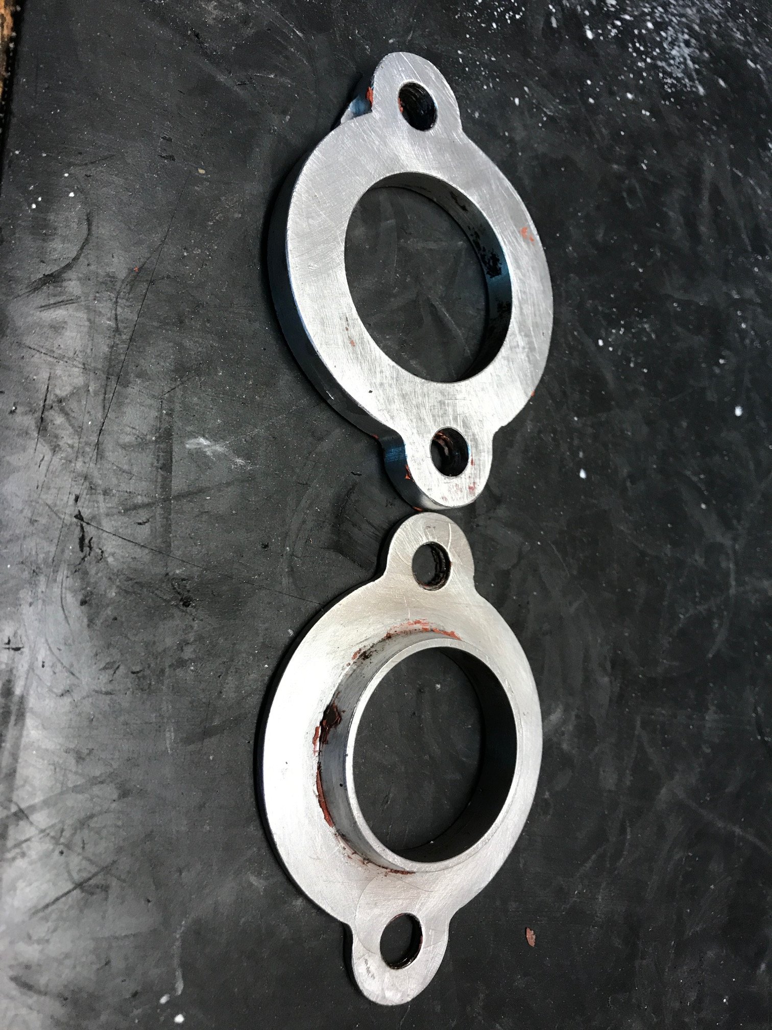

Sir Real Ed Posted December 20, 2018 Report Share Posted December 20, 2018 (edited) On 12/19/2018 at 4:41 PM, mcman56 said: I spent quite a bit of time experimenting with a 250 Rev3. (It is surprising what some people will do for entertainment.) - Instead of welding a washer in the inlet of the exhaust pipe, I made a spacer with smaller ID that fit between cylinder and pipe so it was removable. The pipe still cleared the fender but did not slide into the muffler quite so far. It softened the power quite a bit but also made it bog proof. You could use large amounts of throttle at low RPM and it would just chug along. If you are interested I may still have this spacer. I don't remember if I changed jetting. - In the US, Betas come without flywheel weights so adding one would soften power. - I made a carb spacer with small boost bottle. If you run the Mikuni manifold with a Keihin carb, you pick up an extra 1/2" to insert a spacer with port for boost bottle. IIRC this produced the same bog proof low end chug power but did not soften the overall power much. - A 26 mm OKO carb ran the same as a 28 mm Keihin but the response was just a tiny bit softer. Expand mcman56, do you remember the ID, OD, and thickness of the spacer you made? Quote Expand Edited December 20, 2018 by Sir Real Ed Quote Link to comment Share on other sites More sharing options...
mcman56 Posted December 20, 2018 Report Share Posted December 20, 2018 I just looked it up. The outside of the spacer was shaped just like the exhaust flange with the two holes. The ID was 1.42" but I don't remember where that came from, probably some percent of the unrestricted area. It was 1/4" thick aluminum. I'll look for the actual part. Quote Link to comment Share on other sites More sharing options...
mcman56 Posted December 21, 2018 Report Share Posted December 21, 2018 I pulled out the parts. The smallest was thin and 1.3" ID. That must be the one I remember. The tapered part fits in the pipe. See picture. Send me a PM with your address, I can should be able to mail it. I have no use for it now. 1 Quote Link to comment Share on other sites More sharing options...
