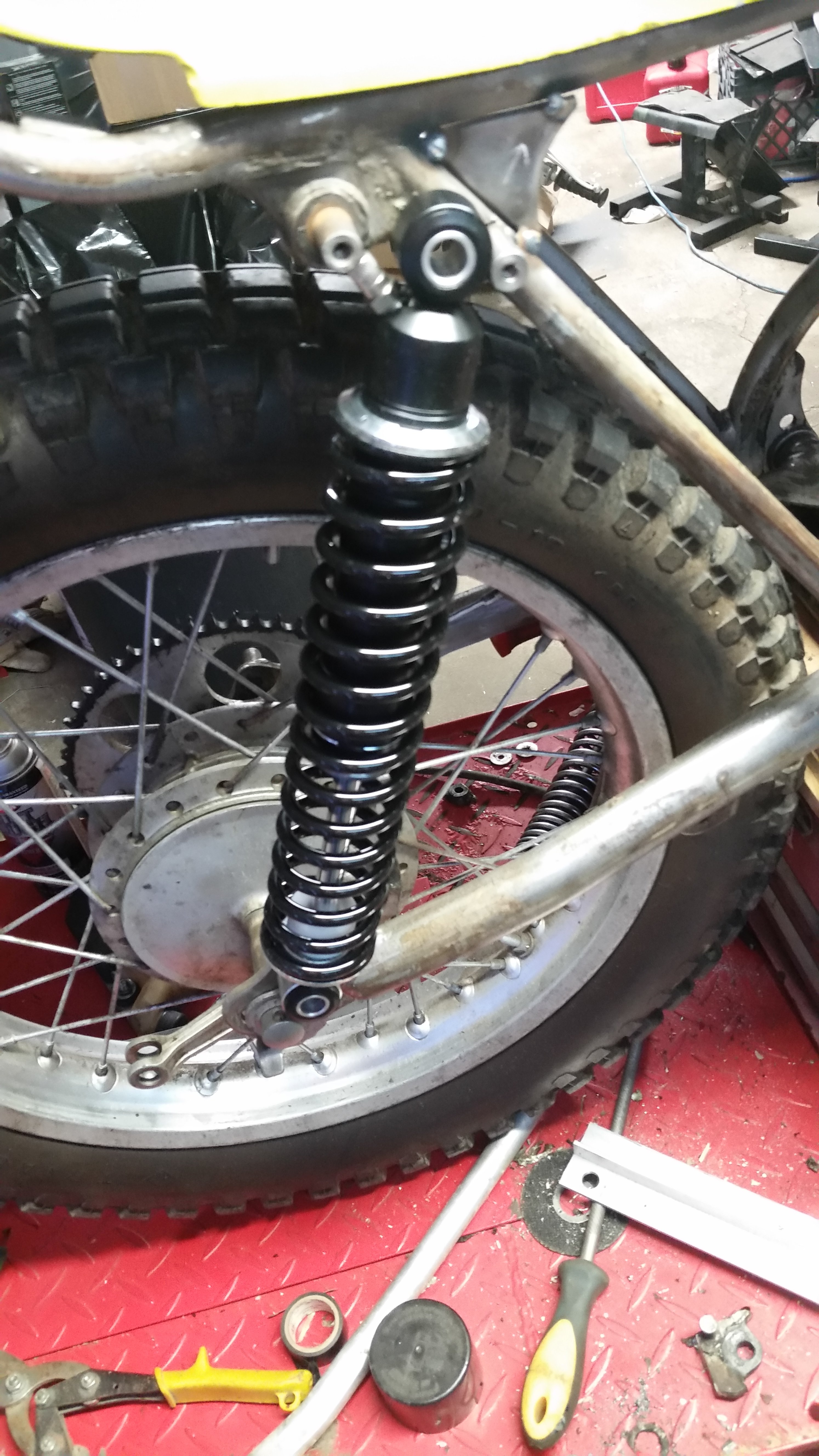

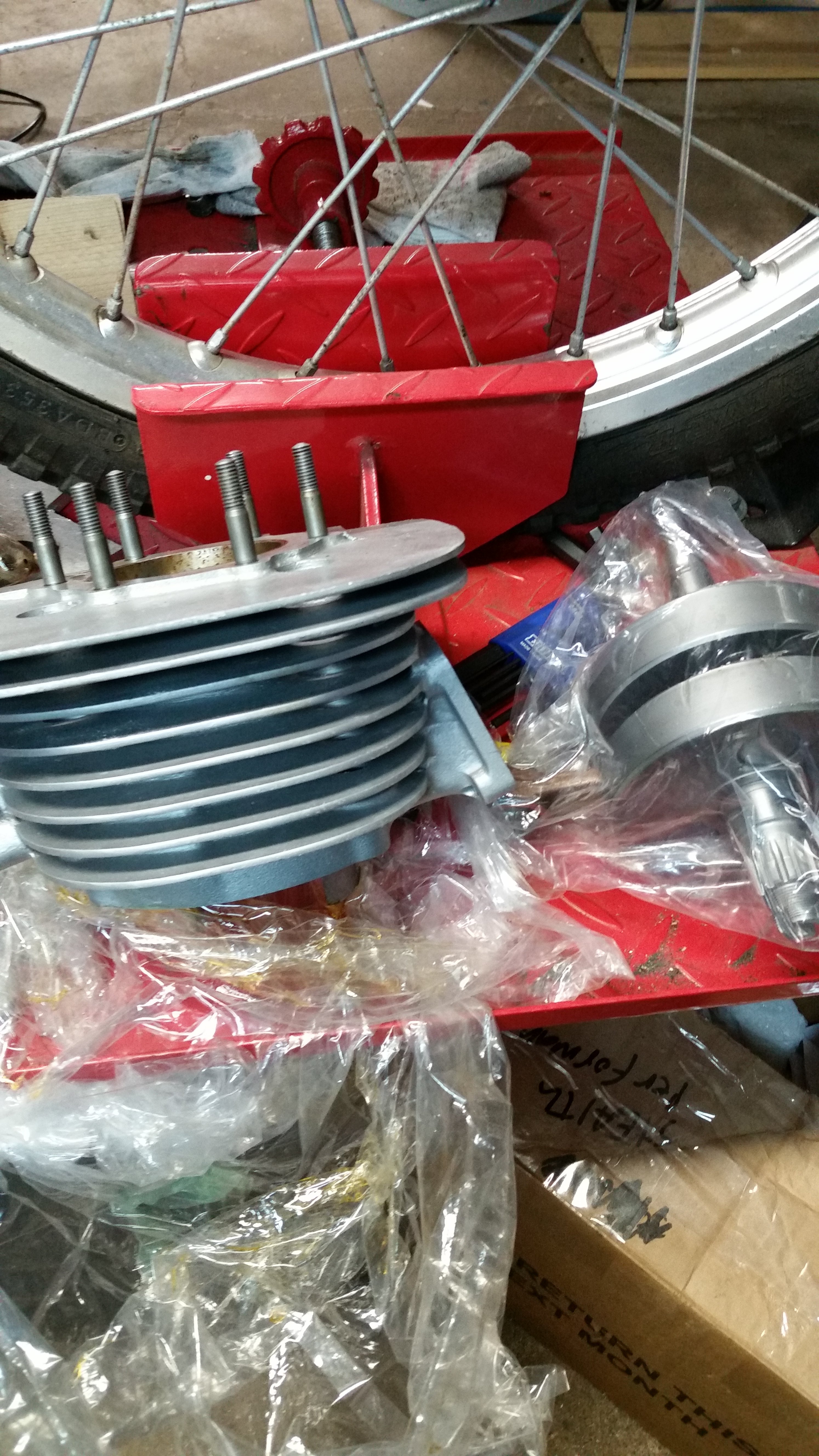

Junglejeff Posted January 26, 2019 Author Report Share Posted January 26, 2019 Received some parts for bike and started working on it more.Real happy with the work my guy did with reboring and crank rebuild.Received my falcon shocks from Europe and pretty nice looking shocks for just over 200 bucks.These old bikes are alot of fun to work on. 2 Quote Link to comment Share on other sites More sharing options...
feetupfun Posted January 26, 2019 Report Share Posted January 26, 2019 I just bought some new Falcons too and am very impressed with the revised (improved) mounting system they have now Quote Link to comment Share on other sites More sharing options...
Junglejeff Posted January 26, 2019 Author Report Share Posted January 26, 2019 7 hours ago, feetupfun said: I just bought some new Falcons too and am very impressed with the revised (improved) mounting system they have now What did they change?.The only issue I am having is I have to sand mounts on bike I little as they will not slide over. Quote Link to comment Share on other sites More sharing options...
feetupfun Posted January 26, 2019 Report Share Posted January 26, 2019 6 hours ago, Junglejeff said: What did they change?.The only issue I am having is I have to sand mounts on bike I little as they will not slide over. To avoid side loading on the seals, shockies need to rotate freely on the mount as the swingarm oscillates and with the old all-rubber mounts, some people mounted the FALCONS with the rubber clamped tight by the fixing. They also chewed out fairly rapidly, causing slack. They also were difficult to resize to suit larger mounting pins. Yamahas are OK because they are all 12mm pins but Kawasakis and OSSAs have 12mm pins at the bottom and bigger mounting pins at the upper ends. The new FALCON mounts allow the shock to rotate freely on the mounts because the fixing clamps the aluminium bush. Yes I also had to clean the gunge and rust off my pins to make the aluminium bushes slide on. 1 Quote Link to comment Share on other sites More sharing options...
