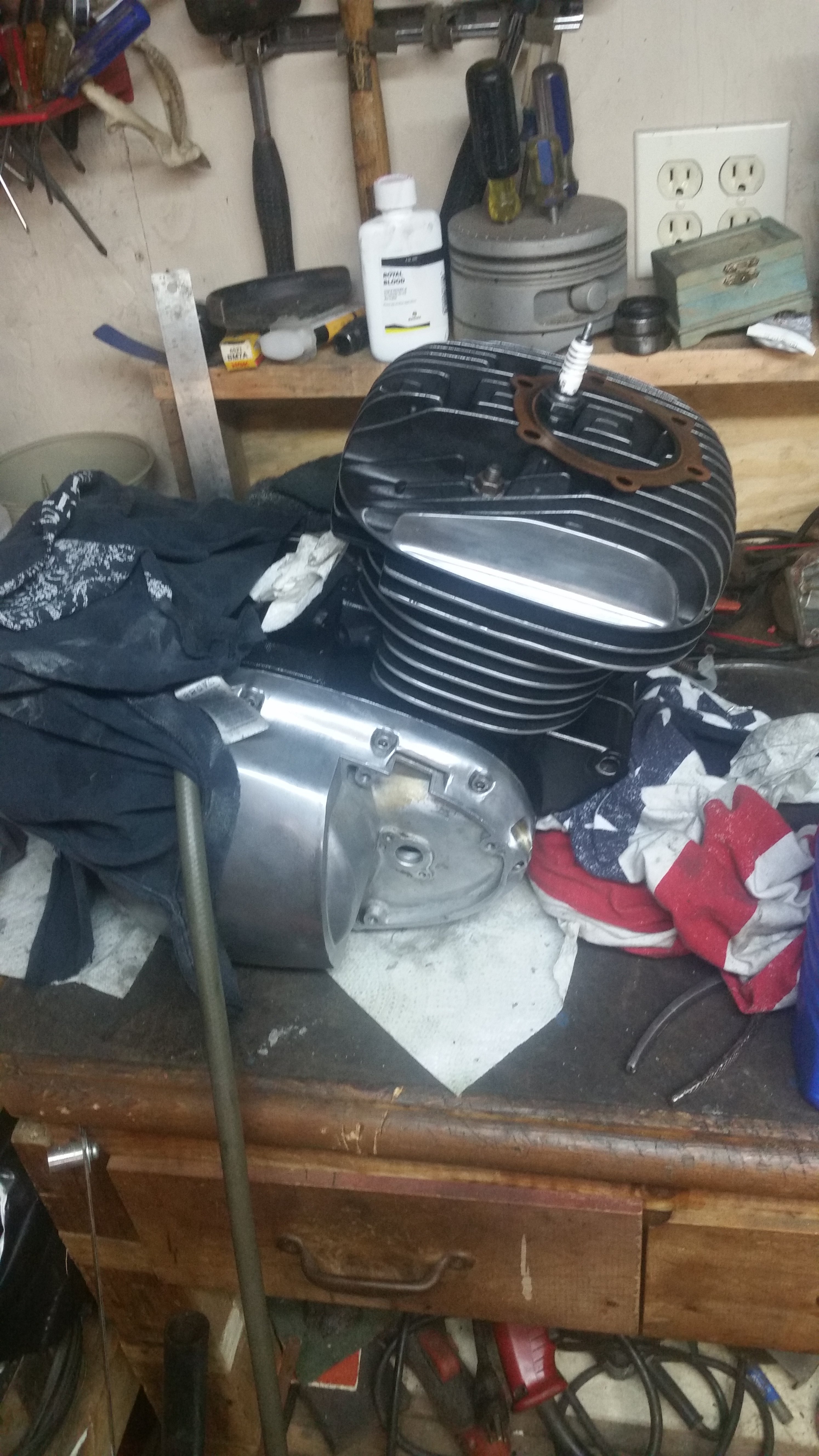

pmk Posted November 23, 2019 Report Share Posted November 23, 2019 (edited) On 4/18/2019 at 2:47 AM, Junglejeff said: I need to plug some holes on the motor from removing oil injection. The flywheel cover and pump cover were damaged and welded badly so going to grind them out,reweld and clean up. Expand Just noticed your pen / screwdriver holder...Lycoming or Continental? Edited November 23, 2019 by pmk Quote Link to comment Share on other sites More sharing options...

Junglejeff Posted November 26, 2019 Author Report Share Posted November 26, 2019 On 11/23/2019 at 10:51 AM, pmk said: Just noticed your pen / screwdriver holder...Lycoming or Continental? Expand .Lycoming Quote Link to comment Share on other sites More sharing options...

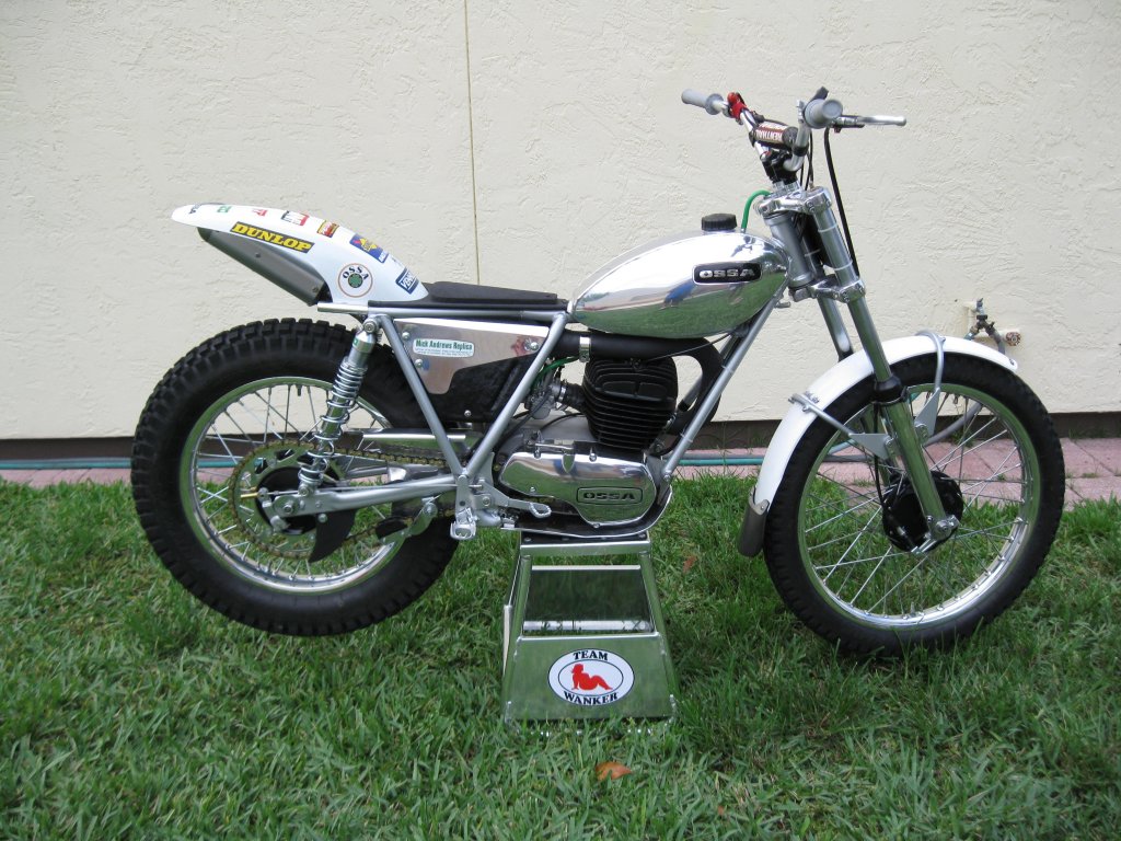

trialsrfun Posted November 28, 2019 Report Share Posted November 28, 2019 On 11/23/2019 at 11:01 AM, pmk said: When we built my buddies 72 MAR, many changes were made, including installing Yamaha wheels and brakes that are period correct. I have ridden his MAR and it will stop, plus has the feel and control pretty close to modern bike disc brake feel. Expand Like the MAR have you a photo of the other side please? 1 Quote Link to comment Share on other sites More sharing options...
pmk Posted November 29, 2019 Report Share Posted November 29, 2019 On 11/28/2019 at 6:47 PM, trialsrfun said: Like the MAR have you a photo of the other side please? Expand 1 Quote Link to comment Share on other sites More sharing options...
feetupfun Posted November 29, 2019 Report Share Posted November 29, 2019 On 11/23/2019 at 11:01 AM, pmk said: When we built my buddies 72 MAR, many changes were made, including installing Yamaha wheels and brakes that are period correct. I have ridden his MAR and it will stop, plus has the feel and control pretty close to modern bike disc brake feel. Expand Thanks PMK that looks great. I'm having a go at guessing which Yamaha the rear hub came from. Being brake and sprocket on the same side I'm thinking late model (post -81) IT175 or YZ125 Quote Link to comment Share on other sites More sharing options...
pmk Posted November 30, 2019 Report Share Posted November 30, 2019 On 11/29/2019 at 10:33 AM, feetupfun said: Thanks PMK that looks great. I'm having a go at guessing which Yamaha the rear hub came from. Being brake and sprocket on the same side I'm thinking late model (post -81) IT175 or YZ125 Expand Date codes are 1979, so they comply with available prior to 1980. Parts are 1980 Yamaha, which was available in 1979, keeping the bike legal as a pre 1980 machine with period correct items. Look close at the details required to do this. I had to “C” notch the frame. The entire pedal setup is redeveloped. I have a cable swaging machine to build the rear brake cable. Essentially, there was fabrication time altering the frame, machining time, and fabrication of detail parts including the cable. All this was after getting the much wider wheel into the swingarm while aligning the chainline. Many hours of sorting it out, designing, fabricating, etc., then having hope it would work. We considered many hubs / wheels before even starting. FWIW, both wheels were completely disassembled. Cleaned, polished, hubs painted and modified as needed. Suffice to say, getting the hub in the swingarm was no simple plug and play task. But seems to give a clean look and functions well. 1 Quote Link to comment Share on other sites More sharing options...
feetupfun Posted December 1, 2019 Report Share Posted December 1, 2019 On 11/30/2019 at 11:24 AM, pmk said: Date codes are 1979, so they comply with available prior to 1980. Parts are 1980 Yamaha, which was available in 1979, keeping the bike legal as a pre 1980 machine with period correct items. Look close at the details required to do this. I had to “C” notch the frame. The entire pedal setup is redeveloped. I have a cable swaging machine to build the rear brake cable. Essentially, there was fabrication time altering the frame, machining time, and fabrication of detail parts including the cable. All this was after getting the much wider wheel into the swingarm while aligning the chainline. Many hours of sorting it out, designing, fabricating, etc., then having hope it would work. We considered many hubs / wheels before even starting. FWIW, both wheels were completely disassembled. Cleaned, polished, hubs painted and modified as needed. Suffice to say, getting the hub in the swingarm was no simple plug and play task. But seems to give a clean look and functions well. Expand What is so important about being pre-80? Quote Link to comment Share on other sites More sharing options...
pmk Posted December 1, 2019 Report Share Posted December 1, 2019 On 12/1/2019 at 7:57 AM, feetupfun said: What is so important about being pre-80? Expand It’s an AHRMA rule if the machine were to ever compete in one of those events. Luckily it will not be a part of that organization. Heard from someone that is involved with AHRMA trials, they apparently banned OKO and all carbs unless round slide. Kind of a dumb rule. So now you must spend more money, plus time and have a bike that likely runs worse to compete in an organization that is struggling to get entries. Sounds like a great way to promote vintage entries. Next they will insist on an old school spec tire, the same type tire for everyone. 1 Quote Link to comment Share on other sites More sharing options...
