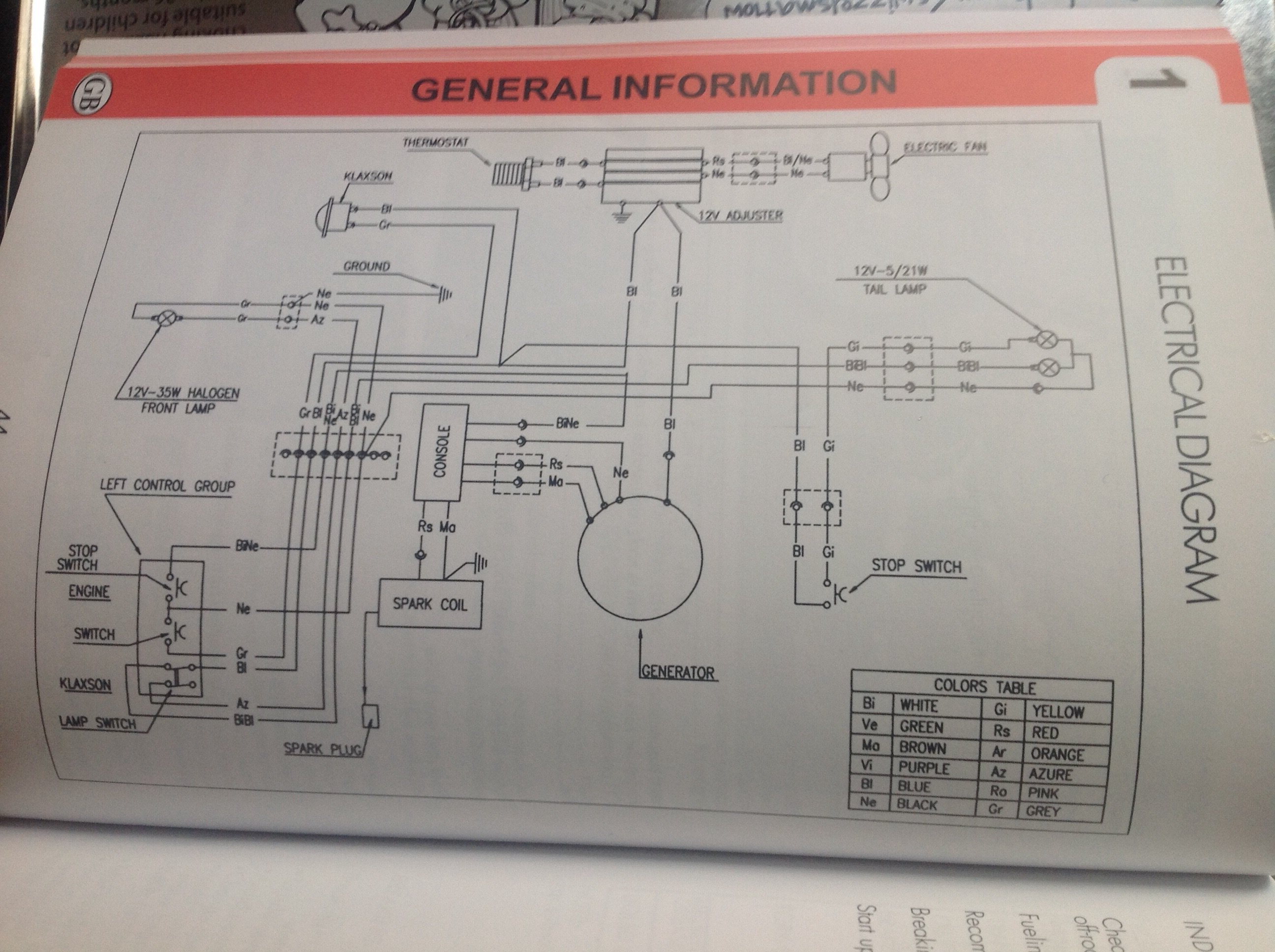

Been wanting to get into trials for a while so bought a Rev3 270 but having problems getting it started. Thinking that it’s the stator but the pdf of the manual that I have is blurry and I can’t read the wiring diagram.
Want to test the stator before I remove it - does anyone have a picture of that bit of the diagram so I can put a voltage tester across it?

I'm having a similar problem. The only manual I can find is all blurry. It also doesn't say how to test the stator like most manuals do. Your problem might not be the stator though. These things are kind of a pain in the ass to start. Someone on here told me to push it forward 3 or 4 times and quickly hit the brake so a bit of gas goes into the engine and then kick it really really hard. Someone else told me to lean it on it's side for a couple of seconds before starting it to get gas to go in the engine. You remove the 1 big nut, and you need a flywheel puller. I forget the size off the top of my head but I want to say it's a size 30. I couldn't undo those two phillips head screws, but they only hold the weight onto the flywheel anyway. You would still need to remove the main nut to get access to the stator. The problem I'm having is the previous owner got water under the stator cover, so all the contact points at the top of each winding got rusty. I had to clean it off. Now they are a little potmarked. It was still working fine, but once in a while I'd have to open it back up and clean those areas. Now I'm getting spark, but it still won't start, so I'm thinking the spark isn't strong enough or it's not consistent. If I were you I would just test how much spark you're getting at the plug and before the cdi to see if it's an actual electrical problem or just you getting used to kick starting it. Have you gotten it started at all? If you come across an unblurry wiring diagram please share it with me. Good luck.

On 1/26/2019 at 4:04 AM, Lightweight said:
Hope this helps you Franklin
