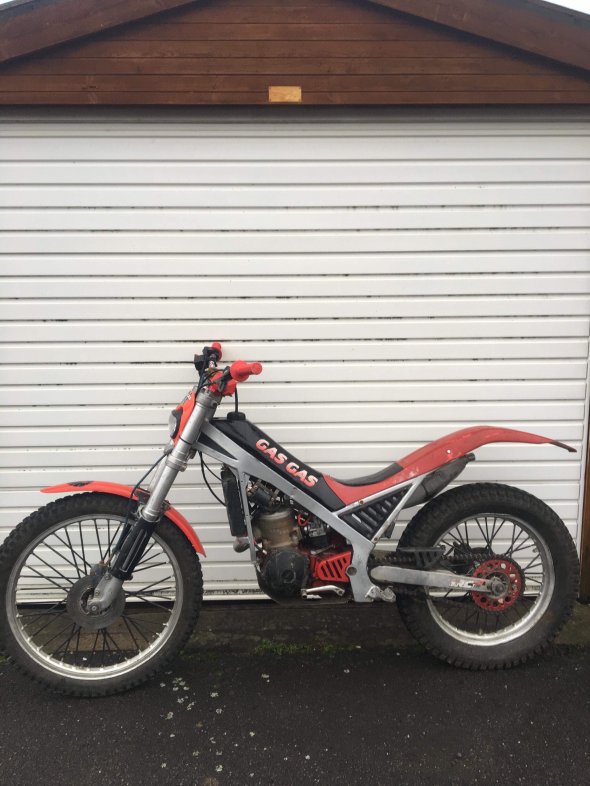

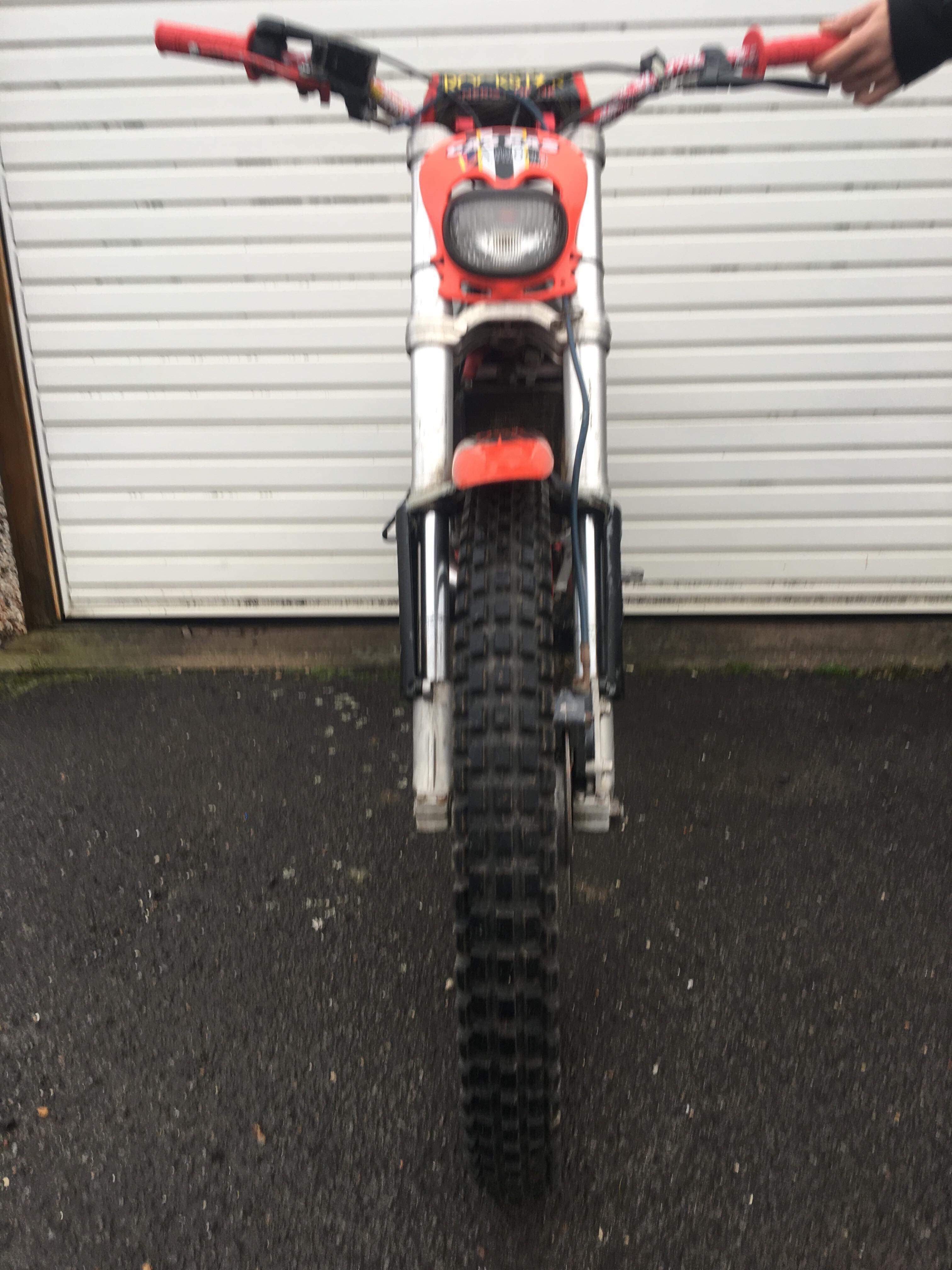

tshock250 Posted January 11, 2019 Report Share Posted January 11, 2019 Can you post a picture of the bike so we can see exactly what you've got? Quote Link to comment Share on other sites More sharing options...

tshock250 Posted January 11, 2019 Report Share Posted January 11, 2019 Wow, that's a rare old beast. Almost certain its a Delta, plastics would originally have been white (1990) or green/purple (1991) Looks like a delta engine plus has other delta parts on it so pretty sure that's what it is. Quote Link to comment Share on other sites More sharing options...
