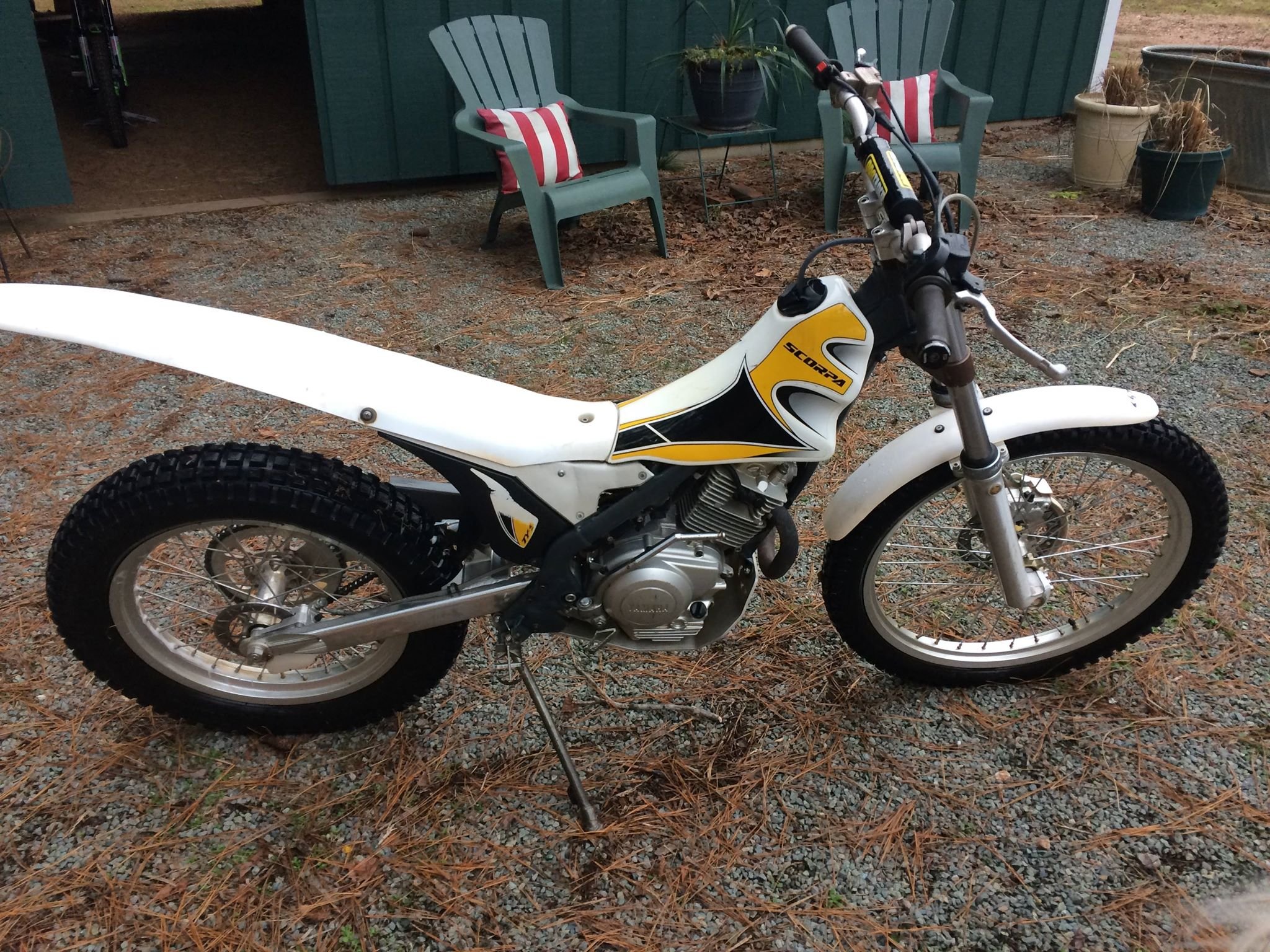

snappster Posted January 14, 2019 Report Share Posted January 14, 2019 After lurking for some time I got my first trials bike, a 2006 SY175. Started the basic maintenance and I have some questions you SY guys probably can answer. 1)Where is the oil "filter" and how is it accessed? 2) Where can I obtain several air filter elements? Mine has a hole right along one edge of the rectangular filter plastic frame. 3) Is there a shop manual for the bike? How to get it? Would a TTR125 manual work for the engine? 4) What to do with the nut that holds the back of the fuel tank, it is spinning and lining up the bolt through the fender is not working well? I am considering removing that nut and replacing it with a hex nut and washer. 5) Remind me what the valve clearance spec is, I read it somewhere but forgot the numbers. I guess this is enough to start me off. I may ask more questions, about the carb and jetting next time as the bike is very cold blooded not taking any throttle until quite warm. I just picked it up yesterday and can't wait to fool around on it. Quote Link to comment Share on other sites More sharing options...

breagh Posted January 14, 2019 Report Share Posted January 14, 2019 Hello, I've got your bikes double and have run it since new. There's no oil filter just change it every 20 rides or so and watch and not strip the drain bolt. The filters are common to most Scorpas 0f that era 2ts too so any decent trials shop should stock them the air box is good but tape the space between the exhaust and the mudguard and where the the box and mudguard meet. Trust me you wont need a manual nothing goes wrong but they're the same motor as the TT125. The captive nut that holds the tank is a pain mine still works can't really suggest anything. Never checked the valve clearances and I'll bet mines done more Trials than any single bike in Scotland so no help here. Bikes no power until it's warm, always been that way but once hot fine, most fiddle with jetting but mine is stock and runs better than any of the others I've tried. Just ride it and forget about it wish mine looked as good as yours, Quote Link to comment Share on other sites More sharing options...

snappster Posted January 14, 2019 Author Report Share Posted January 14, 2019 Good info so far. I talked with Mike at tryalsshop and ordered an air filter, 17.5 pilot jet, and a spark plug. Rode a few laps around the front yard just to start getting used to riding a trials bike and thinking about all those videos I have watched on youtube, etc. Having attempted a few trials sections on my klx250 I am already cognizant of the better slow handling and ease of the SY. Thanks guys. 1 Quote Link to comment Share on other sites More sharing options...
snappster Posted January 21, 2019 Author Report Share Posted January 21, 2019 Bike is running much better with a new 17.5 jet, air filter, and spark plug. Went 3 full turns out on the idle screw. Choke off in 30 sec. and full throttle in a couple of min. without stumbling. Bike already had a 17.5 but it was mostly obstructed so the new one went in. Getting better at installing the tank and fender. Improving my balance and turning in the yard. It was a good day fo sho. Looking forward to riding somewhere better but it's crazy how tight this bike turns in my tiny yard; there is enough room for a workout. 1 Quote Link to comment Share on other sites More sharing options...
