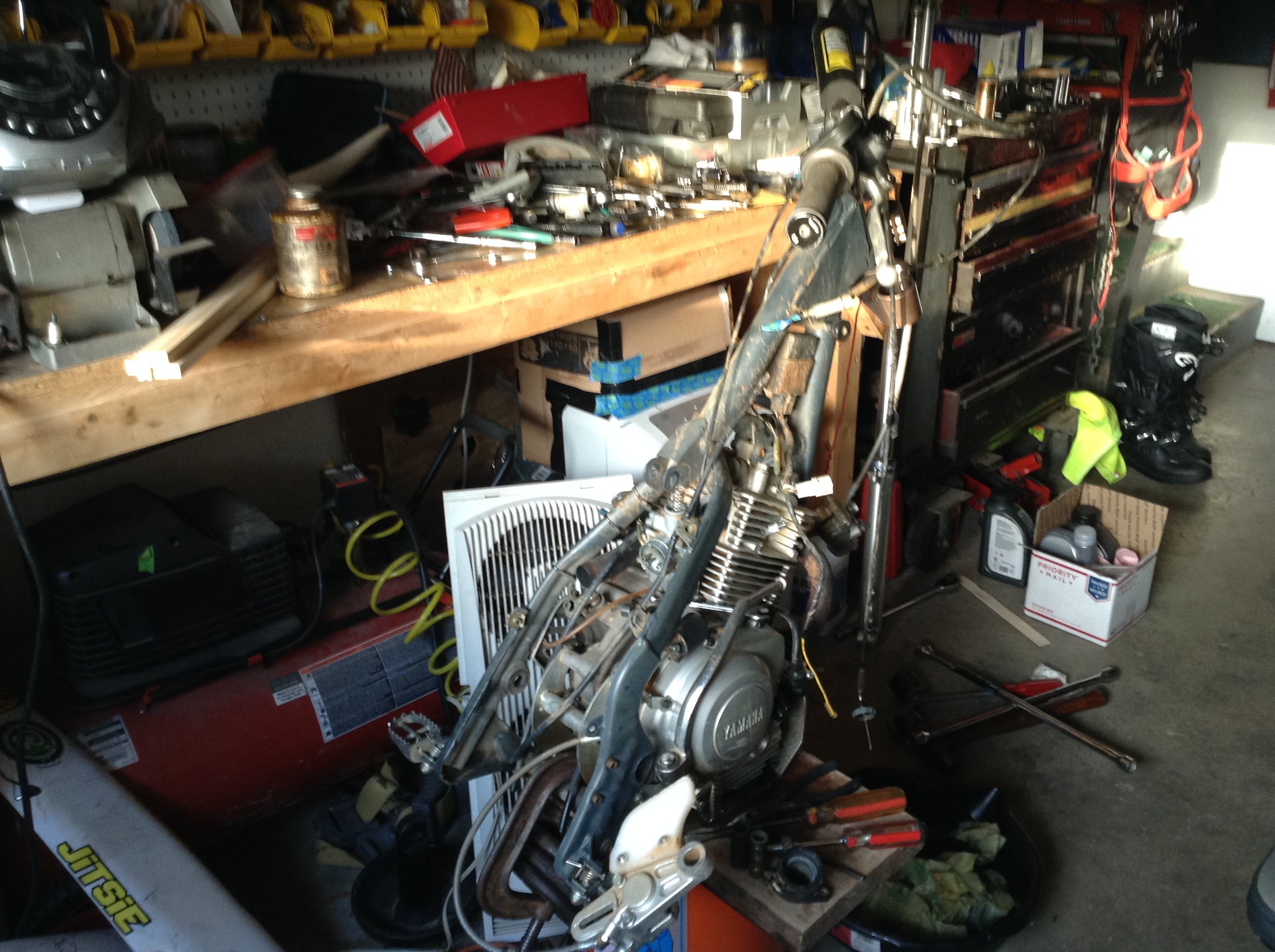

snappster Posted February 9, 2019 Author Report Share Posted February 9, 2019 After riding around the yard for a while I decided it was time to seriously go through the bike. Got the fork oil changed out after partial disassembly and cleaning. As expected the oil was fairly nasty. Discovered one of the front wheel bearings was bad; explains that crunchy noise I had occasionally heard, will order both front bearings. Steering head bearings have more play than I like so it is coming apart tomorrow and will at least get bearings cleaned, greased, and adjusted. Should have a few parts to order as I go through the entire bike. 1 Quote Link to comment Share on other sites More sharing options...
snappster Posted February 9, 2019 Author Report Share Posted February 9, 2019 So the rear wheel bearings are also shot. With the aluminum spacer inside the hub I cant get a punch behind the bearings to drive them out. How do you guys remove the wheel bearings? I am guessing that I need a drift with a shoulder to catch the spacer. Are they for sale or easy to make? Quote Link to comment Share on other sites More sharing options...

snappster Posted February 9, 2019 Author Report Share Posted February 9, 2019 (edited) Nice video. Swing arm is out and the drive side bearing is pretty dry, so I might as well replace them too. All wheel bearings are out with minimal damage to the spacers thanks to your help. Got the steering stem apart and found rollers instead of balls. Looks like they got greased somewhere along the way because they look fairly well packed and the grease looks clean. Think I will just adjust those bearings and call it done. Thanks for the help guys. I want the bike right before the weather gets nice and my first trial in March. Edited February 10, 2019 by snappster 1 Quote Link to comment Share on other sites More sharing options...

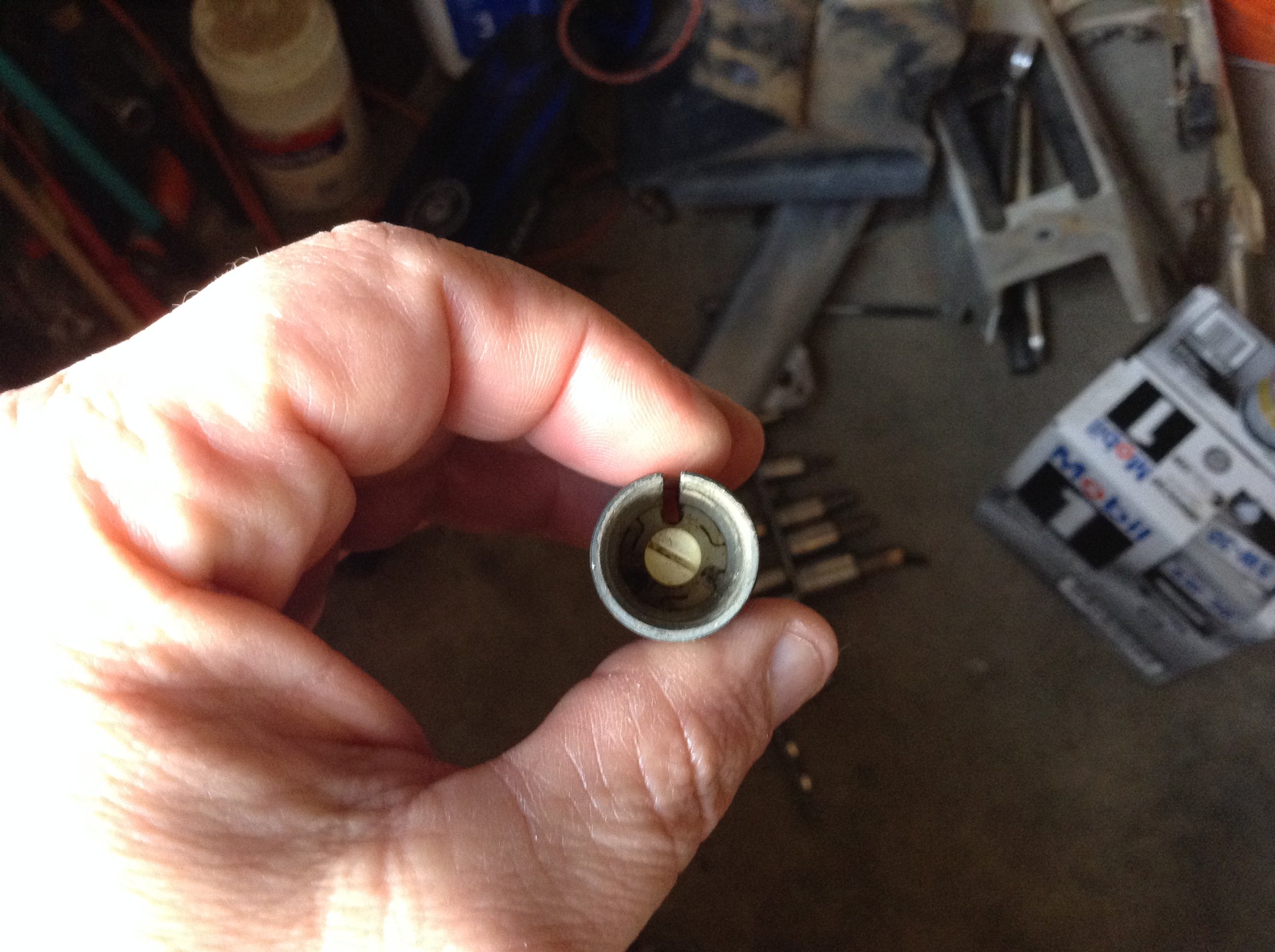

snappster Posted February 20, 2019 Author Report Share Posted February 20, 2019 (edited) Today's questions: 1) How is the carb needle removed from the slide? I am being gentle but it isn't coming out the top of the slide. 2) Precisely what material should I remove on the intake pipe-head joint? Is it typically material removal from the head, or pipe? If it is the head do I have to remove the head? What if I stuff a rag in the intake runner, file the offending ridge, then vacuum out the shavings? Thanks everyone. Edit: yep, I am messing around with it while I wait for parts from Mike K. Edited February 21, 2019 by snappster Quote Link to comment Share on other sites More sharing options...

breagh Posted February 21, 2019 Report Share Posted February 21, 2019 19 hours ago, snappster said: Today's questions: 1) How is the carb needle removed from the slide? I am being gentle but it isn't coming out the top of the slide. 2) Precisely what material should I remove on the intake pipe-head joint? Is it typically material removal from the head, or pipe? If it is the head do I have to remove the head? What if I stuff a rag in the intake runner, file the offending ridge, then vacuum out the shavings? Thanks everyone. You're fiddling, I'm not telling you how to take it out as mine's never been out in 12 years nor has any part of the engine other than the carb been removed. Never ridden one that runs any better than mine some are different but not an improvement, the limiting factor on these bikes is lack of ground clearance. It will ground on stuff that other bikes clear easily so you've really got to work at keeping the front wheel light. Get out and play you'll never wear this bike out they're great. Quote Link to comment Share on other sites More sharing options...
