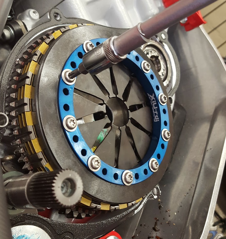

heffergm Posted January 16, 2019 Report Share Posted January 16, 2019 (edited) I have an '18 (and I've had a '17 and a '14). It (the stock clutch) is perfectly fine. There was and is no problem with them... they've been the same design for eternity, if they were broken no one would buy them. I've also put Xiu (kevlar) clutches in a few of my GG's, and they work exactly the same... There's little difference in feel, provided the clutch pack is the same thickness as the one being compared to. The adjustable preload ring on all bellville spring bikes that have one works by the same principle: it's a stepped ring, so you pull out all the retaining bolts, spin the ring to line it up with the setting you want, and bolt it back on. And yes, this works exactly as it should on the '18. This is a Xiu adjustable ring, but the one in the '18 is the same thing but a different color. Edited January 16, 2019 by heffergm 1 Quote Link to comment Share on other sites More sharing options...
the dabster Posted January 16, 2019 Author Report Share Posted January 16, 2019 Thanks for the info and the picture. I probably didn't word my question as well as I could have. I have had a new one myself every year since 13' and never had a problem with any of the clutches till this current one. I thought I imagined the lever getting stiffer but I'm also bothered with tendonitis so didn't think much more about it until I tried the clutch on another bike and realised there was a problem. I spoke to someone knowledgeable about it and he inferred quite a few 18's had this problem and advised me to dress the fibre plates on fine wet and dry as they were swelling? I also know someone that does a lot of work on trials bikes and he confirmed he had done quite a few. There was also some info about the composition of the fibre plates having less asbestos which was replaced with an alternate material that was proving absorbent. Sounds feasible enough and certainly concurs with my experience. Add to this the switch to Kevlar and it all makes sense. Quote Link to comment Share on other sites More sharing options...
heffergm Posted January 16, 2019 Report Share Posted January 16, 2019 It's certainly possible they got a batch of fiber plates that are swelling, it's happened before. Going to Kevlar presumably eliminated that possibility, which is as good a reason as any to do it. 1 Quote Link to comment Share on other sites More sharing options...

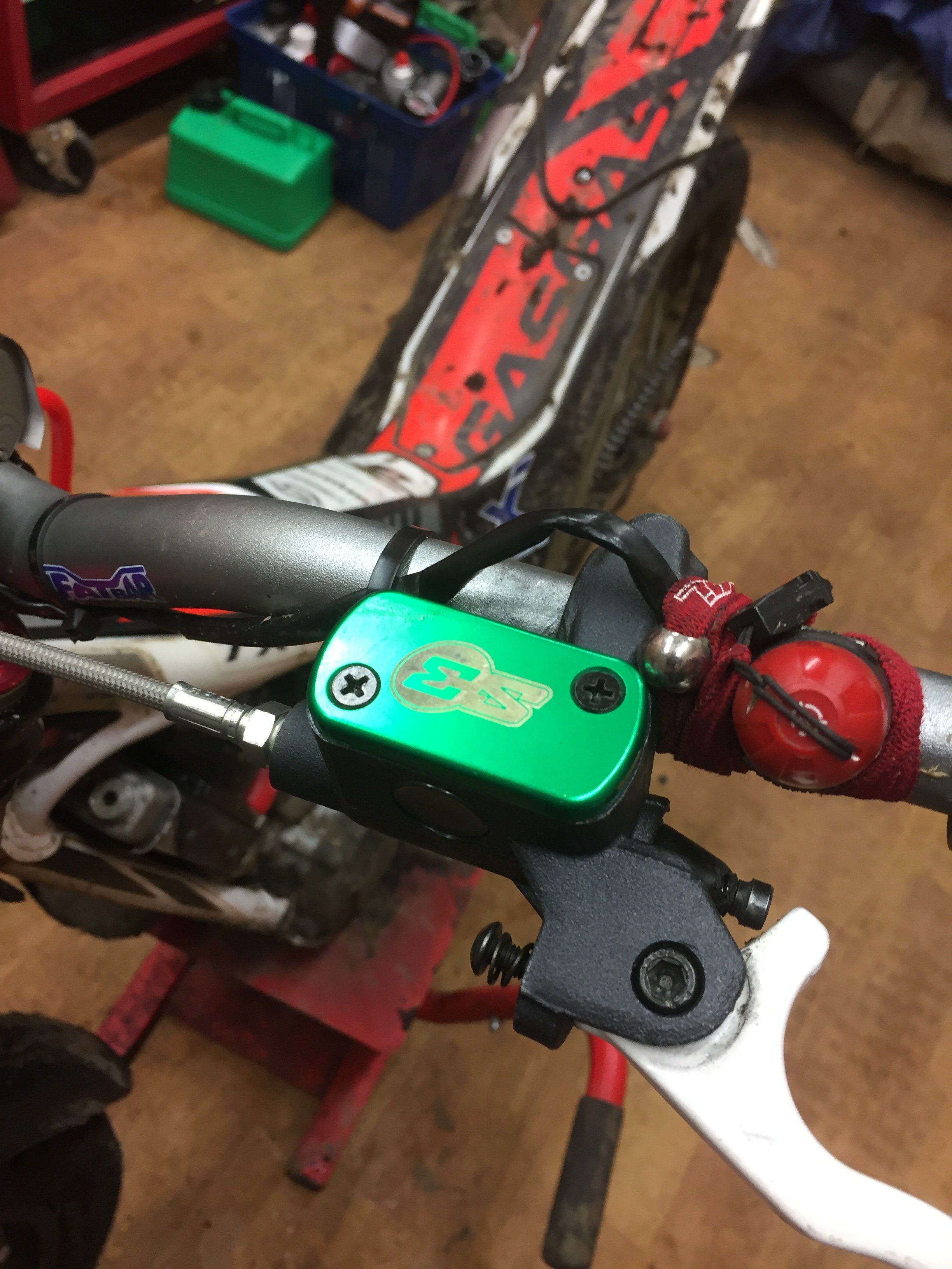

imexian Posted January 16, 2019 Report Share Posted January 16, 2019 (edited) Well, I’ve had 5 hours on it, I’m laying on bed now, I’m creamed, and my back is smashed.... clutch is a lot better at biting, before it seems a bit like launch control, not putting power to rear wheel cleanly, if you understand? still have a prob with lever creeping to bars, not all the time intermittently? especially when bike is inverted upwards?? ive got home and changed master cylinder to an AJP, larger reservoir type, I know braktec have had a few issues. Just had wizz round garden, doesn’t seem much different, but need to try properly Not sure what the next move is, if no better? Edited January 16, 2019 by imexian Grammer Quote Link to comment Share on other sites More sharing options...
arnoux Posted January 16, 2019 Report Share Posted January 16, 2019 No actuating pin or jam nut on that lever. Quote Link to comment Share on other sites More sharing options...
imexian Posted January 16, 2019 Report Share Posted January 16, 2019 Yes I know, it was just to show the MS I’m using! Quote Link to comment Share on other sites More sharing options...
