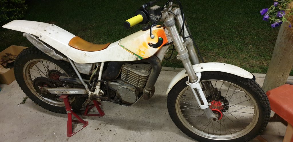

Leigh Posted January 17, 2019 Report Share Posted January 17, 2019 Hi Guys, Having a hassle with my clutch, it's an old bike and I am in the process of refurbishing it. The snag is I have no idea how yo open up the clutch and investigate what the actual problem is. Any help will be much appreciated, a manual, video or some pics. Thanks in advance! Leigh Quote Link to comment Share on other sites More sharing options...

alberto Posted January 17, 2019 Report Share Posted January 17, 2019 it's a Fantic 307 consider how many money cost you restore this bike ? Quote Link to comment Share on other sites More sharing options...

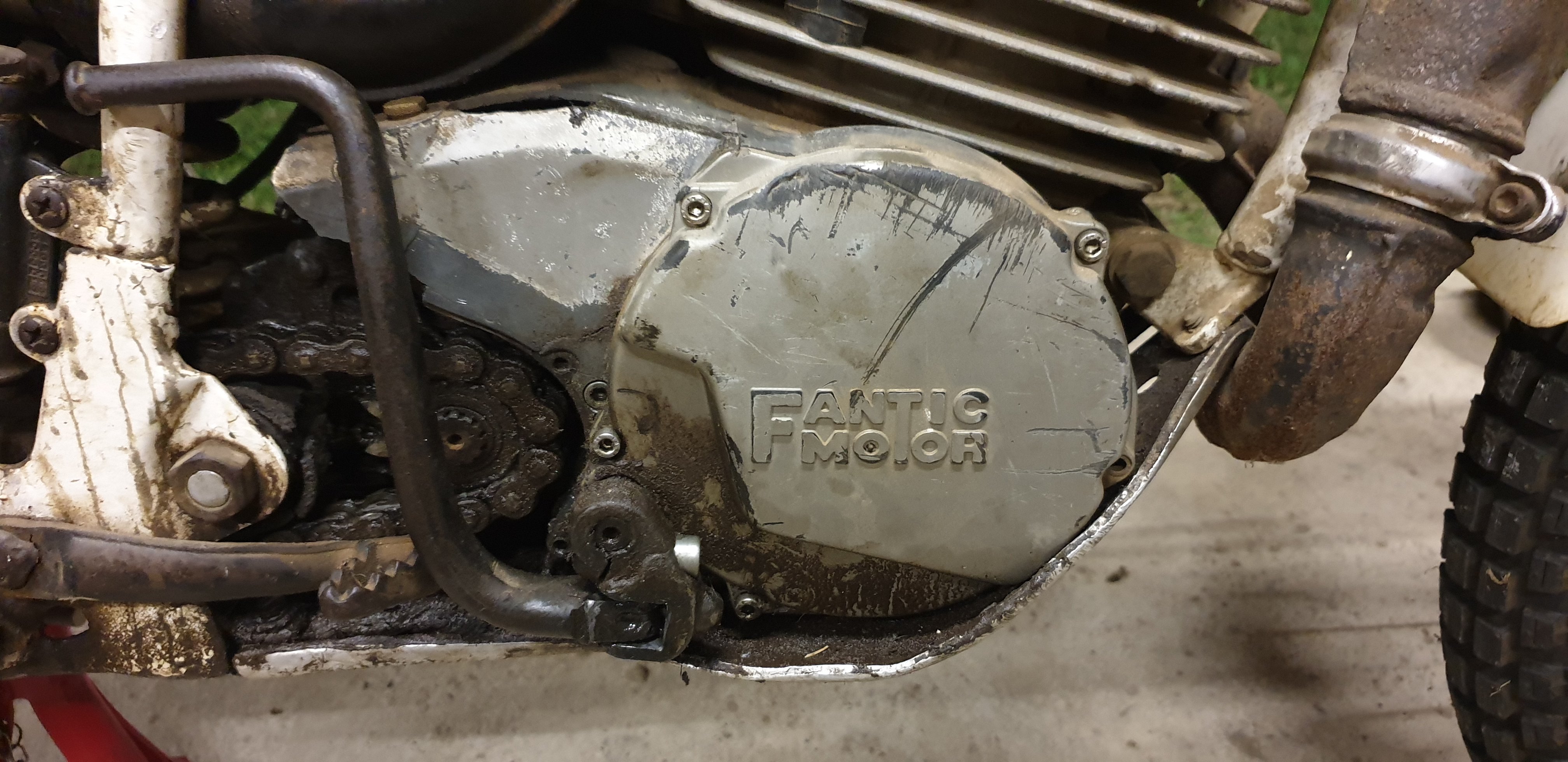

fantic240motor Posted January 17, 2019 Report Share Posted January 17, 2019 This parts list might help. Unfortunately there isn't a "how to" workshop manual available for this bike. I've attached the owners very similar 305 manual that does have some useful info. The clutch is on the gear shift side. The cover is easily removed, you'll see the clutch basket with metal and friction plates inside. Jugging from the overall condition of your project I'd say new plates, gear oil and control cable would be a good place to start to get the clutch working smoothly. All available from inmotion here in the UK who will send parts all over the world. I rescued a 307 in similar condition once and it was a fun project. Just a heads up with the kickstart lever, I'd move it clockwise a couple of notches so it sits higher when folded in. You'll not hit your toe on it when using the rear brake. Fantic_307_parts_list.pdf fantic_245_305_manual (1).pdf Quote Link to comment Share on other sites More sharing options...

Leigh Posted January 18, 2019 Author Report Share Posted January 18, 2019 9 hours ago, fantic240motor said: This parts list might help. Unfortunately there isn't a "how to" workshop manual available for this bike. I've attached the owners very similar 305 manual that does have some useful info. The clutch is on the gear shift side. The cover is easily removed, you'll see the clutch basket with metal and friction plates inside. Jugging from the overall condition of your project I'd say new plates, gear oil and control cable would be a good place to start to get the clutch working smoothly. All available from inmotion here in the UK who will send parts all over the world. I rescued a 307 in similar condition once and it was a fun project. Just a heads up with the kickstart lever, I'd move it clockwise a couple of notches so it sits higher when folded in. You'll not hit your toe on it when using the rear brake. Fantic_307_parts_list.pdf fantic_245_305_manual (1).pdf The clutch cable motion rotates a shaft on the rear brake side(right) of the bike. Weird that the clutch assembly is on the left. Do I need a special tool to take it apart? Quote Link to comment Share on other sites More sharing options...

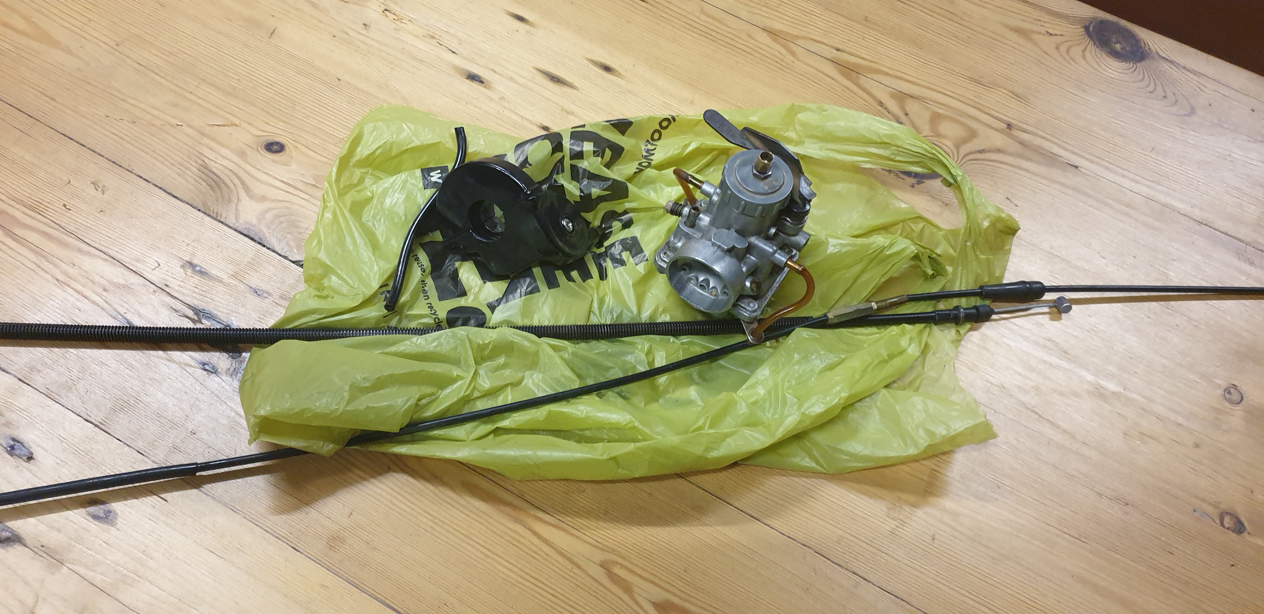

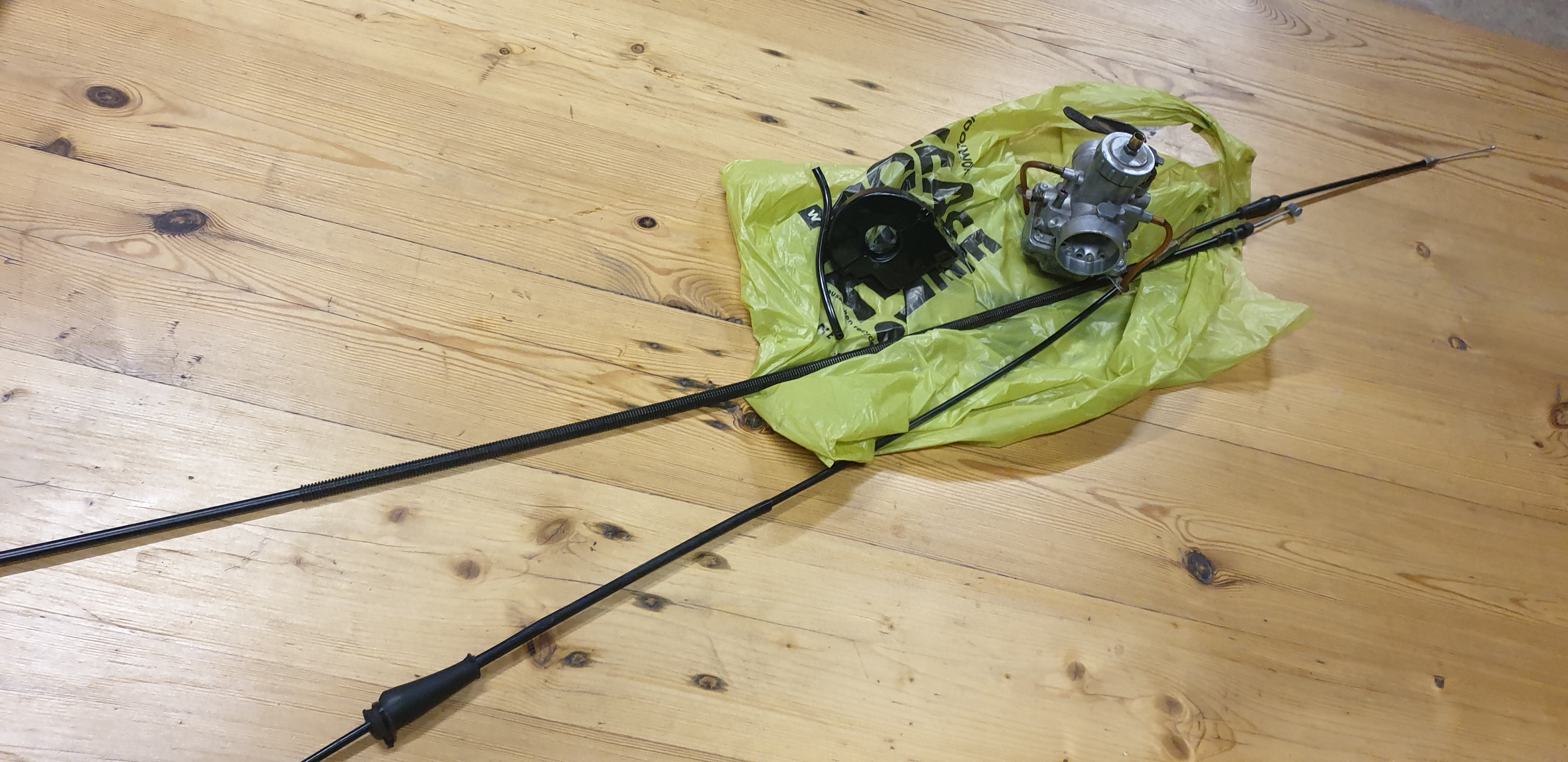

Leigh Posted January 18, 2019 Author Report Share Posted January 18, 2019 21 minutes ago, b40rt said: @Leigh see lineaway's answer above, what you are describing is classic for a bike sitting unused. Unless the carb was dry when stored, chances are it will need stripped and cleaned. I've already done a full strip and clean on the carb and new cables and sheaths all round. Just worried about clutch now. So will see if I can remedy the problem. Quote Link to comment Share on other sites More sharing options...
