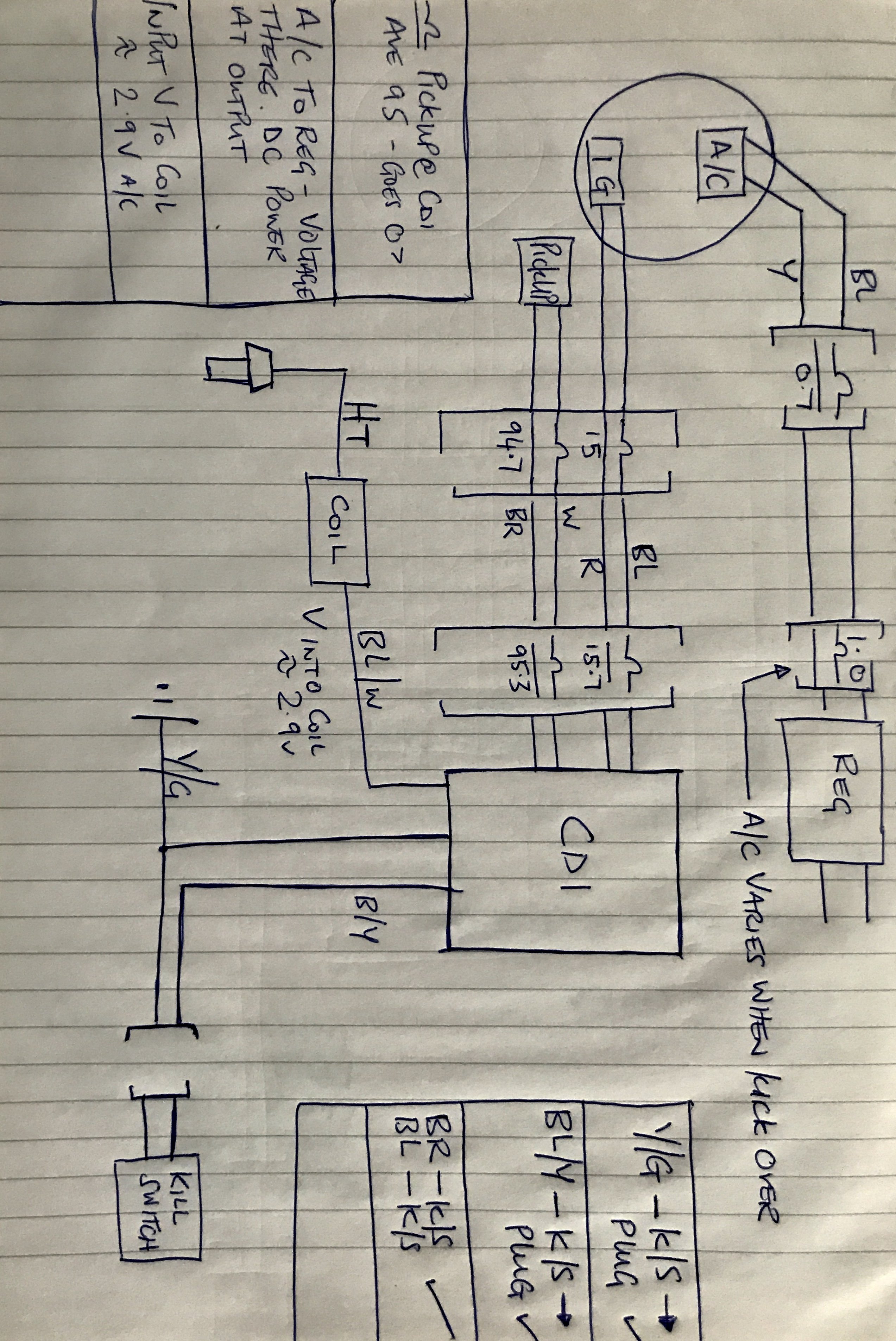

dan929 Posted January 19, 2019 Report Share Posted January 19, 2019 (edited) Had a weak/eventually no spark issue on my 18 250. It just decided it wasn’t starting again, then spent ages chasing a spark, checked earth, tang through wiring etc. Turned out the issue was a faulty CDI unit. Apologies for the bad fag packet sketch, and if I’m telling you how to suck eggs, I’m not a fan of anything electrical. If stator/ignition setup is the same as my 18 it may give you some figures from a good stator/wiring to comapare with. Final confirmation for me I was seeing around 12v up to the cdi when cranking it over, dependant on arm strength, then less than 3v out to the coil. CDI had signs of splitting around the potting so I suspect moisture was the culprit. Edited January 19, 2019 by dan929 Quote Link to comment Share on other sites More sharing options...
