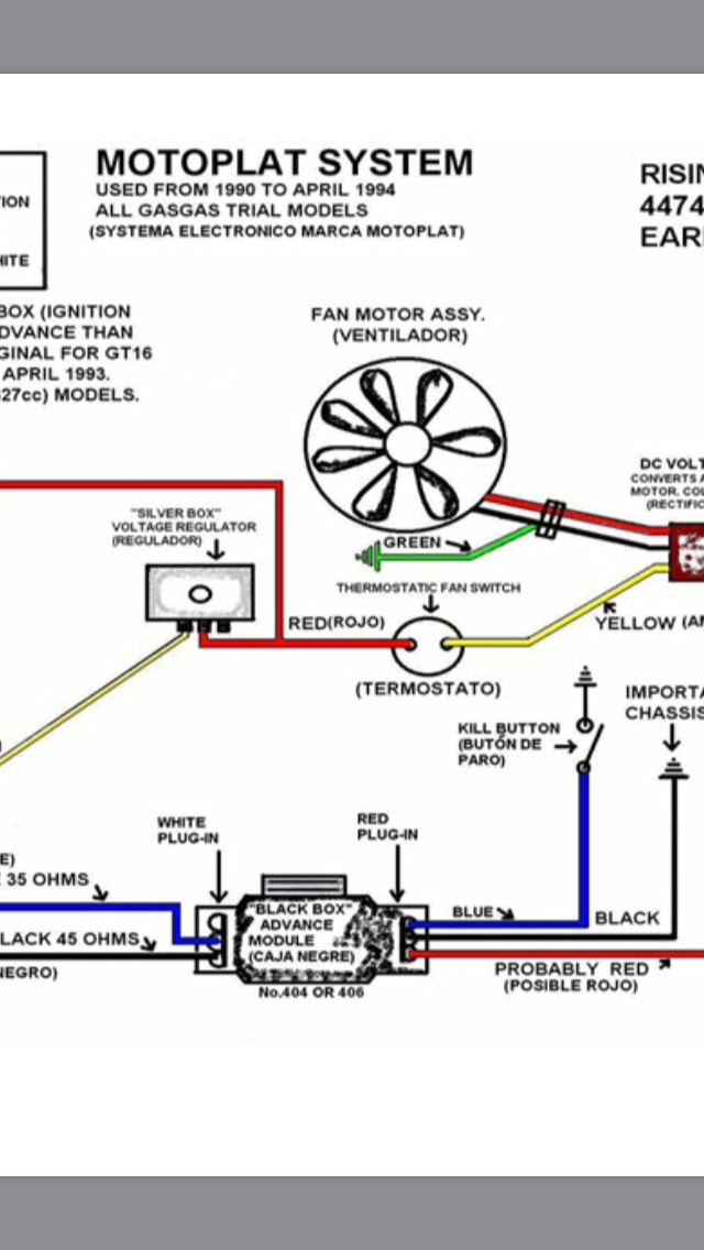

r1chard06 Posted January 19, 2019 Report Share Posted January 19, 2019 How can I test my fan wireing if I remove thermostat and join wires fan doesn’t spin if I attach battery spins fine Quote Link to comment Share on other sites More sharing options...
cascao Posted January 20, 2019 Report Share Posted January 20, 2019 Fan should spin if you short circuit thermostat wires. If not, check AC before and DC after rectifier/regulator (small square black box) Quote Link to comment Share on other sites More sharing options...
