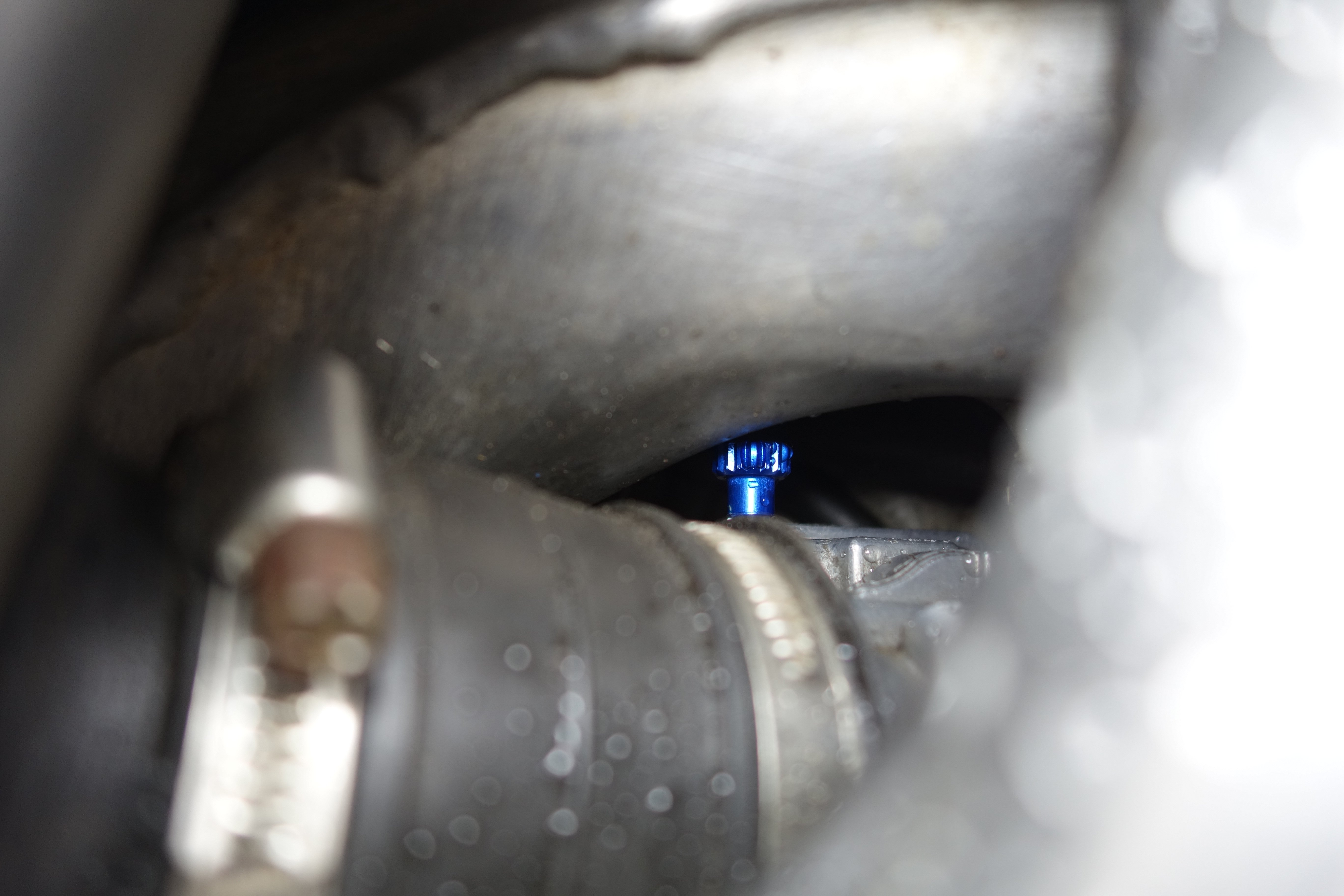

Petr Posted January 27, 2019 Author Report Share Posted January 27, 2019 Dan, I re-fitted the carb back today and I found that no screwdriver would help. Obviously you have a better arrangement. My screw is hidden beyond the exhaust pipe. To do in the morning what you do means for me taking the rear fender off, put back air filter temporarily, start bike and adjust mixture with long nose pliers from the top (see the picture). Then re-fit it all and hope nothing is going to change There is so little space that the screw hits the exhaust pipe with just couple of turns out. Now I know why the cable screw! Can you please confirm: is 1½ turn out good as a general setting for this bike? If I need to make a bigger adjustment, it is really best to take the carburettor out. Quote Link to comment Share on other sites More sharing options...
dan williams Posted January 28, 2019 Report Share Posted January 28, 2019 (edited) Eeeek! No, that won’t work. I’m sorry I didn’t realize you had one of the Jitsie accessory screws. I thought you had the original screw that came with the carb. I tried one of those on my 2013 EVO and ran into the same problem. http://www.carbparts.com/keihin/pwk28parts.htm parts 17 and 18 Edited January 28, 2019 by dan williams Quote Link to comment Share on other sites More sharing options...
geeman Posted January 30, 2019 Report Share Posted January 30, 2019 Yea agree standard screw and a long slim screwdriver easy to adjust , I find having a flashlight helps to locate the slot !! Cheers Geeman Quote Link to comment Share on other sites More sharing options...
