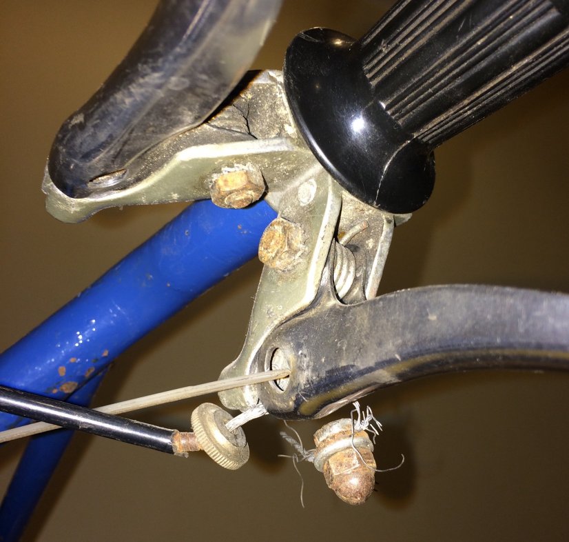

RSJ Posted January 22, 2019 Report Share Posted January 22, 2019 So, I've recently bought this and I don't think I've seen this clutch and rear brake setup before? This needs a lot of work but it was cheap and we all love bikes right? so.. I haven't stripped this yet, but it looks like it's a old points engine. it has no gear but does have a clutch. It also has no kick start?? I'm guessing you could bump it with the clutch but for it not to even have one seems odd to me. If anyone can put some light on this, all info is welcome. It's about the size of a pw80 by the way... Quote Link to comment Share on other sites More sharing options...

petert Posted January 23, 2019 Report Share Posted January 23, 2019 Engine looks very similar to the Garelli moped engines Quote Link to comment Share on other sites More sharing options...
RSJ Posted January 23, 2019 Author Report Share Posted January 23, 2019 1 hour ago, petert said: Engine looks very similar to the Garelli moped engines garelli vip, that looks like it yeah. All makes sense now, someones stuck a pedal engine in it. That's not a clutch but a starter engaged. Quote Link to comment Share on other sites More sharing options...

RSJ Posted January 23, 2019 Author Report Share Posted January 23, 2019 Funny enough, turning the foot rests turns the engine over also ? Quote Link to comment Share on other sites More sharing options...
