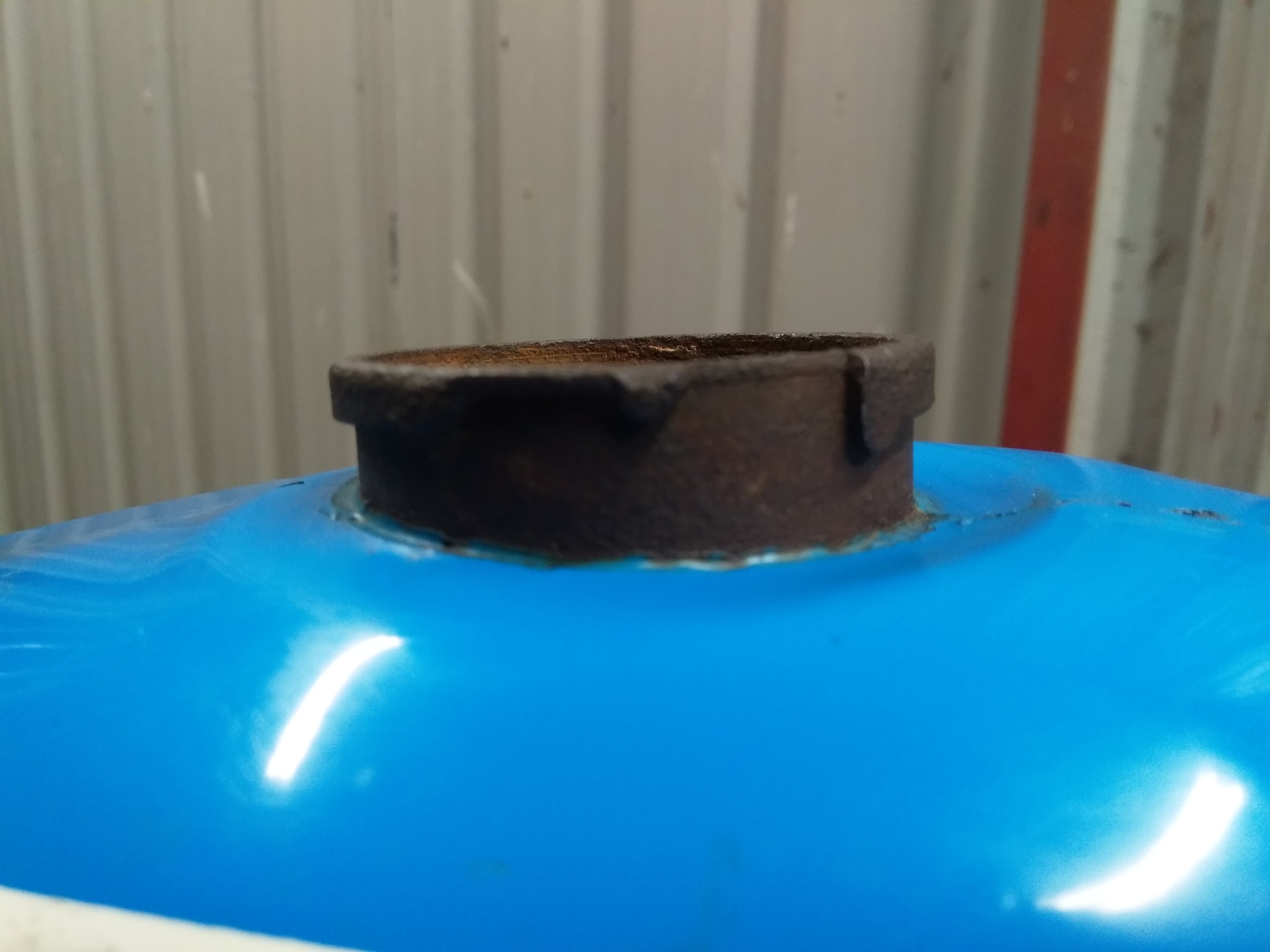

bill black Posted January 22, 2019 Report Share Posted January 22, 2019 Hello all , A couple of questions for the gurus , I have a 199A that I am rebuilding , I was hoping for some help with parts that I need , and itit was a box of bits kind of purchase I am missing the two handlebar clamps any chance someone has a source for these ? Also my tank is a Sammy Miller aftermarket one and the cap Is missing it's an odd one its kind of like an old radiator cap it has half twist to lock action with ears catching the spout in the tank here's s pic Regards Bill Quote Link to comment Share on other sites More sharing options...
lorenzo Posted January 22, 2019 Report Share Posted January 22, 2019 (edited) Bill - (I am assuming that this tank is fi-glass) By my (somewhat shaky) memory, I think the Miller tanks used a "Ceandess" bayonet fit cap, of this type :- www.feked.com/2-vented-petrol-or-oil-tank-filler-cap-chrome-plated.html Not sure of the size, you must measure. Feked.com took over the Sammy Miller Products brand a while ago. Hope this helps - good luck with the rebuild ..... Edited January 23, 2019 by lorenzo Add. link Quote Link to comment Share on other sites More sharing options...
bill black Posted January 23, 2019 Author Report Share Posted January 23, 2019 Brilliant Lorenzo ? thanks I'll measure mine and see if that's a match , I am wondering if the grade of fibreglass resin used will survive ethanol in the petrol in this tank ..... ? Has anyone any thoughts ? Quote Link to comment Share on other sites More sharing options...
johnjsy Posted January 23, 2019 Report Share Posted January 23, 2019 Hi Bill, I have sealed several fibreglass tanks with success using Slosh from Draganfly Motorcycles. It is a job best done in the summer when you can be sure the inside of the tank is bone dry. I use caustic soda to clean out any muck and residue of oil that may be left. I do this several times then be sure to rinse out with lots of hot water each time. Be extra careful, it is nasty stuff. Keep any youngsters and animals well away ! Done slowly and carefully sealing your tank will be fine. Hope this helps....... Quote Link to comment Share on other sites More sharing options...
bill black Posted January 24, 2019 Author Report Share Posted January 24, 2019 Thanks johnjsy, I'd like to try reuse the tank as it's in good nick , for the minute I might fill and drain it as and when I need to use it .... Then sort it in the summer , I'm not too far from firing it up soon so I'll post more pics when it's progressed more Regards Bill Quote Link to comment Share on other sites More sharing options...

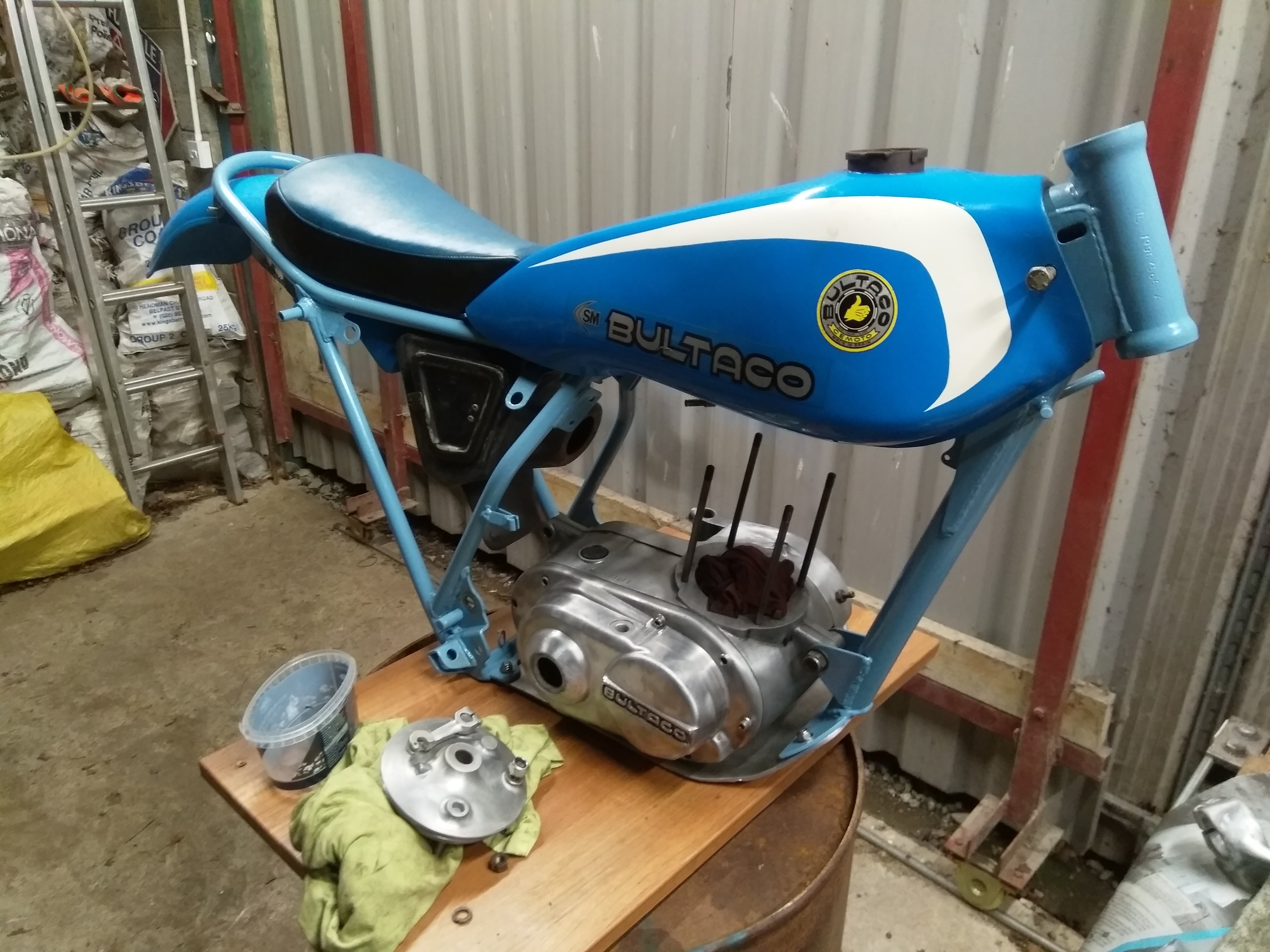

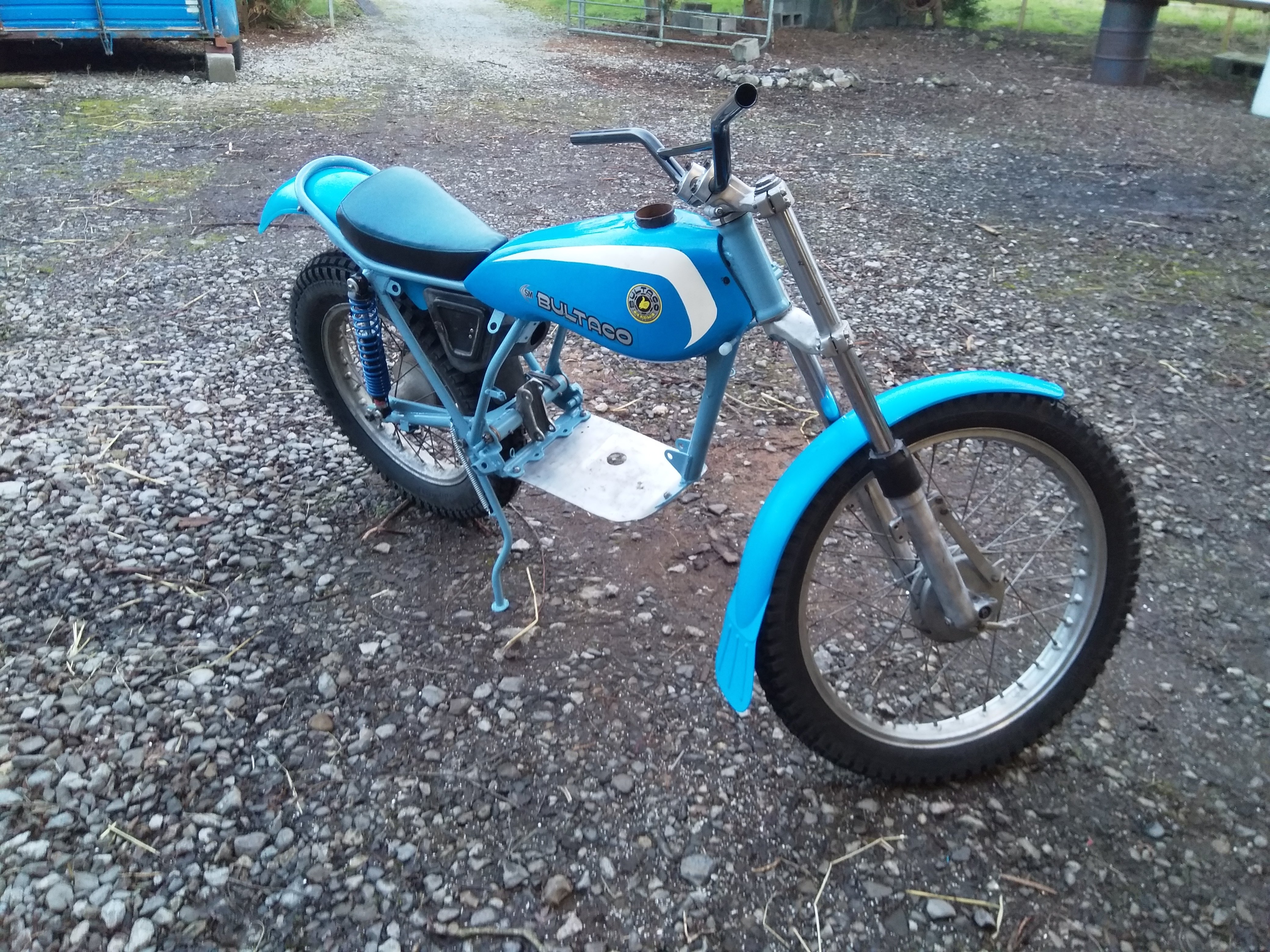

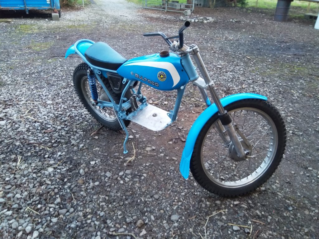

bill black Posted February 8, 2019 Author Report Share Posted February 8, 2019 Back on two wheels again it's nice to be putting it together once more ..... 2 Quote Link to comment Share on other sites More sharing options...

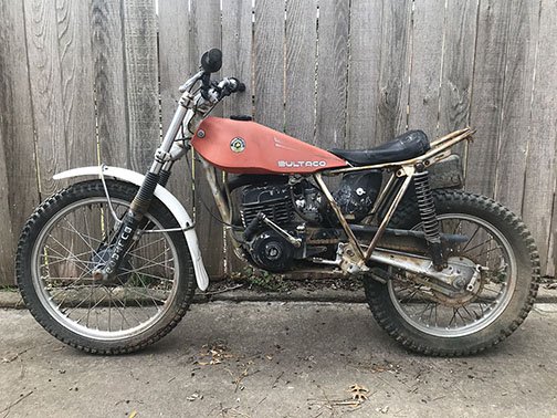

robbiesty175 Posted February 9, 2019 Report Share Posted February 9, 2019 You have inspired me to bring my 199a back to life as well!!! More photos to come, as it gets pretty! Quote Link to comment Share on other sites More sharing options...

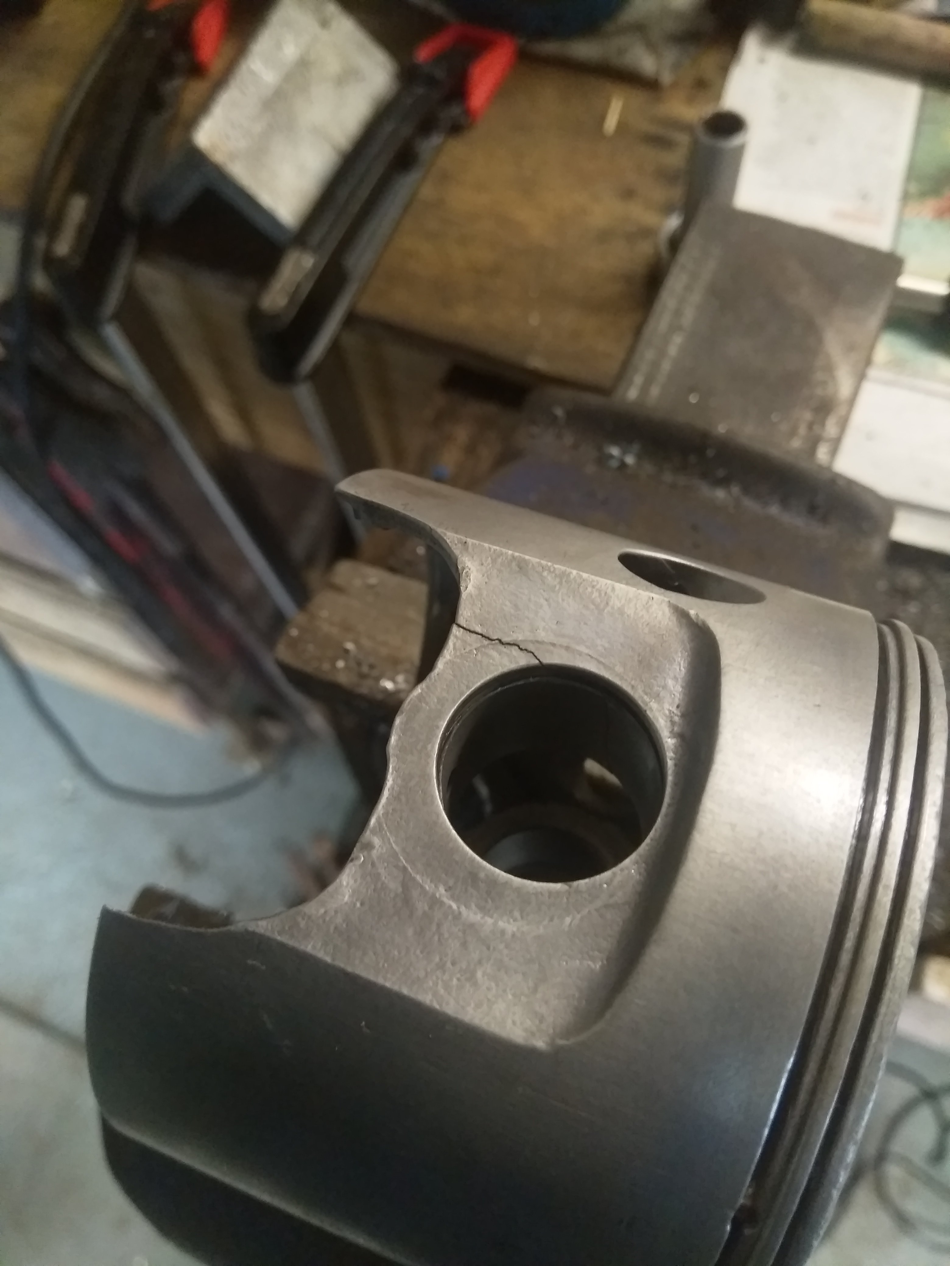

bill black Posted February 10, 2019 Author Report Share Posted February 10, 2019 Ahh rats so much for the "saved" piston it cracked as I was putting the gudgeon pin in ? 2 Quote Link to comment Share on other sites More sharing options...
section swept Posted February 11, 2019 Report Share Posted February 11, 2019 10 hours ago, bill black said: Ahh rats so much for the "saved" piston it cracked as I was putting the gudgeon pin in ? Better that it cracked now rather than later on when you run the engine. Quote Link to comment Share on other sites More sharing options...
section swept Posted February 11, 2019 Report Share Posted February 11, 2019 (edited) That kind of damage usually indicates....apart from external forces....con-rod misalignment? Edited February 11, 2019 by section swept Quote Link to comment Share on other sites More sharing options...
bill black Posted February 11, 2019 Author Report Share Posted February 11, 2019 No it was my own stupid fault I was holding it in my hand as I was tapping the gudgeon pin in with a small hide faced hammer and it had gone slightly skew ways it had snagged the circlip groove and next thing I looked and saw the crack ? at least I have a spare engine to get some bits from ..... Quote Link to comment Share on other sites More sharing options...
