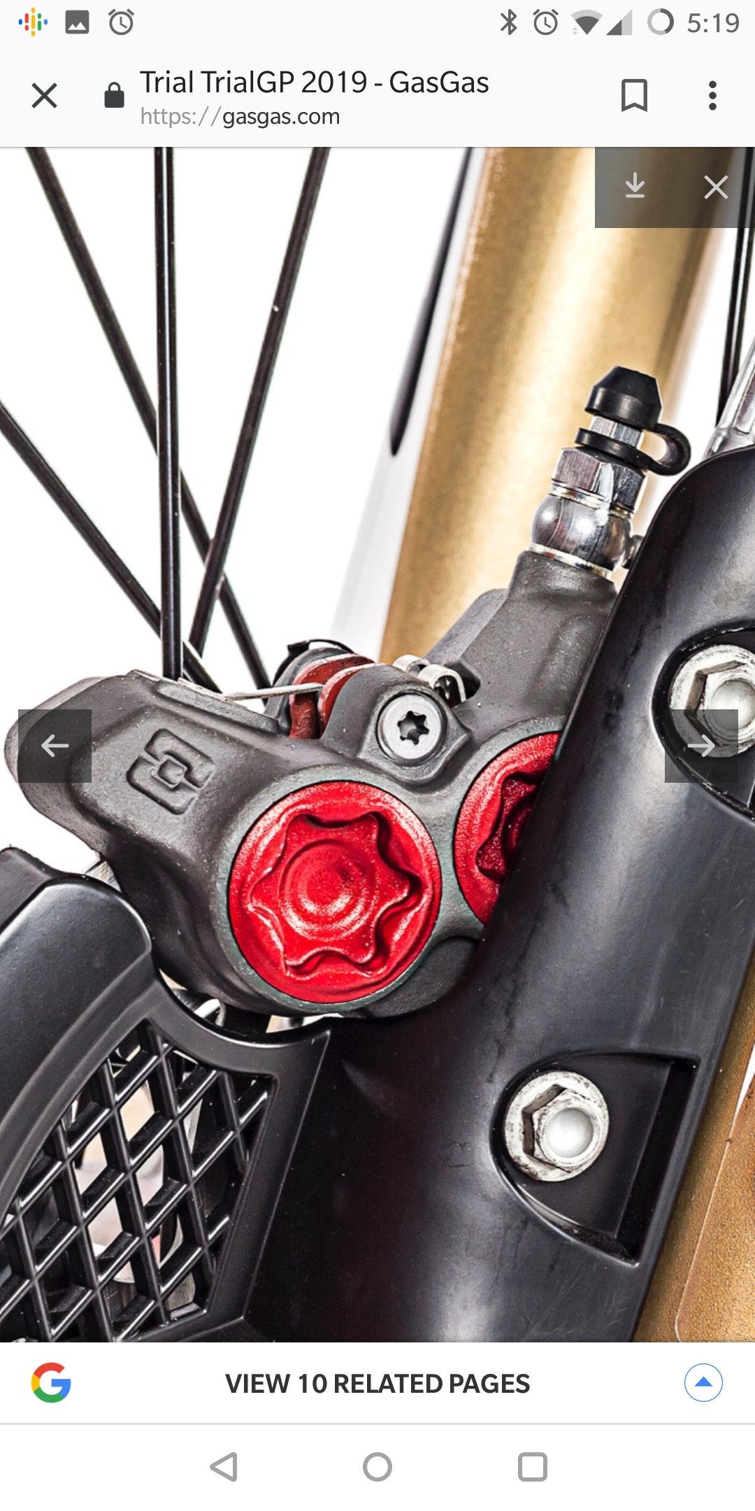

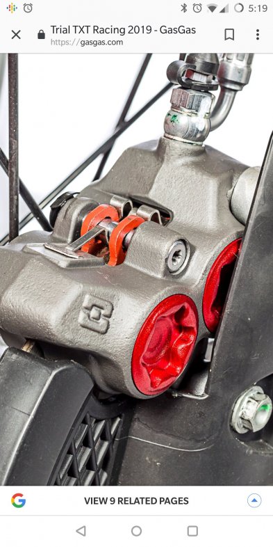

heffergm Posted January 23, 2019 Report Share Posted January 23, 2019 Racing and GP. It's the new Braktec monobloc on both, no idea if it's the same as the TRS. Quote Link to comment Share on other sites More sharing options...
crashmonkey Posted January 23, 2019 Report Share Posted January 23, 2019 Same as TRS RR but not the TRS Gold, think they are billet titanium or something. Quote Link to comment Share on other sites More sharing options...

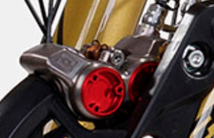

oni nou Posted January 23, 2019 Report Share Posted January 23, 2019 (edited) On 1/23/2019 at 12:30 PM, crashmonkey said: Same as TRS RR but not the TRS Gold, think they are billet titanium or something. Expand Its a good job its not or it would double the price of the bike ............I think it may be Kryptonite .....anyway its called the Evo 17 caliper as a model designation........ the mono bloc in the pictures put up by heffergm of the 2019 GasGas show the old style standard mono bloc caliper .....this is not the same as the one fitted to the TRS Gold .......The 'Evo17 caliper has different screw in piston 'caps' ......as in the key shape for the removal tool is different than the TORX like caps that are shown in the picture. it is CNC machined more rigid lighter blah blah blah blah ......" Free to those that can afford it and very expensive to those that can't". Edited January 23, 2019 by oni nou 1 Quote Link to comment Share on other sites More sharing options...
heffergm Posted January 23, 2019 Report Share Posted January 23, 2019 This is the TRS Gold caliper: 1 Quote Link to comment Share on other sites More sharing options...
