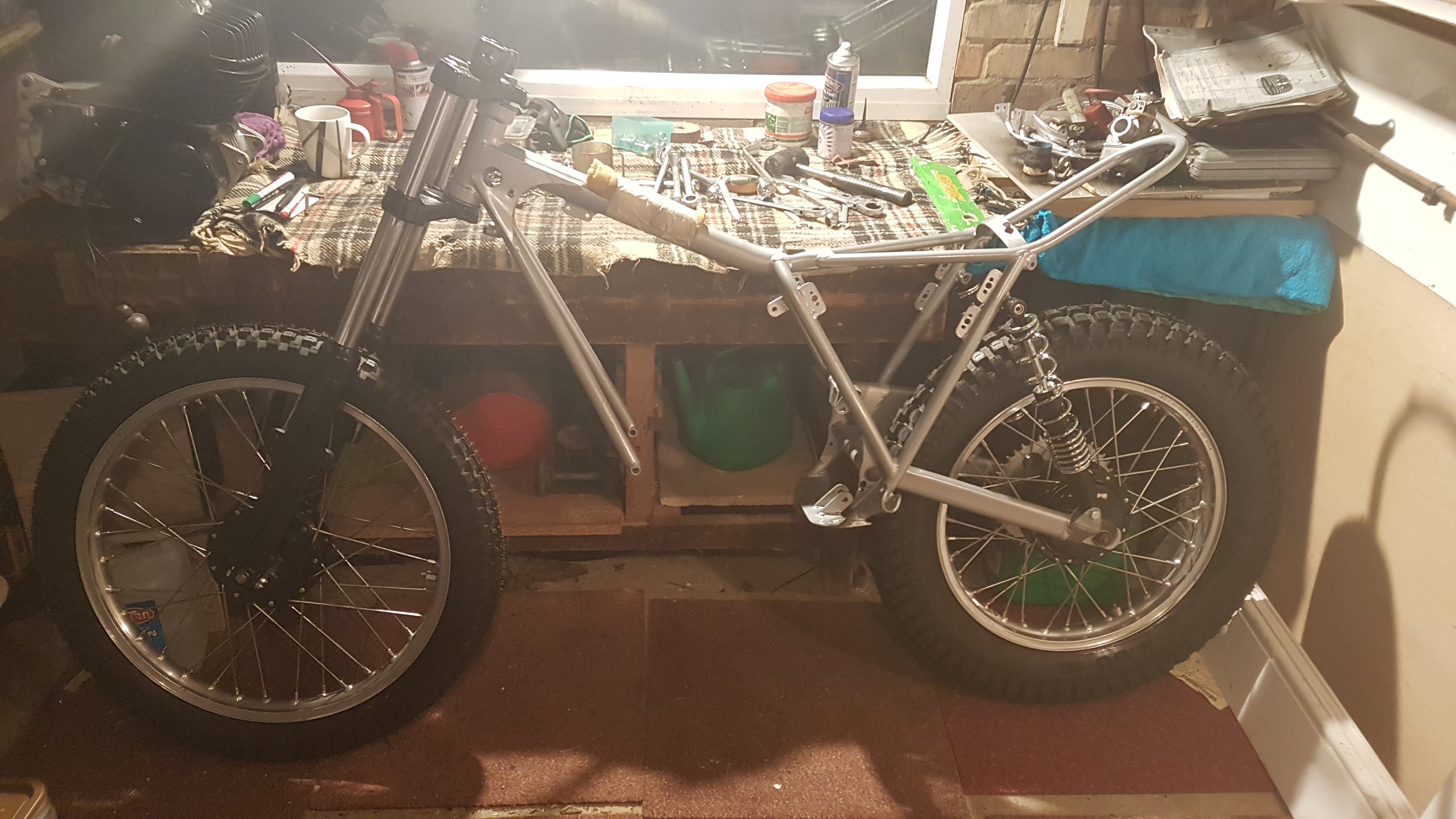

Thanks Woody, I have looked at the headstock and there is no sign of any stamped numbers. I know I am the second owner of the bike as I got it from Windsor comp shop back in 1979 but have lost the  registration document.
 The engine is the original unit and has not been changed, do you know of any way of confirming the year so I can apply to re-register.

No. it's not an Ossa frame, it's a close likeness but there are a few differences.  It would explain the lack of frame number
It could be a modified Whitlock frame as he made some for the earlier MK1 bikes.The footrest hangers look very much Whitlock. There are other likenesses with a Whitlock frame but then there are differences too  -  sidepanel mounts, additional mount for headsteady (maybe)  top shock position moved, bottom shock mounts changed, Swingarm spindle slot is normally open ended on the Whitlock frame.  Whitlock frames were nickel (or chrome, not sure) plated as yours is undernneath
Miller didn't sell an Ossa frame but Cheney did although it doesn't look like a Cheney.
I'd guess at modified Whitlock but not sure
Link to comment
Only bad if you're bothered about originality I guess. The Whitlock frames were said to be good frames, lighter than the Ossa frame. I've never had one so don't know.
I'm reasonably sure it's a Whitlock from what I can see, but not sure about the swingarm as it doesn't look like the Whitlock one, but it could have been altered as well
I take it you can't remember the reg number, if not and you're certain of the history of the bike, I'm assuming it would have been registered using the original frame, so you should be ok filling the V62 out and applying for the V5 using the frame number
Link to comment

I'm reasonably sure it's a Whitlock frame but another thing that is missing is the rear brake pedal mount as that was located just behind the left hand footrest as the Whitlock didn't have the same brake spindle arrangement as the Ossa frame

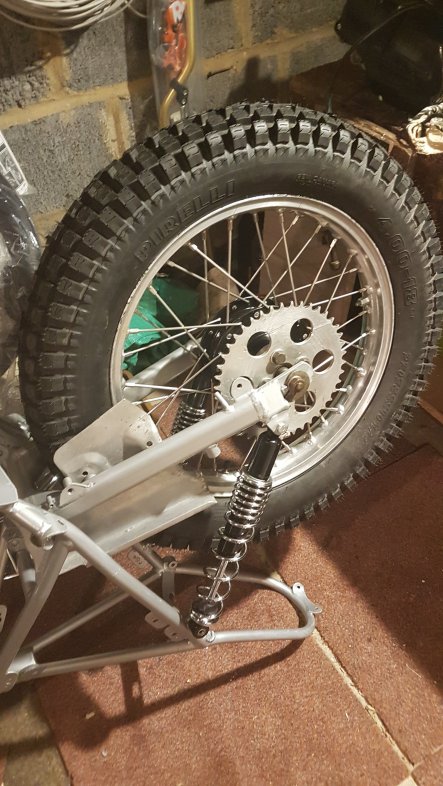

I think the swingarm is either modified or a replacement. The bottom shock mounts are the wrong type and their positioning is wrong. The Whitlock frame was made for upright shocks as on the MK1 and MK2 MAR and the s/arm mount was just about in line with the front edge of the rear hub, the same location as the MK1 and 2 MAR frame, although the MK1 had a 1 1/4"  shorter arm than the MK2.
On the TR77 they went back to a short swingarm like the MK1 but put the shock mount right over the spindle. On yours the shock mount is further forward than a TR77 Ossa arm which is why the arm is pushed down at such an angle. This has left the shock angle somewhere between that of an earlier MAR and the TR77 and a steeper angle on the forks with the raised back end, the mounts need to be over the spindle to match the top mount and put the shock angle right.
