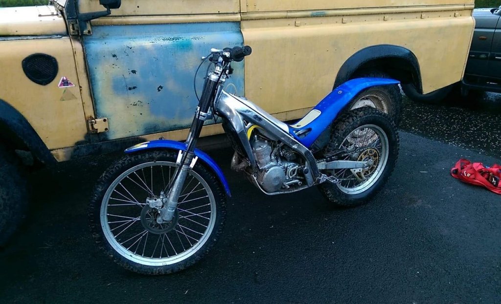

blakep82 Posted February 2, 2019 Report Share Posted February 2, 2019 Hi, seems to the the done thing to write some sort of intro, so, I bought my first trials bike a few weeks ago, a GasGas txt 321 (1999) needs a few things doing to it, but i've never had a bike before, so unfortunately for you lot, lots of probably really stupid questions will be coming! first one would be, I've got to fit a rubber tensioner block, can it be done without splitting the chain (no chain splitting tool, no idea what chain it is, how to measure its pitch, or know what new master links to buy) wish me luck lol Blake Quote Link to comment Share on other sites More sharing options...
Bilko Posted February 3, 2019 Report Share Posted February 3, 2019 Looking at the pic looks like you need a new chain with the slack even without the tensioner,but as for fitting without splitting chain are you sure there is not a split link.there are 2 types of pads 1 open and 1 where you would have too split the chain and feed through it.As for chain size should be 520.pitch Quote Link to comment Share on other sites More sharing options...
peterb Posted February 3, 2019 Report Share Posted February 3, 2019 Looks like a LWB Series III Land Rover holding the bike up. Good bikes those 321's, grunty motor, not much goes wrong. You don't need to buy a new master link, just undo the spring link and re-fit with pliers, closed end of the spring facing direction of chain travel going forwards. Keep the air filter clean, clean out the air filter box, they don't seal very well so water does get in, strip the carb and blow out all the passage ways and re-assemble. Needle is a D36, clip position 2nd from bottom, pilot screw set from 3 1/2 turns out from fully in, as a starting point. Out to richen, in to lean. You don't need a Gas Gas specific chain pad, most blocks will fit from other trial bikes, check the bolt hole distance between centres. Change the gearbox/clutch oil, it says 700mL on the casing but 650mL is fine, I always have used ATF rated to Dexron III as my preferred oil for well over 20 years, it's cheap and it works well, others have their own opinions. Great bike in it's day, not so easy to find wheel grip in the mud, a good Scottish bike. Bye, Peter B. Quote Link to comment Share on other sites More sharing options...
blakep82 Posted February 3, 2019 Author Report Share Posted February 3, 2019 (edited) 8 hours ago, Bilko said: Looking at the pic looks like you need a new chain with the slack even without the tensioner,but as for fitting without splitting chain are you sure there is not a split link.there are 2 types of pads 1 open and 1 where you would have too split the chain and feed through it.As for chain size should be 520.pitch Thanks Bilko, you may well be right, never had a bike before so i dont really know what the tolerances are. At the momeng, im far from a pto, and still witking on my balance so this chain will do for now, but ill be looking soon to get a new chain and sprockets. Any recommendations on manufacturers? I had a look for a split link last night, couldn't see one, but couldn't really get round the bike properly to see. Very full garage. I'll try again today Thanks! Edited February 3, 2019 by blakep82 Quote Link to comment Share on other sites More sharing options...
blakep82 Posted February 3, 2019 Author Report Share Posted February 3, 2019 7 hours ago, peterb said: Looks like a LWB Series III Land Rover holding the bike up. Good bikes those 321's, grunty motor, not much goes wrong. You don't need to buy a new master link, just undo the spring link and re-fit with pliers, closed end of the spring facing direction of chain travel going forwards. Keep the air filter clean, clean out the air filter box, they don't seal very well so water does get in, strip the carb and blow out all the passage ways and re-assemble. Needle is a D36, clip position 2nd from bottom, pilot screw set from 3 1/2 turns out from fully in, as a starting point. Out to richen, in to lean. You don't need a Gas Gas specific chain pad, most blocks will fit from other trial bikes, check the bolt hole distance between centres. Change the gearbox/clutch oil, it says 700mL on the casing but 650mL is fine, I always have used ATF rated to Dexron III as my preferred oil for well over 20 years, it's cheap and it works well, others have their own opinions. Great bike in it's day, not so easy to find wheel grip in the mud, a good Scottish bike. Bye, Peter B. Indeed it is! 1973 series 3, love it I looked for a spring link last night, couldn't see one, but could only really see one side of the chain, where it's sitting. I've got another car in he garage and old stock car, so not much space! Some good tips there, thank you! I've got it starting and running fine, but the cleaning out of the carb is definitely on the list, as is a decent service, so some good tips there, thank you Quote Link to comment Share on other sites More sharing options...
blakep82 Posted February 3, 2019 Author Report Share Posted February 3, 2019 I ended up doing a temporary job for now by cutting down the side of the block to slip it over the chain, then immediately found the split link. Oh well! 1 Quote Link to comment Share on other sites More sharing options...
