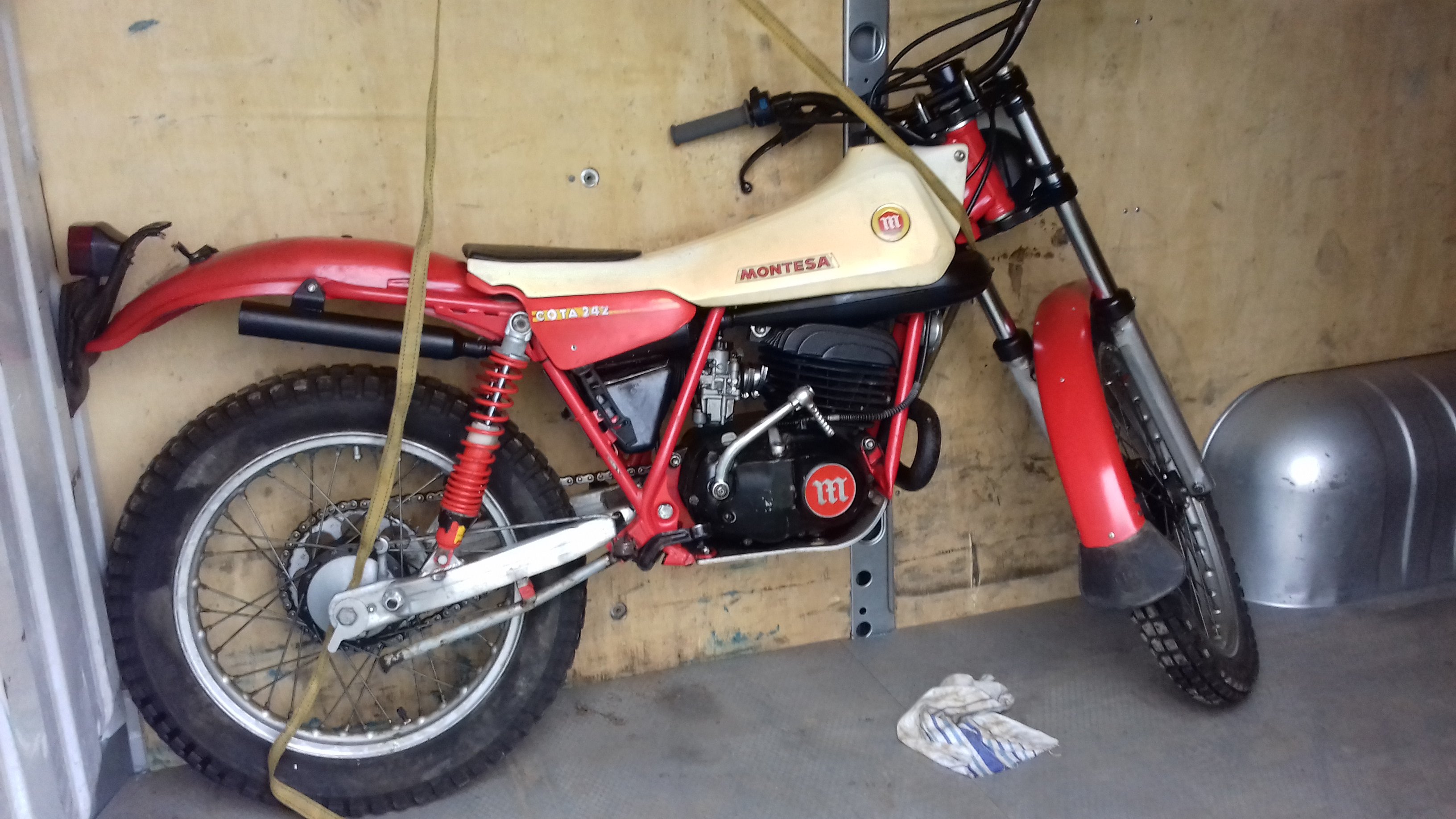

rustyrider Posted February 3, 2019 Report Share Posted February 3, 2019 Hi, recently purchased a 242 but I find the petrol tank doesn't fit that well around the rear shock absorbers, it's an original white plastic tank not fibreglass, has any of you had this problem?? when I put the long bolt in through the front of the tank and pivot the tank down to its proper seating position on the frame it fouls the rear shocks, the bike is totally original never trialed having spent its life in the warm Italian sun Quote Link to comment Share on other sites More sharing options...
ikb Posted February 3, 2019 Report Share Posted February 3, 2019 Mine has an eccentric steel boss where the front bolt goes through allowing some adjustment. Quote Link to comment Share on other sites More sharing options...
pschrauber Posted February 3, 2019 Report Share Posted February 3, 2019 Yes mine have the little excentric bolt too and this is a problem since the bike was designed the upper "Eyes" of the shock do rub to your legs. 1 Quote Link to comment Share on other sites More sharing options...

rustyrider Posted February 4, 2019 Author Report Share Posted February 4, 2019 Thanks for your replies, will check the front mount for the eccentric bosses? Quote Link to comment Share on other sites More sharing options...
