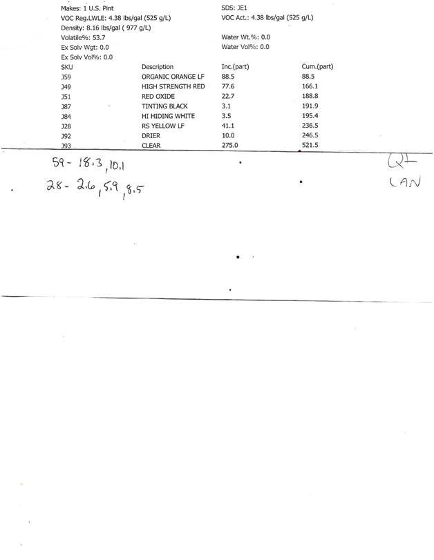

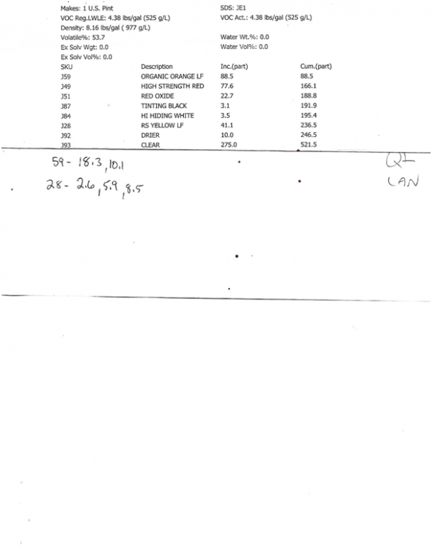

nh014 Posted February 6, 2019 Report Share Posted February 6, 2019 Here is an exact match from an auto paint specialist using PPG paints. Quote Link to comment Share on other sites More sharing options...
barnesy Posted February 6, 2019 Author Report Share Posted February 6, 2019 That's great thanks for your advice .. Quote Link to comment Share on other sites More sharing options...
