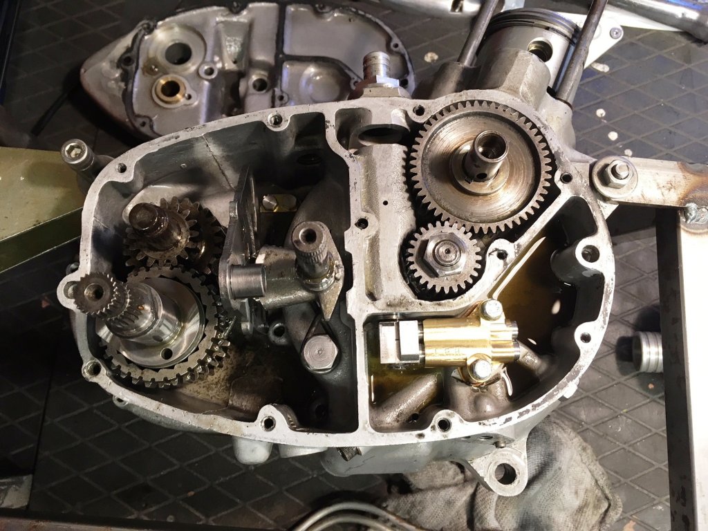

freelander andy Posted February 9, 2019 Report Share Posted February 9, 2019 hi got a twin bearing tiger cub crankcase I want to fit a later block oil pump do need to get the case machined or just strait swop Quote Link to comment Share on other sites More sharing options...
brucey Posted February 10, 2019 Report Share Posted February 10, 2019 (edited) Depends upon how late you crank cases are. The chances are yes if you are replacing an older type pump. Chris at Meriden off road can advise either way as he does a conversion kit and can also machine the case if required. Photo shows later pump fitted. Web on left of pump has to be machined to clear pump slider blocks. You also need a longer drive spindle to run the later type pump. These all add up! I also just put an upgraded Morgo standard pump in one of my Cubs which has worked fine for the past 10 years. Hope this helps. Bruce Edited February 10, 2019 by brucey 1 Quote Link to comment Share on other sites More sharing options...
freelander andy Posted February 10, 2019 Author Report Share Posted February 10, 2019 thank you the engine come to me in bits on the left side case says m all got old type pumps. also crank has wear on oil feed stub crank going to box it up and send it to Chris now yes it a cost me on your engine can see the webbing needs to be machined Quote Link to comment Share on other sites More sharing options...
section swept Posted February 10, 2019 Report Share Posted February 10, 2019 47 minutes ago, brucey said: Depends upon how late you crank cases are. The chances are yes if you are replacing an older type pump. Chris at Meriden off road can advise either way as he does a conversion kit and can also machine the case if required. Photo shows later pump fitted. Web on left of pump has to be machined to clear pump slider blocks. You also need a longer drive spindle to run the later type pump. These all add up! I also just put an upgraded Morgo standard pump in one of my Cubs which has worked fine for the past 10 years. Hope this helps. Bruce Like a little sweet watch, how good does that pump look?? 3 1 Quote Link to comment Share on other sites More sharing options...
brucey Posted February 10, 2019 Report Share Posted February 10, 2019 5 hours ago, section swept said: Like a little sweet watch, how good does that pump look?? Err, yup.....I have to admit, I got a bit carried away after that! 1 1 Quote Link to comment Share on other sites More sharing options...
