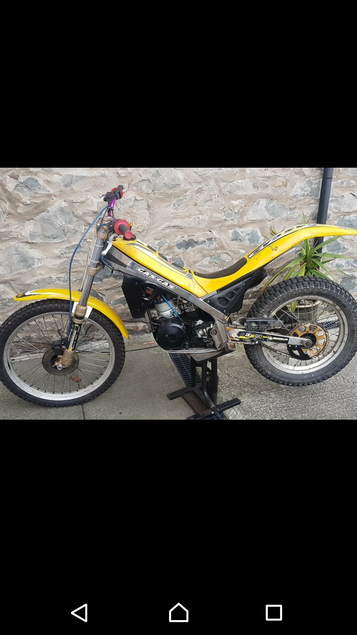

Bunglebmx Posted February 10, 2019 Report Share Posted February 10, 2019 Hi guys. Just bought a 1994 125 in good faith. Got it home. Noticed it wouldn't idle. Cleaned jets. Sorted. Left it running and coolant was spilling out from the filler cap. So the fan isn't running. Also there is a rattle from the engine, and it won't select the gears, I'm thinking this is linked to the rattle. Any advice would be great. can I buy repair and service manuals? Thanks. Paul Quote Link to comment Share on other sites More sharing options...
section swept Posted February 10, 2019 Report Share Posted February 10, 2019 (edited) Whose good faith eh! Engine noise is it rythmic with piston speed, does it go with increased revs, any difference with clutch pulled in? These and many other questions will be the order of the day to help you sort out the tedious side of “yeah it runs fine mate”?Check oil in transmission case and g/box. Locate coolant temp sensor and bridge wires together with engine running, if fan runs its the sensor needs replacing or leave wires joined and fan running all the time. You really need to use coolant mix as plain water will not be ideal, the anti-freeze raises the boiling point of water so you get more cooling range from the same quantity of coolant.?? Edited February 10, 2019 by section swept Quote Link to comment Share on other sites More sharing options...
Bunglebmx Posted February 10, 2019 Author Report Share Posted February 10, 2019 It is rhythmic with the piston. And it's the same with the clutch in. Sounds like it's coming from somewhere near the gear shaft area. Oil change first then clutch to be looked at. Thanks. Paul Quote Link to comment Share on other sites More sharing options...

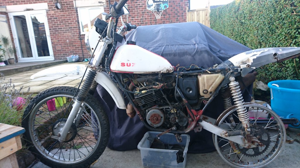

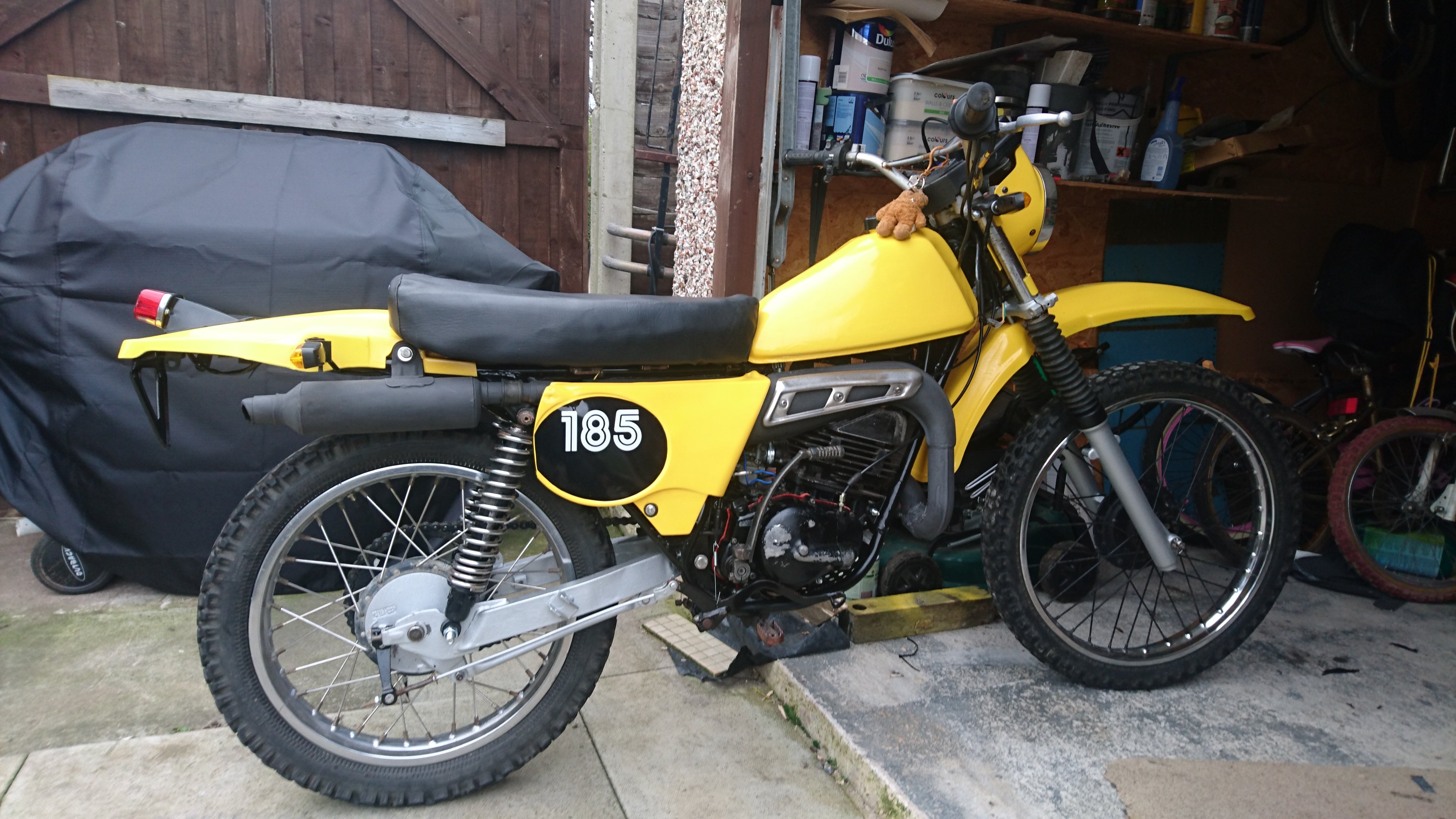

Bunglebmx Posted February 10, 2019 Author Report Share Posted February 10, 2019 I just had a look. The 93 seems to be, more like it. It's not that I really like the bike. I have had it a week and the only chance I had to look at it was today. And it seems to be a little bit broke. Simply looking to find out how I can fix it. I'm hoping that the more advice I get, the easier it will be for me to sort the problems out. Im not brilliant with these things. But will have a go. I recently restored a 1979 ts185er. But a totaly different bike. Being air cooled. Quote Link to comment Share on other sites More sharing options...
Bunglebmx Posted February 10, 2019 Author Report Share Posted February 10, 2019 It was a total wreck Quote Link to comment Share on other sites More sharing options...
