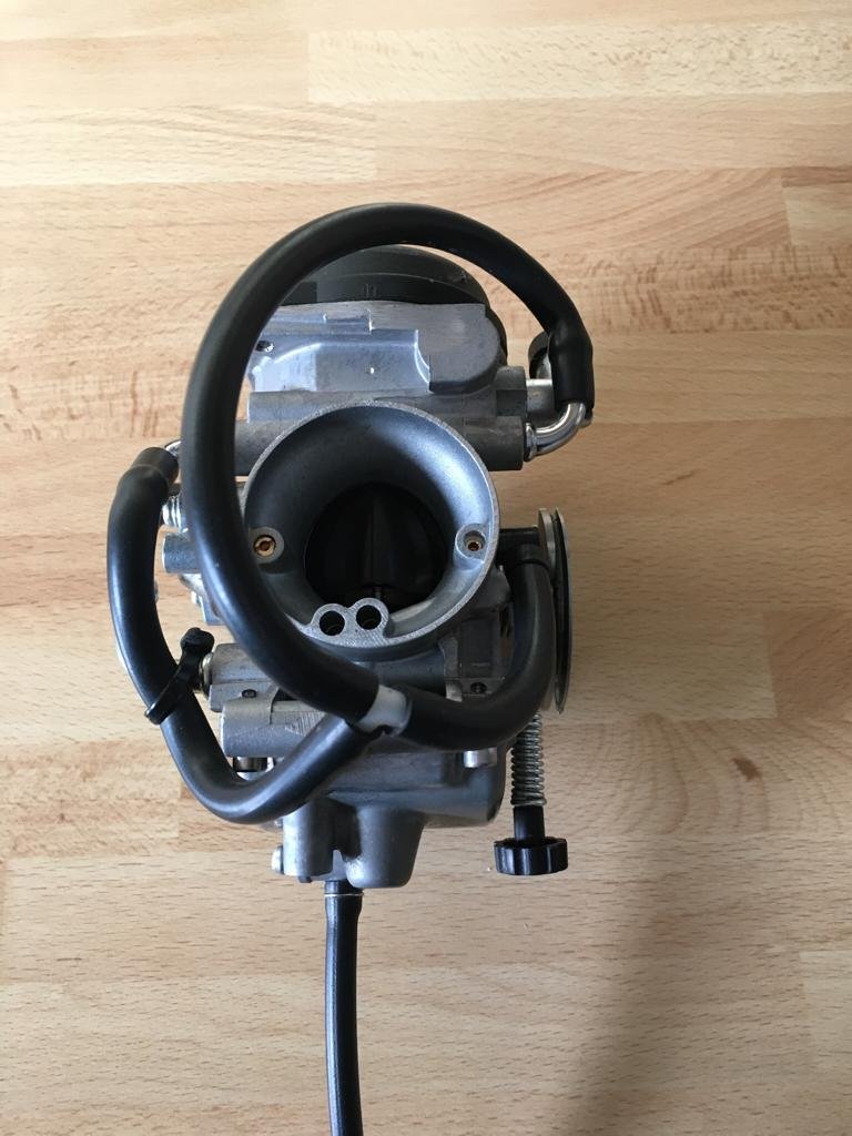

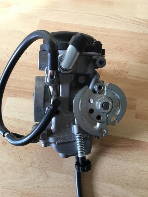

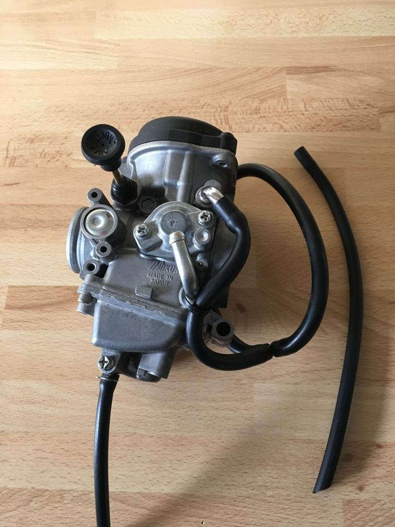

Davidstewart123 Posted February 12, 2019 Report Share Posted February 12, 2019 Can't find where this pipe goes Quote Link to comment Share on other sites More sharing options...

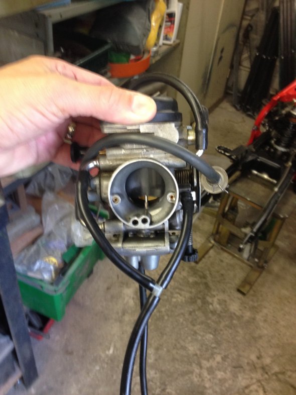

thall1 Posted February 12, 2019 Report Share Posted February 12, 2019 Is it off a beta 4t?.. If so look on the beta forum and there are clear pictures and references...here's a picture of mine that I posted last year.. 1 Quote Link to comment Share on other sites More sharing options...
Davidstewart123 Posted February 12, 2019 Author Report Share Posted February 12, 2019 Yes it's beta 4st 19 thanks Quote Link to comment Share on other sites More sharing options...
thall1 Posted February 12, 2019 Report Share Posted February 12, 2019 Top right tube vents to atmosphere around the top front of the carb. The 'Y' piece vents to the around the bottom of the rear shock. The peice you have left over is the bottom of the 'Y' 1 Quote Link to comment Share on other sites More sharing options...
