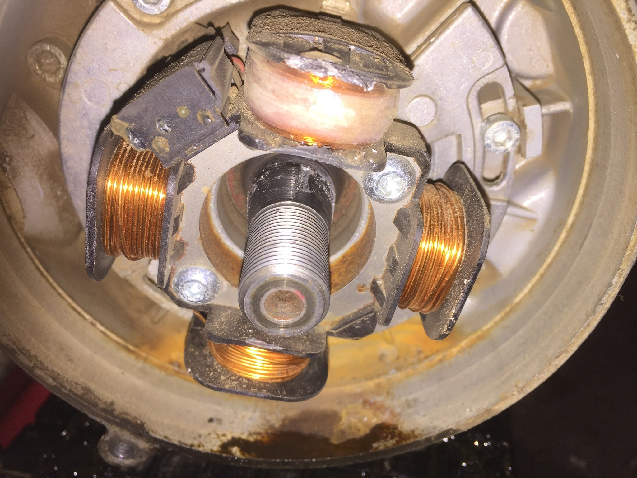

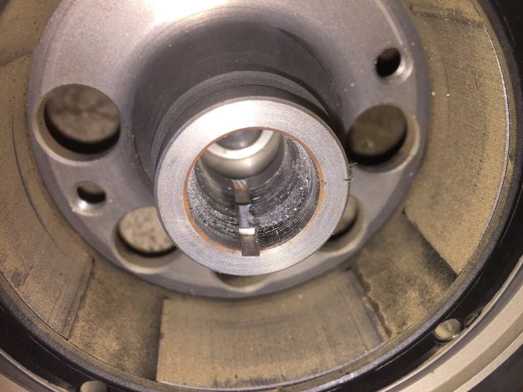

Big Timbob Posted February 19, 2019 Author Report Share Posted February 19, 2019 The puller arrived, found this lil blighter!! Quote Link to comment Share on other sites More sharing options...

dan williams Posted February 25, 2019 Report Share Posted February 25, 2019 The sheared woodruff key is very common in these situations. Having the primary gear spin off is not something I’ve heard before. Learn something new every day. ? Quote Link to comment Share on other sites More sharing options...
Big Timbob Posted February 26, 2019 Author Report Share Posted February 26, 2019 She’s back up and running! New piston, rings, small end, reeds while I was in there, throttle cable after your advice on here and of course a woodruff key. Started second kick and ticked over nicely until my wife charged in and told me it was too late for that nonsense. ? Hopefully she’ll be right for a bit now. Thsnks everyone! Quote Link to comment Share on other sites More sharing options...
