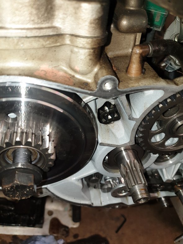

Sip77 Posted February 24, 2019 Report Share Posted February 24, 2019 Anybody know if this hole is meant to be here? Doesn't look like it to me? will it be a problem or will it need sorting? Quote Link to comment Share on other sites More sharing options...
technowaldo Posted February 25, 2019 Report Share Posted February 25, 2019 Think it’s just part of the casting if there’s no aluminium debris in the oil just forget about it Quote Link to comment Share on other sites More sharing options...
Sip77 Posted February 25, 2019 Author Report Share Posted February 25, 2019 The oil was a grey green colour but not seen any debris. I'll stick it back together and change oil again see what it looks like. Thanks. Quote Link to comment Share on other sites More sharing options...
the dabster Posted February 25, 2019 Report Share Posted February 25, 2019 Gasgas is identical it allows the oil to transfer through clutch back to gearbox in the gasser never seen the inside of a beta but would imagine identical role unless I'm wrong of course! It's a pretty big coincidence I think it's meant to be there. Quote Link to comment Share on other sites More sharing options...
markparrish Posted February 25, 2019 Report Share Posted February 25, 2019 Yes - I thought that when I saw a similar hole in my Rev 3!! - It appears to be deliberate, but has a very rough and broken "aesthetic"! - maybe they do it during the casting phase? Quote Link to comment Share on other sites More sharing options...
Sip77 Posted February 25, 2019 Author Report Share Posted February 25, 2019 Thanks guys that's put my mind at rest. I'll get new crank seals in this week and see how she goes.? Quote Link to comment Share on other sites More sharing options...
dan williams Posted February 25, 2019 Report Share Posted February 25, 2019 If you look at the 2017-2018 engine service manual it looks like these are intentional oil passages. https://www.betausa.com/sites/default/files/pdf/trialsservicemanuals/2017-2018 Evo 2 stroke engine service manual .pdf Quote Link to comment Share on other sites More sharing options...
dan williams Posted February 25, 2019 Report Share Posted February 25, 2019 Would be nice if they didn’t look like they were hogged out with a hammer and chisel. Quote Link to comment Share on other sites More sharing options...
billyt Posted February 26, 2019 Report Share Posted February 26, 2019 (edited) SIP (SNP?) What year is the Beta? If the gasket has a corresponding hole then it was that way from the factory. I think it may be a dowel pin hole for aligning the first outer case! If so then you are missing dowel pin.... Is it hollow? The picture is fuzzy it even looks like the head of a screw has broken off. Does the matching case cover have a locating hole also? Edited February 26, 2019 by billyt Quote Link to comment Share on other sites More sharing options...
collyolly Posted February 26, 2019 Report Share Posted February 26, 2019 billyt, I think he is looking at the big hole through to the gearbox,( you can see the gears), you are looking at the fixing hole on the gasket line ? Quote Link to comment Share on other sites More sharing options...
billyt Posted February 26, 2019 Report Share Posted February 26, 2019 Collyolly oops I see it now DUH my bad. Quote Link to comment Share on other sites More sharing options...
Sip77 Posted February 26, 2019 Author Report Share Posted February 26, 2019 Yes it's the big hole. The casing feels very thin around the hole and it is rough around the edges. Like it's been hit with a hammer. Maybe an end of day casing when the tools have been dropped! Quote Link to comment Share on other sites More sharing options...
