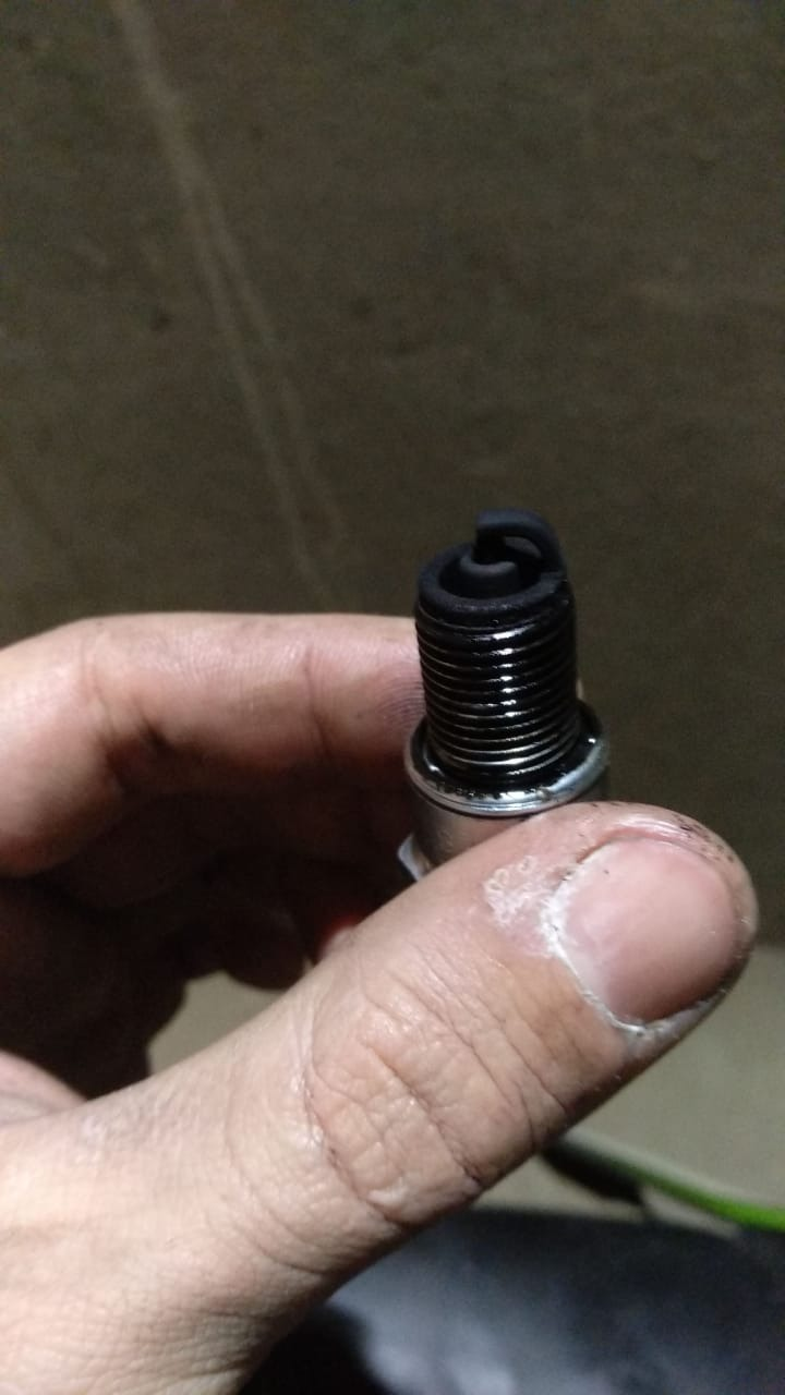

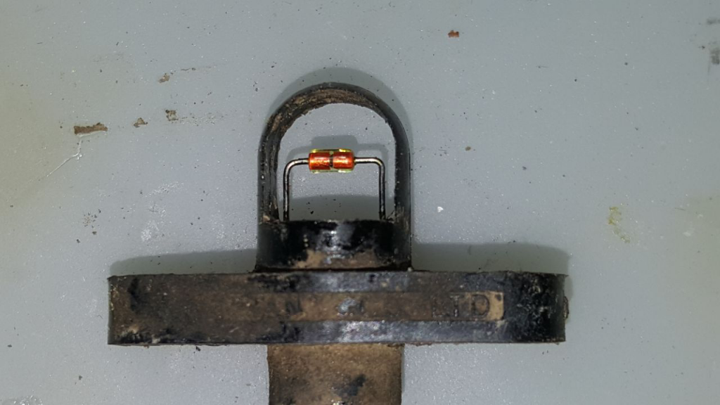

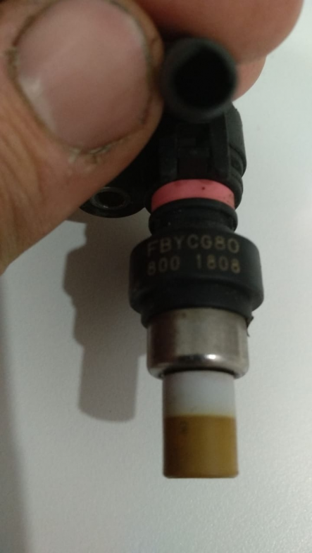

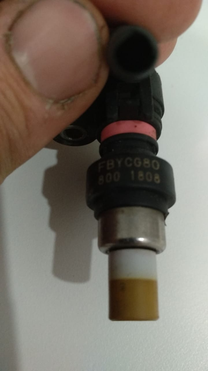

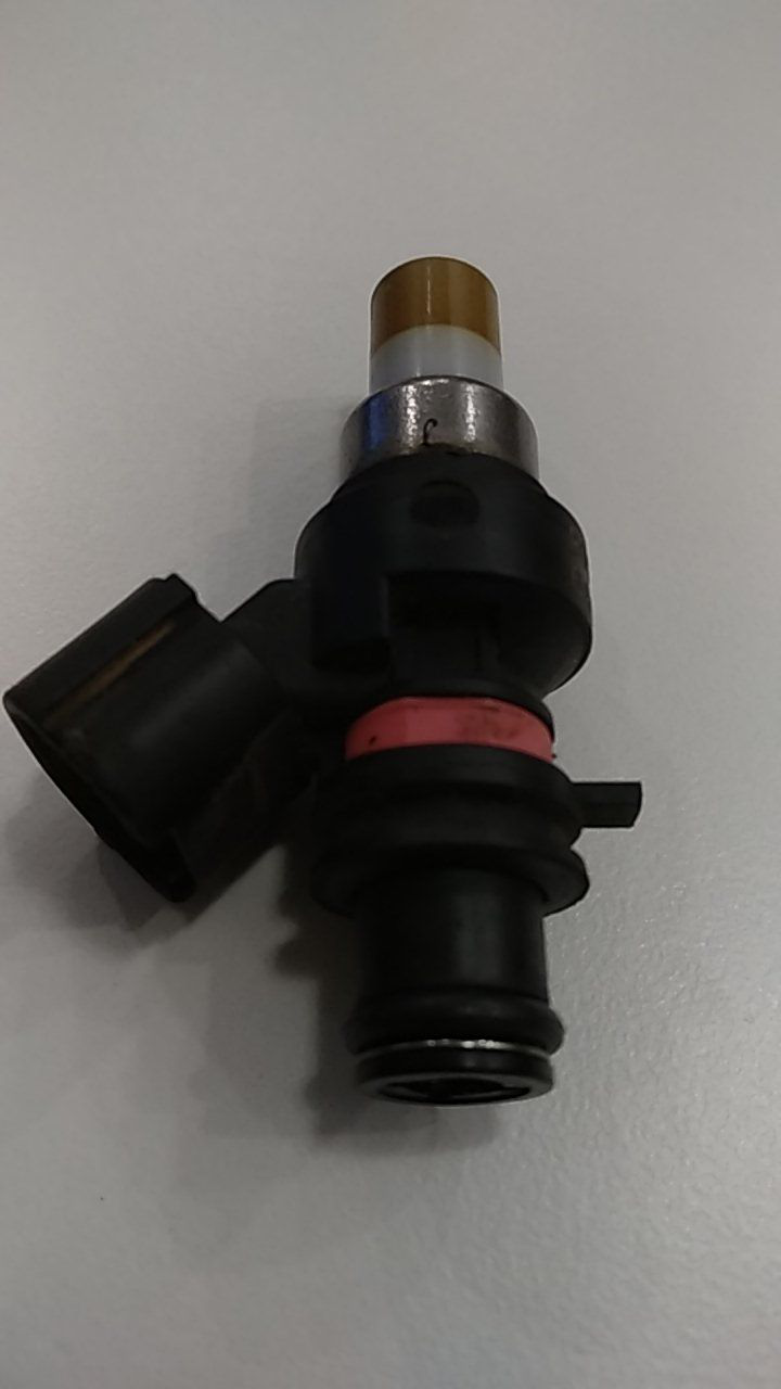

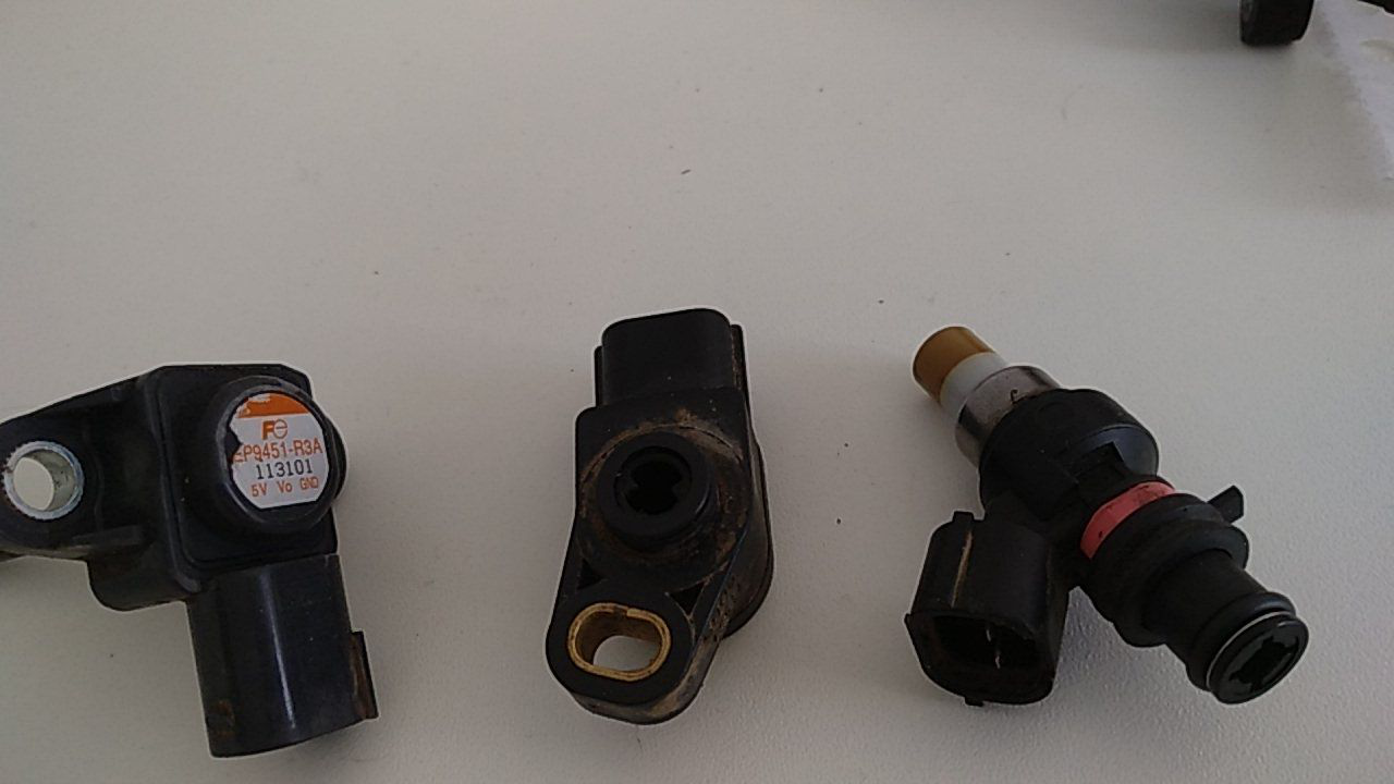

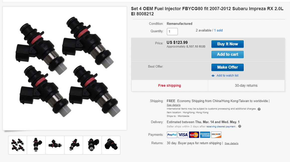

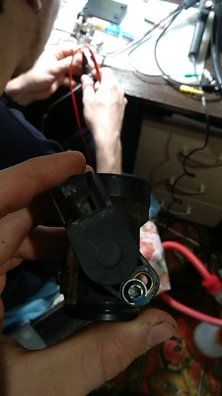

temps0n Posted February 24, 2019 Report Share Posted February 24, 2019 (edited) Hello. I am from Russia. Sorry for my bad language. I bought OSSA Explorer, and after 3 hours i get black spark(spark was new NGK BP5ES). Air filter was clean, and i use synthetic oil for 2 stroke 10 ml/1 l gasoline. Its problem because too much gasoline in injection. I dont have diagnostic cable, and i want to check all sensor and wires, fuel Injector, and fuel pump. I remove temp air sensor, throttle position sensor and fuel Injector to check. And my fuel injector have number FBYCG80 800 1808. Its fuel injector from Subaru Impreza I think its not original fuel injector, but look same. It's my its original (part number 9110010211) from https://trialstribulations.net/index.php?main_page=product_info&cPath=26&products_id=2348 Is anybody know, my fuel Injector is original? If not, do you have a picture of original, or do you know maybe car part number, because its fuel injector from car or moto (OSSA did not produce fuel injection) . Thank you! Edited February 24, 2019 by temps0n Quote Link to comment Share on other sites More sharing options...
konrad Posted February 24, 2019 Report Share Posted February 24, 2019 (edited) Yes, you have the original fuel injector. I paid about $20 USD for one via Aliexpress.com There are many choices: https://www.aliexpress.com/wholesale?catId=0andinitiative_id=SB_20190224120228andSearchText=FBYCG80 Also, lots of information in my OSSA EFI Notebook that could help you: https://www.trialscentral.com/forums/topic/69622-efi-ossa-notebook-formerly-tr280i-wiring-diagram-annotated-in-english/ Edited February 24, 2019 by konrad Quote Link to comment Share on other sites More sharing options...

temps0n Posted February 25, 2019 Author Report Share Posted February 25, 2019 (edited) On 2/24/2019 at 8:05 PM, konrad said: Yes, you have the original fuel injector. I paid about $20 USD for one via Aliexpress.com There are many choices: https://www.aliexpress.com/wholesale?catId=0andinitiative_id=SB_20190224120228andSearchText=FBYCG80 Also, lots of information in my OSSA EFI Notebook that could help you: https://www.trialscentral.com/forums/topic/69622-efi-ossa-notebook-formerly-tr280i-wiring-diagram-annotated-in-english/ Expand Thank you very much, a lot of information in your notebook. After read you notebook i understand did mistake, i removed not air temp sensor, its air pressure sensor (in air box). Today i want to remove temp sensor (in throttle) and check sensor . Edited February 25, 2019 by temps0n Quote Link to comment Share on other sites More sharing options...
konrad Posted February 25, 2019 Report Share Posted February 25, 2019 On 2/25/2019 at 7:54 AM, imexian said: Check and set TPS first! Expand This is good advice! I suggest putting everything back together, and setting the TPS to about 0.6 volts as measured between the TPS center pin (wiper) and chassis ground. If the bike still runs poorly move the TPS slightly. Don't move it randomly. Move it in increments of about 0.02 volts. Try both increasing and decreasing. It is possibly your injector is dirty and leaking into the engine. Some automotive repair shops can clean injectors. But, you really must have the diagnostic system. Here's how to build the interface cable: https://www.trialscentral.com/forums/topic/69670-building-an-ossa-ecu-diagnostic-cable/ Others on this forum have offered the software. A lot of reading on this forum will help. Quote Link to comment Share on other sites More sharing options...

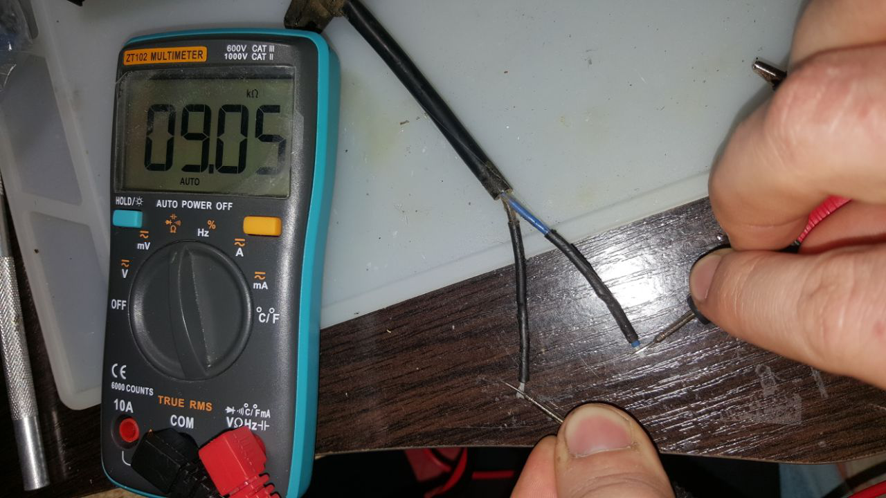

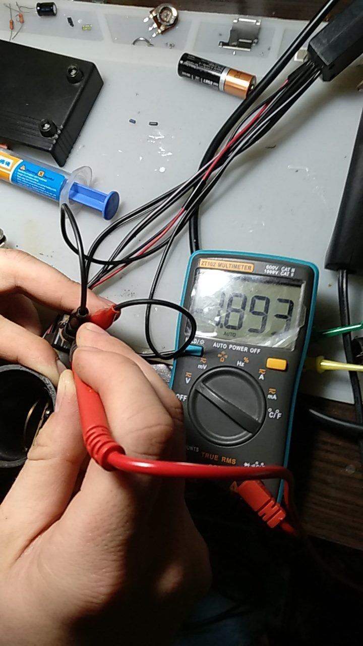

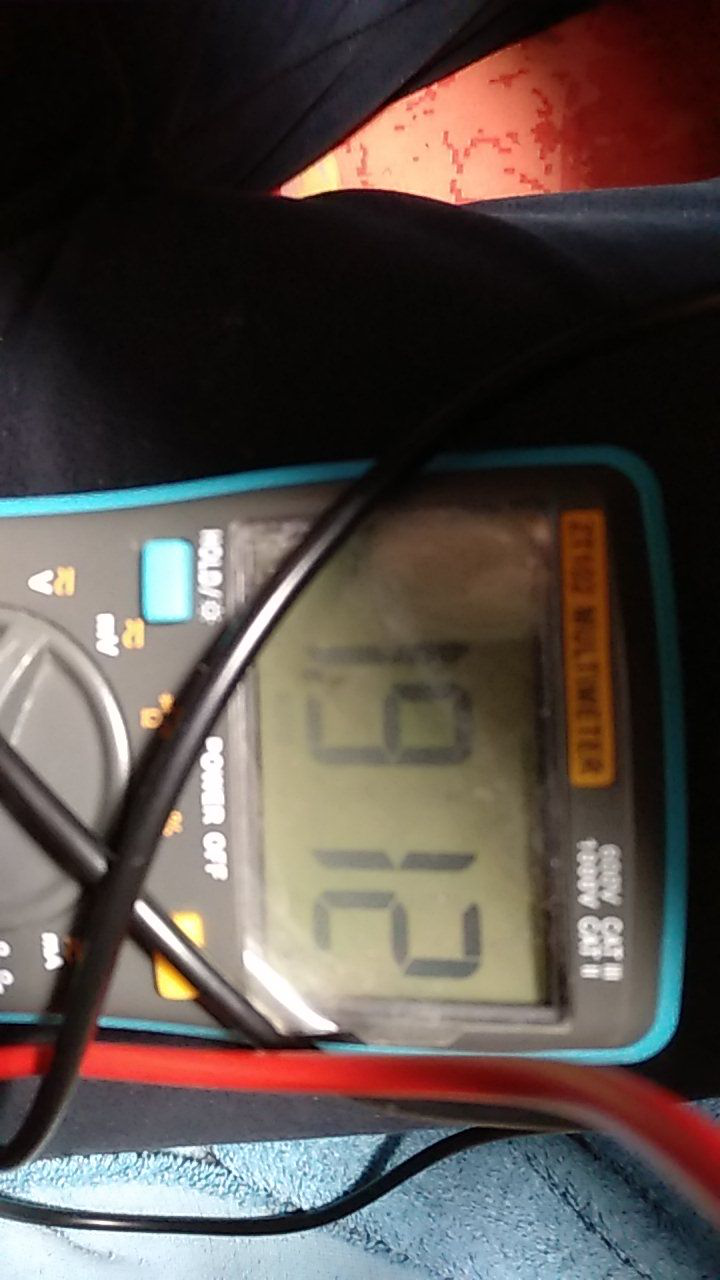

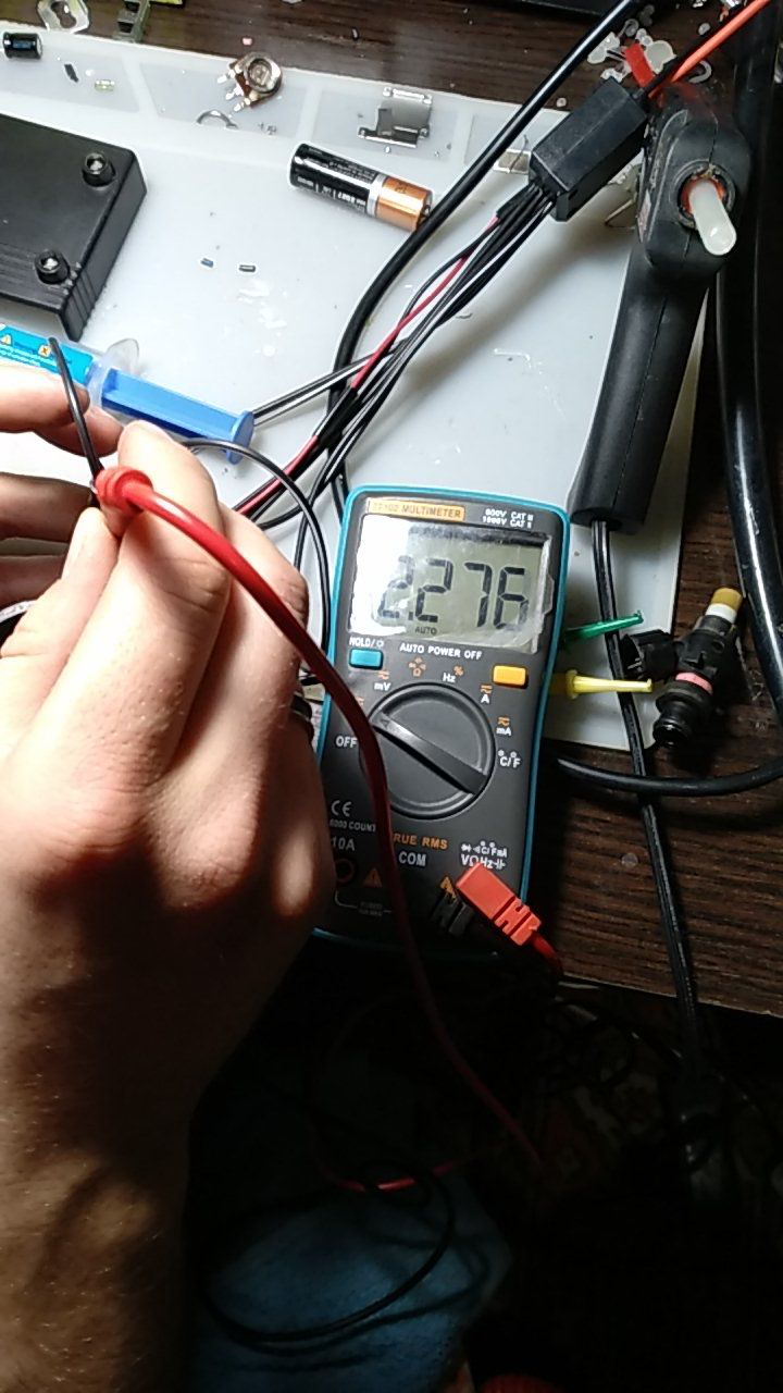

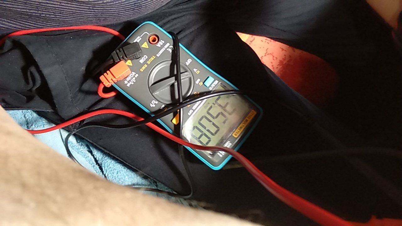

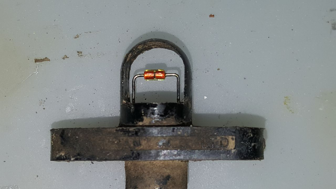

temps0n Posted February 25, 2019 Author Report Share Posted February 25, 2019 (edited) On 2/25/2019 at 1:00 PM, konrad said: This is good advice! I suggest putting everything back together, and setting the TPS to about 0.6 volts as measured between the TPS center pin (wiper) and chassis ground. If the bike still runs poorly move the TPS slightly. Don't move it randomly. Move it in increments of about 0.02 volts. Try both increasing and decreasing. It is possibly your injector is dirty and leaking into the engine. Some automotive repair shops can clean injectors. But, you really must have the diagnostic system. Here's how to build the interface cable: https://www.trialscentral.com/forums/topic/69670-building-an-ossa-ecu-diagnostic-cable/ Others on this forum have offered the software. A lot of reading on this forum will help. Expand Thanks so much for information. I will be think about diagnostic cable. Today checked sensors: 1. Air temperature: Electrical resistance show 9 kOmh, room degree. If i make heat - resistance going down. I dont know, is it correct, i know only, if i change temperature resistance change. 2. Air pressure I give 5 V and check voltage. In standard in my room show me 3,5 V I made vacuum by my mouth and voltage going to 1,9 V I dont know, is it good value or not, but i know - if i change air pressure, value is change too (the same like air temp.) 3. TPS. I check voltage in 2 position TPS on throttle (left and right). 1. position. From 0,825 (idle) to 1,893 (full gas) 2. position. From 0,955 (idle) to 2,276 (full gas) My TPS is broken? If i remove TPS from throttle i dont see 0,6 any way. 0,8 is start. 4. Injection My friend have car repair box and he have stand to check injection, like this But i cant find standard, i need to know: 1. Gasoline pressure 2. Frequency per min (how much injection will be opened and closed per 1 minute) 3. How much gasoline will be in a test tube per 1 minute. I can just look spray (good or not). Like this Edited February 26, 2019 by temps0n Quote Link to comment Share on other sites More sharing options...

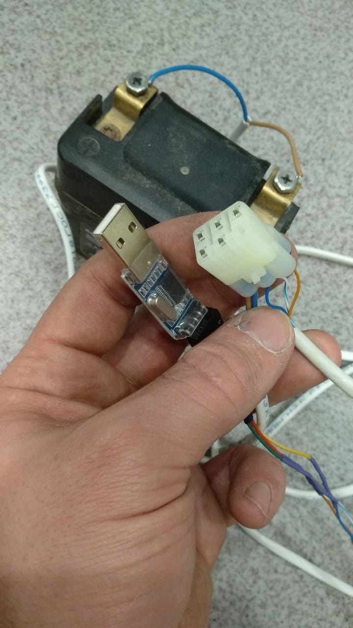

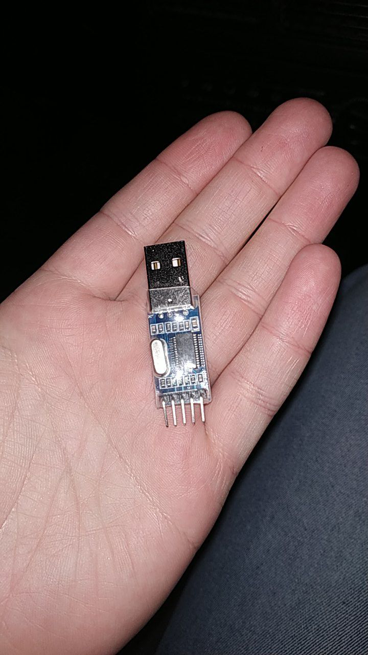

temps0n Posted February 28, 2019 Author Report Share Posted February 28, 2019 I tested injection - it's OK. I think all problems from TPS. I bought TTL-USB convecter, and ready to make diagnostic cable. And i want to reset TPS settings in KScan. tt Quote Link to comment Share on other sites More sharing options...

temps0n Posted April 2, 2019 Author Report Share Posted April 2, 2019 I make diagnostic cable, tomorrow will try connect to EFI Quote Link to comment Share on other sites More sharing options...

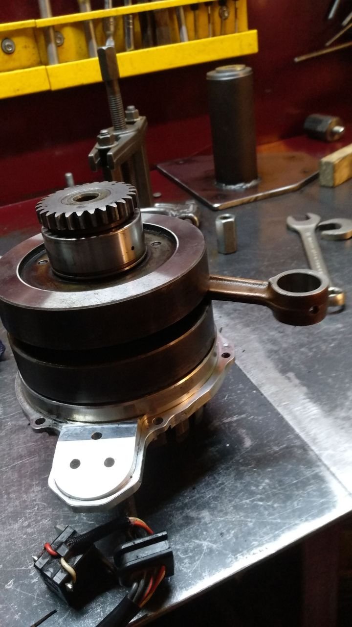

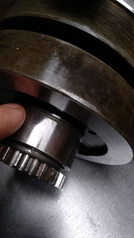

temps0n Posted August 29, 2019 Author Report Share Posted August 29, 2019 I understand my problem: oil form gearbox comes to engine, because rubber on the bearing is bad. I changed out ring rubber, but it still dont work, and oil going to engine. Is anybody know, how to change bearing?? I dont understant how to unlock this bearing. Thanks! Quote Link to comment Share on other sites More sharing options...
