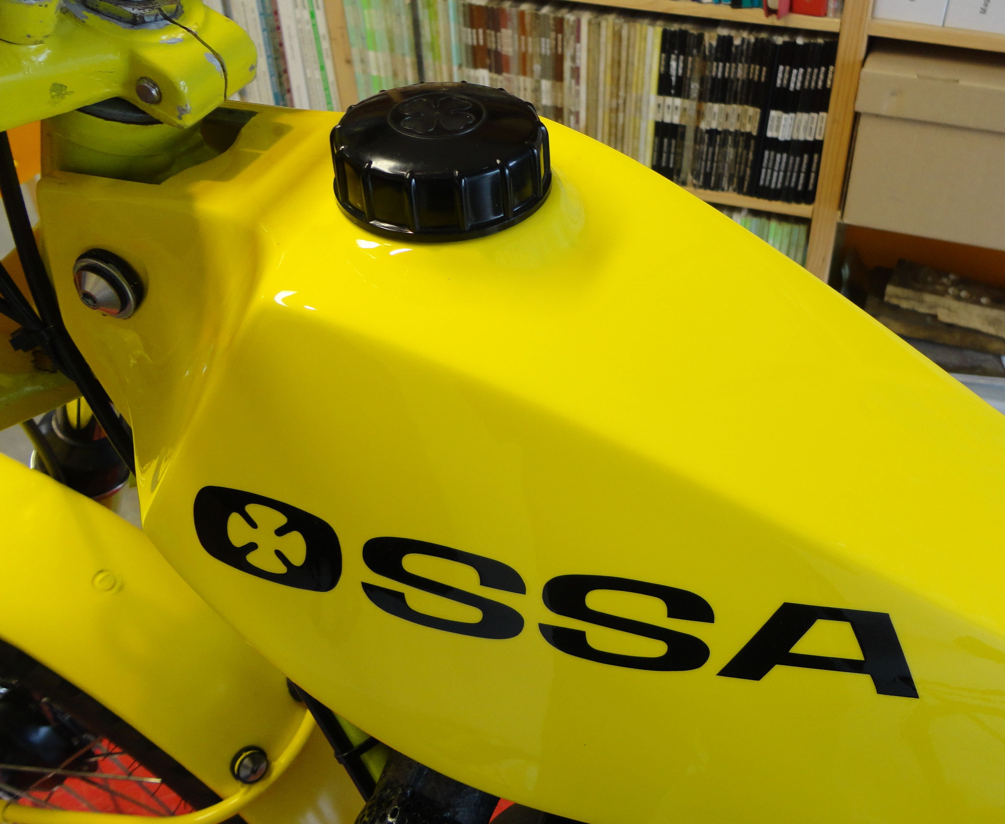

Breather cap.
ossamar
I don't know anything about the TR80, specifically.  How does the tank vent currently?
At the risk of stating the obvious, drill and tap the fuel cap for a hose-barb fitting and install a vent with a one-way checkvalve like this:
https://www.ebay.com/itm/MOOSE-RACING-ALUMINUM-VENT-CAP-FUEL-HOSE-SMALL-ONE-WAY-VALVE-COLORS-ANODIZED-MX/232728408990?hash=item362fb1b39e:m:m8S6mTDXwRrxYJaRgZoaXUQ:rk:1:pf:0
One caution, I've found some of the Chinese copies may look like the above, but don't actually contain a checkvalve.
