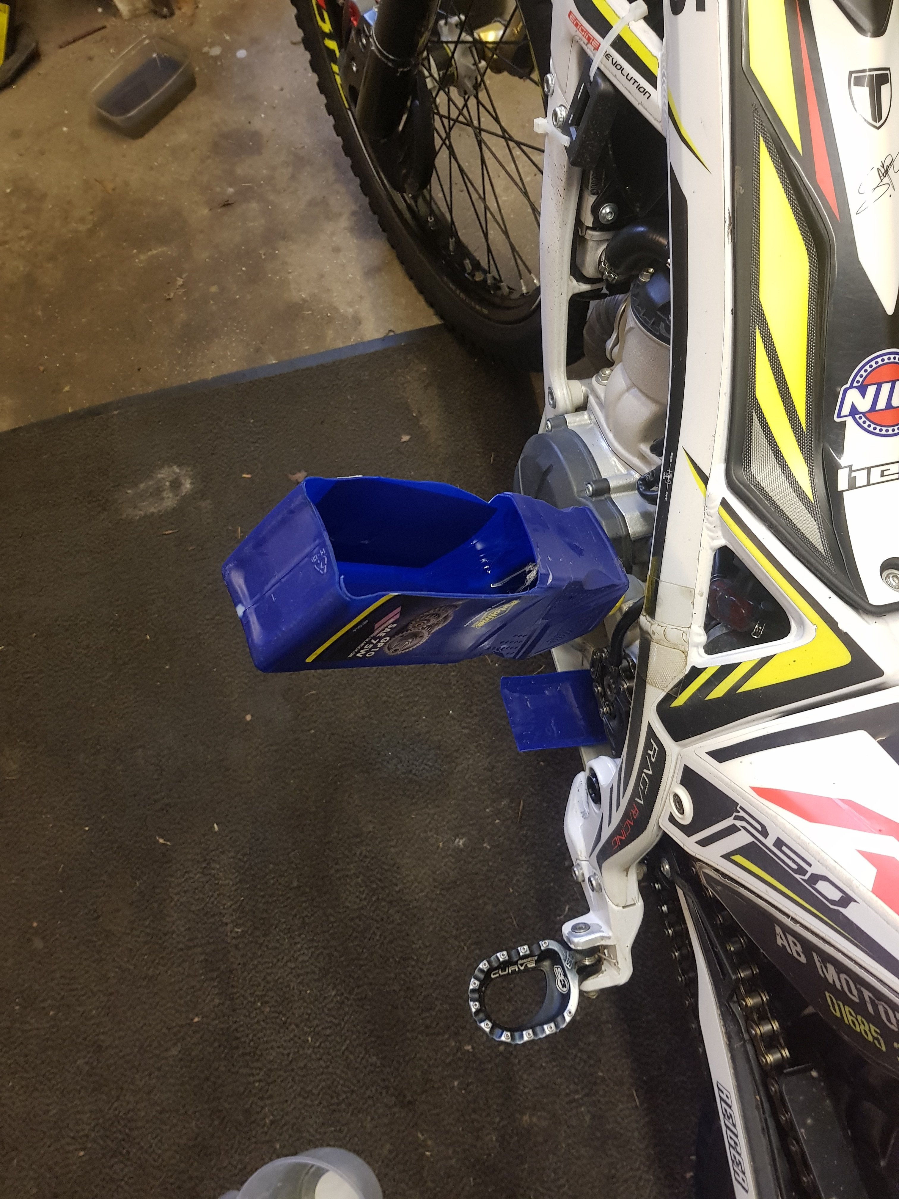

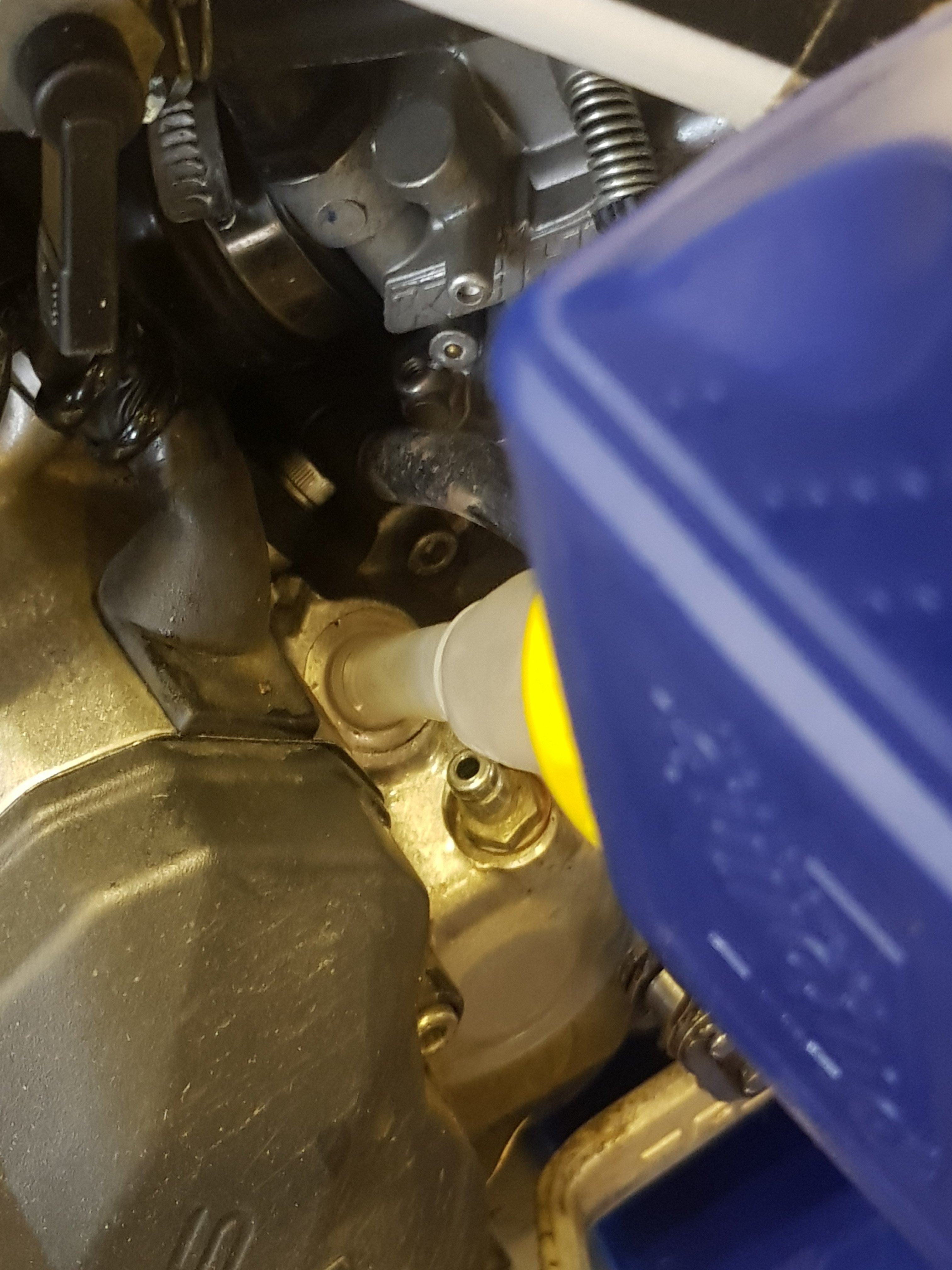

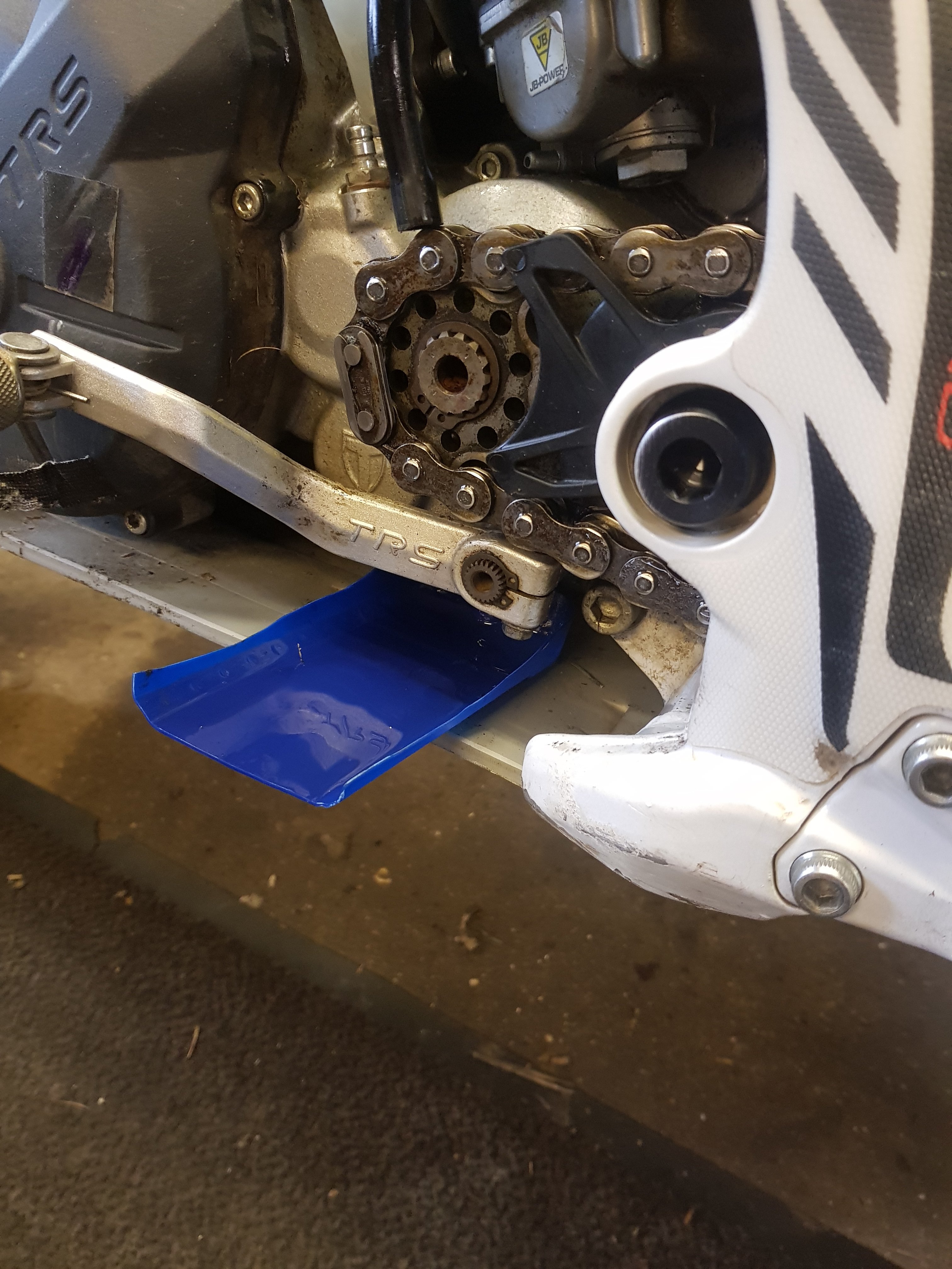

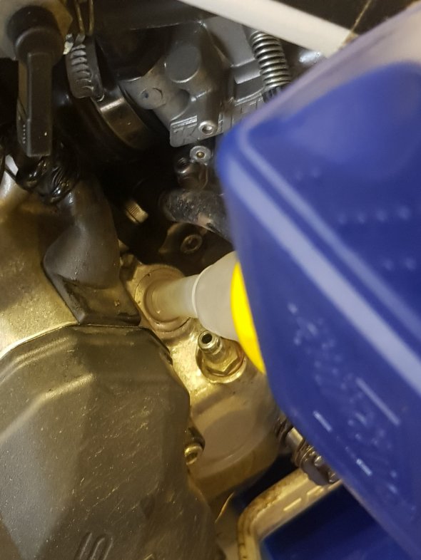

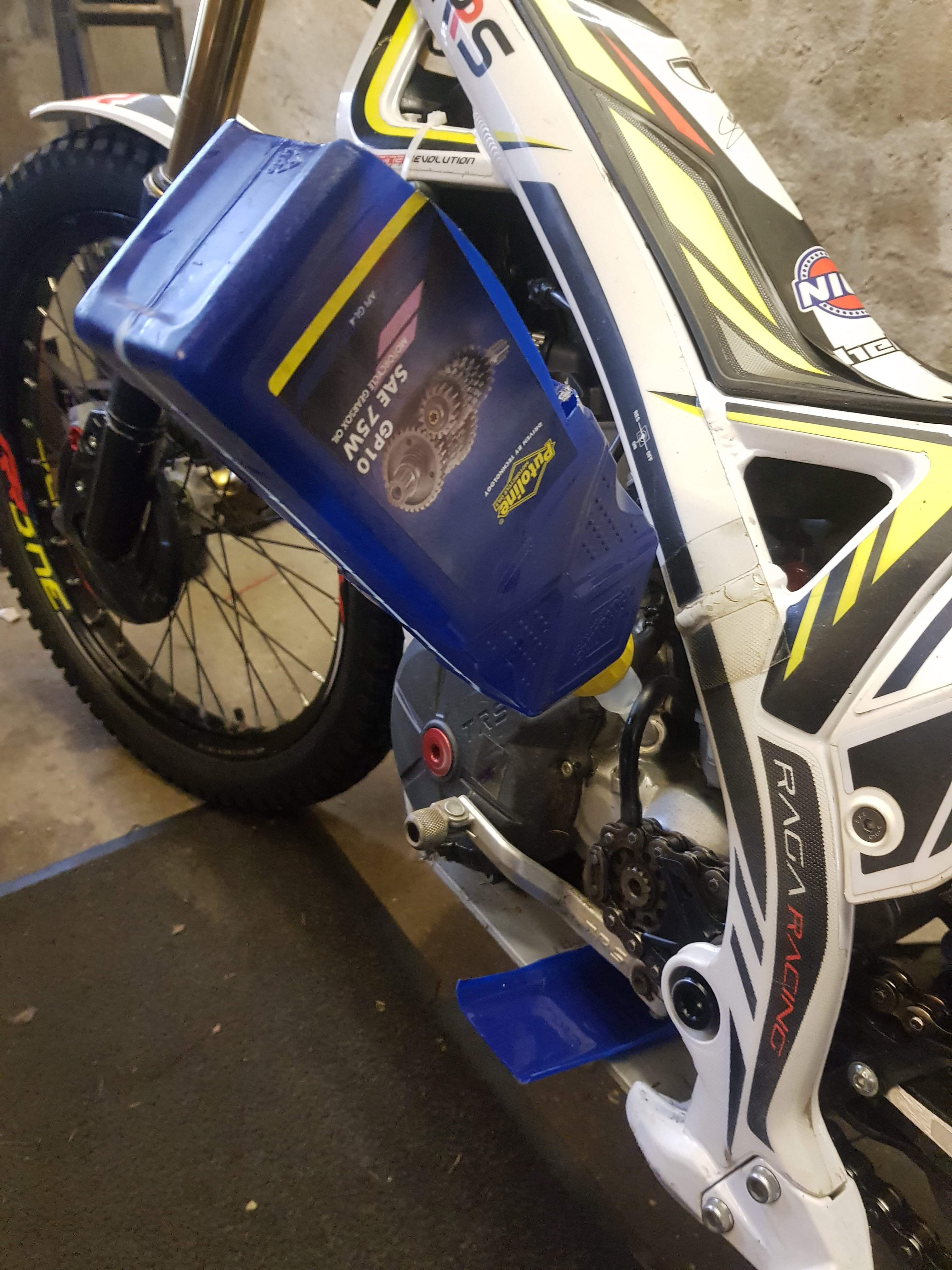

Spanky Posted March 16, 2019 Report Share Posted March 16, 2019 A modified gp10 bottle works a treat as a funnel and drain. 1 1 Quote Link to comment Share on other sites More sharing options...

baldilocks Posted March 17, 2019 Report Share Posted March 17, 2019 Thankyou for posting the pictures. I wasn't trying to be awkward earlier but your pictures make it clear. I really can't see why you would need the jitsie part to put oil in a TRS. In terms of which side to use you can actually drain both and I'd think you'll get more out. I started using the right side thinking there would be more debri in the oil from the clutch but not sure it's made any difference? 1 Quote Link to comment Share on other sites More sharing options...
