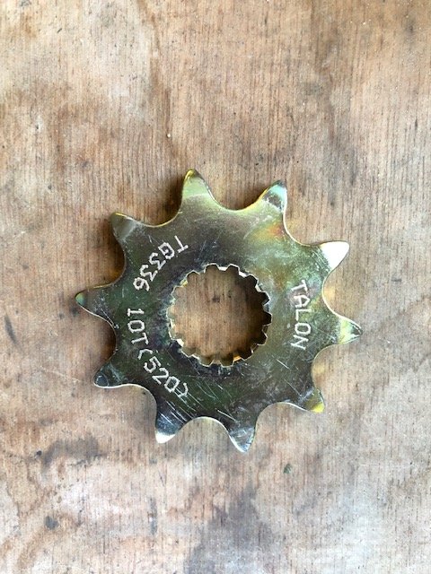

taff_d Posted July 2, 2019 Report Share Posted July 2, 2019 (edited) On 7/1/2019 at 6:31 PM, anachronism said: Anyone had a chance to figure out if the smaller spline on the 18 & up RRs is the same as any other existing spline? Not seeing anything after market except "DOES NOT fit 18 & up RRs". Would like to try an 11 front/bigger rear for different ratios & longer chain/sprocket life. Expand This is what you want This was supplied to me by me local TRS dealer so I presume it's correct not fitted it yet ? Edited July 2, 2019 by taff_d Quote Link to comment Share on other sites More sharing options...
anachronism Posted July 2, 2019 Report Share Posted July 2, 2019 @taff_d: I hope that is correct. That is 2010 & previous Scorpa SY250 available from Talon in 10 to 14. Please post up when you get a chance to try it. Quote Link to comment Share on other sites More sharing options...
baldilocks Posted July 3, 2019 Report Share Posted July 3, 2019 That's the same sprocket reference I have , we have the answer ? Quote Link to comment Share on other sites More sharing options...
taff_d Posted July 3, 2019 Report Share Posted July 3, 2019 It fits ? Quote Link to comment Share on other sites More sharing options...
