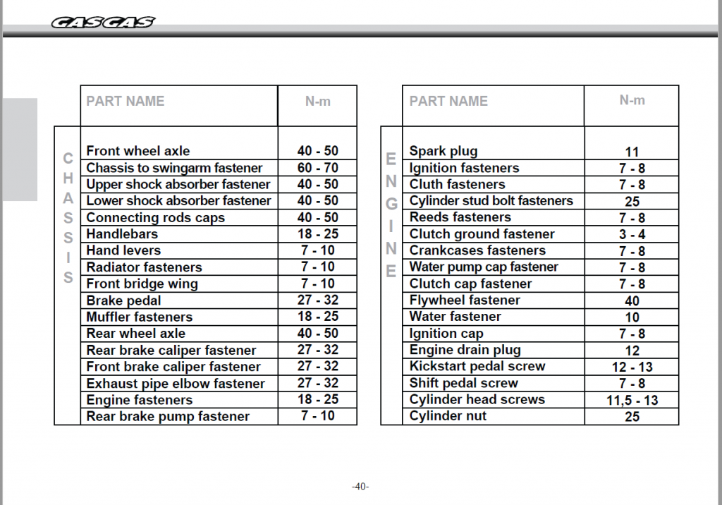

Mcasp Posted March 27, 2019 Report Share Posted March 27, 2019 Hi guys , anyone know the torque settings for the cylinder head on a 2009 txt pro 125 ! Thanks Quote Link to comment Share on other sites More sharing options...
Bilko Posted March 27, 2019 Report Share Posted March 27, 2019 Quote Link to comment Share on other sites More sharing options...
Mcasp Posted March 27, 2019 Author Report Share Posted March 27, 2019 Thanks Bilko, I take it I'm looking at cylinder head screws? Quote Link to comment Share on other sites More sharing options...
Bilko Posted March 28, 2019 Report Share Posted March 28, 2019 1 Quote Link to comment Share on other sites More sharing options...
Mcasp Posted March 28, 2019 Author Report Share Posted March 28, 2019 Thanks that's sorted !! Cheers 1 Quote Link to comment Share on other sites More sharing options...
