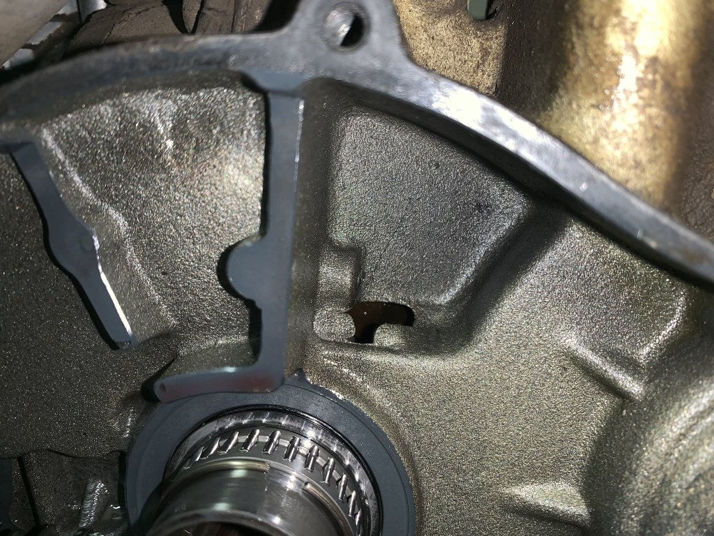

crwjwa Posted April 1, 2019 Report Share Posted April 1, 2019 Gsa Gas TXT 300 2013 Should this hole through to the gear side of the crankcase be there behind the clutch basket ????? Quote Link to comment Share on other sites More sharing options...
Sense only Posted April 1, 2019 Report Share Posted April 1, 2019 Casings generally have these casting holes in all sorts of places..because spinning parts create a certain amount of wind which if completely sealed would cause crankcase pressure.plus the oil can pass all around the vital bits...nevertheless check your sump plug for any excess metal just in case..look at pictures of the same engine on googlebox fer reassurance Quote Link to comment Share on other sites More sharing options...
markparrish Posted April 1, 2019 Report Share Posted April 1, 2019 Betas seem to have those worrying looking holes too. I thought I had a seriously damaged case until I saw some other examples! Quote Link to comment Share on other sites More sharing options...
Bilko Posted April 1, 2019 Report Share Posted April 1, 2019 (edited) No that shouldn't be like that,part of the case is busted,but there should be a plug or bolt of some kind where your hole is. Edited April 1, 2019 by Bilko Quote Link to comment Share on other sites More sharing options...

faussy Posted April 1, 2019 Report Share Posted April 1, 2019 (edited) Pretty sure that's standard although the hole is usually a little tidier around the edges than yours check out the pics in this thread Edited April 1, 2019 by faussy Quote Link to comment Share on other sites More sharing options...
arnoux Posted April 2, 2019 Report Share Posted April 2, 2019 (edited) Sorry Bilko but you are wrong on this one. That is absolutely stock, and most cases of that era are quite "rough" like that. I can see how you may think it is damage, but I can assure you it is nothing to be concerned about. Footnote: I have done many many GG engine rebuilds over the last couple of decades, and seen new cases straight from Spain, as I am Gasser importer in Australia. So I have seen enough to know. Edited April 2, 2019 by arnoux 1 Quote Link to comment Share on other sites More sharing options...

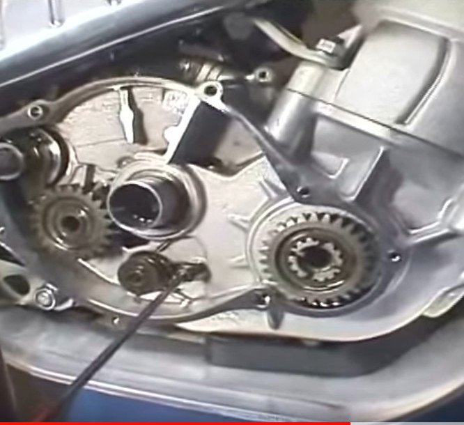

crwjwa Posted April 2, 2019 Author Report Share Posted April 2, 2019 Thanks again Arnoux After many hours searching the net I've found several pic's and videos which show similar holes. As stated above, some seem more "tidier" than others (mine), but definitely there is a hole there. Great relief obviously ..... 1 Quote Link to comment Share on other sites More sharing options...
duggan Posted April 2, 2019 Report Share Posted April 2, 2019 100% it’s like this from the factory. Quote Link to comment Share on other sites More sharing options...

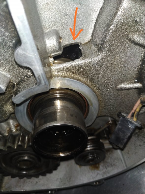

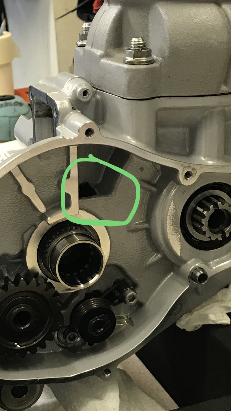

gravityisnotmyfriend Posted July 9, 2019 Report Share Posted July 9, 2019 I know this is an old thread - but I was concerned about that hole as well. Glad to see that it's normal. Mines' a 300 TXT Pro Raga. Quote Link to comment Share on other sites More sharing options...
sectionone Posted July 10, 2019 Report Share Posted July 10, 2019 There's another hole next to the idler gear. A friend's idler gear needle bearing disintegrated for some reason and shrapnel went through the holes and damaged the gears. I was thinking on mine to JB Weld aluminum screens on the holes in case it happens to me. Maybe a screen barrier around the primary gear since it damaged that also and the part is not available. Quote Link to comment Share on other sites More sharing options...
