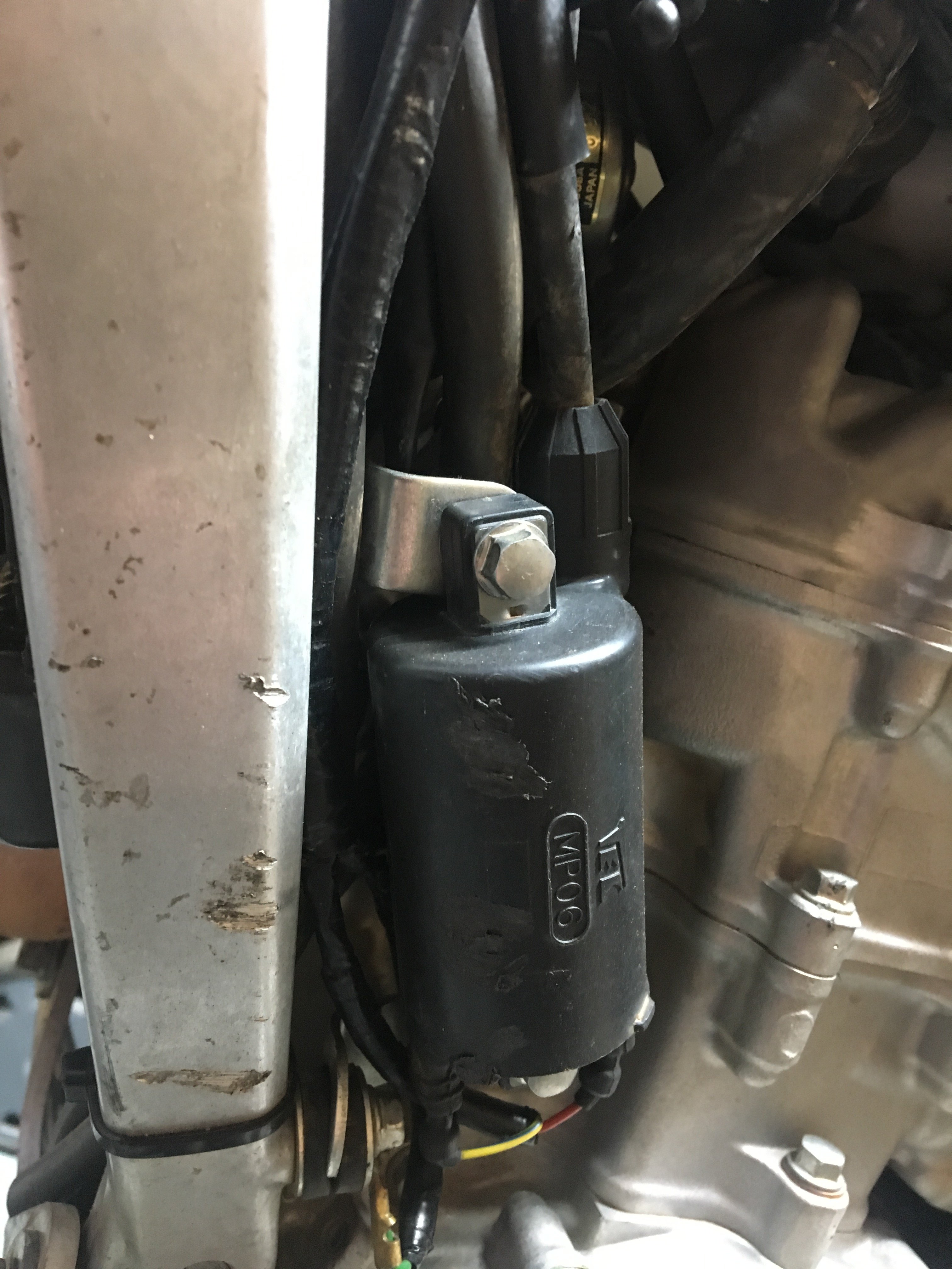

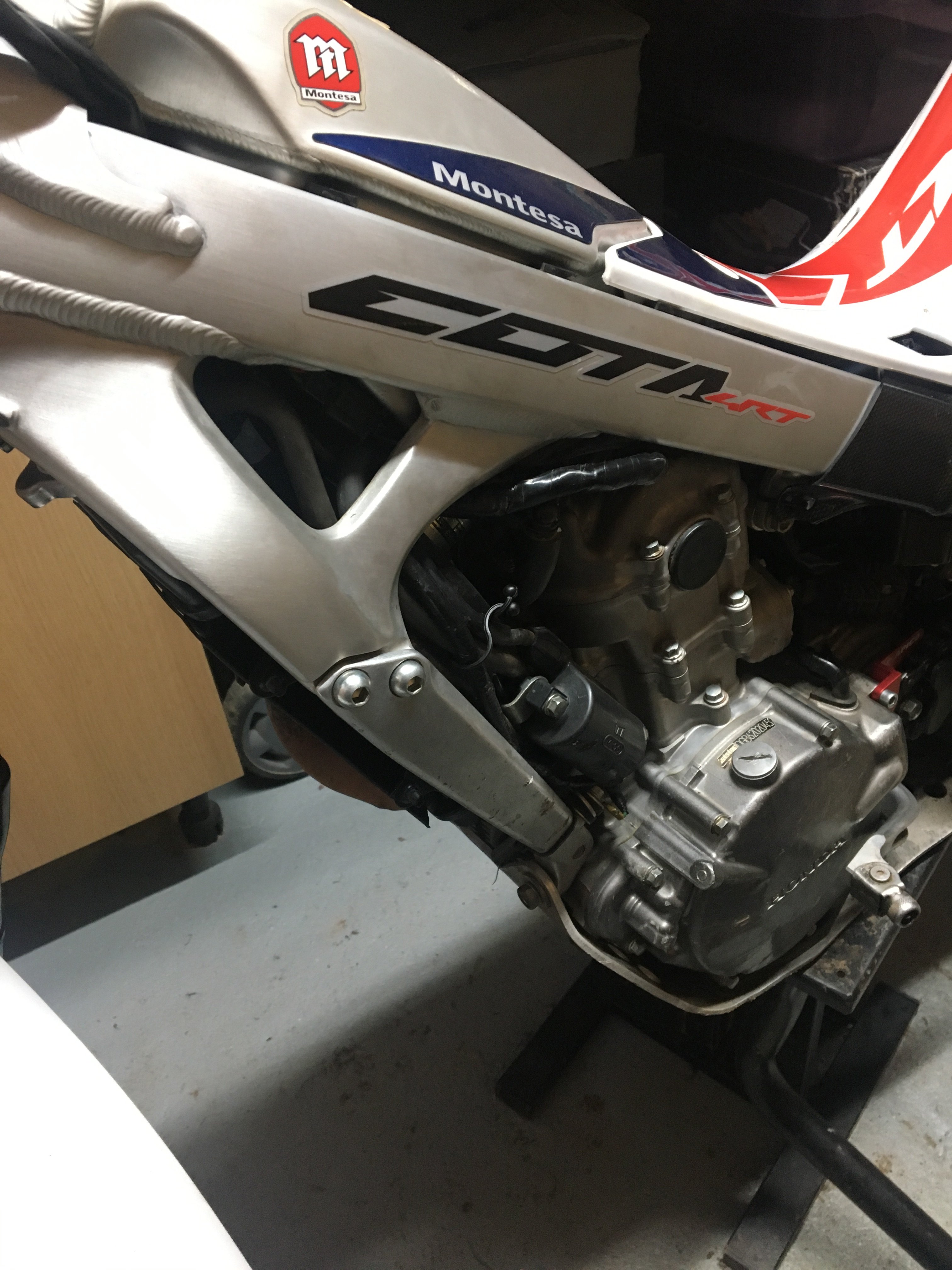

54tphill Posted April 8, 2019 Report Share Posted April 8, 2019 (edited) I love my new 4rt but have recently had an issue and wanted to share my experience to hopefully save somebody else time and money. My bike started cutting out on me at a trial, sometimes I was riding between sections in 3rd and 4ty gear, sometimes I was in sections in 1st and 2nd gear, it sometimes would kick straight back up and sometimes it would take 10 kicks to get it going again. I rang the dealer “inch perfect trials” and explained the problem, it sounded to them as though it was the bank sensor so John talked me through how to by pass it. We hoped that sorted it but after going out to practice I soon realised it wasn’t that. I spoke again to the guys at inch perfect and they recommended to bring the bike back to them as the bike is covered under warranty. Simon,Matt and John were great. I arrived and they took my bike into the work shop, they offered me another bike to go out on for a few hours. It’s a pretty awesome location to say the least. So I went off for a ride on another 4rt leaving the bike with John and his apprentice. It was an intermittent fault which made it more difficult to diagnose. They started my bike initially and all seemed well but after 10minutes it started cutting out again, they had noticed a scrape on the left side of the bike, the black plastic thing, I think that’s the ignition pack. They started by changing that, then the ECU then the throttle body ect ect. But it still cut out, in the end they came back to the black plastic thing that I unknowing must have damaged, the bracket was bent back slightly ?behind that is the thermostat I slight impact on the plastic black ignition pack part has knocked it back a bit then causing damage to the thermostat .... I have lightly dropped the bike a few times to be fair, but if you don’t drop your bike occasionally then your obviously are not trying hard enough ? The good news, bike fixed! bad news, not covered under warranty & I had to pay for the thermostat and Labor ??♂️ The bottom line is, they found the fault and fixed it, they gave a great service and I enjoyed my self. Thankyou Inch Perfect Trials cheers John and the young dude who fixed it cheers Matt and Simon for a great service Edited April 8, 2019 by 54tphill Added a bit more information 1 2 Quote Link to comment Share on other sites More sharing options...

jonnyc21 Posted April 22, 2019 Report Share Posted April 22, 2019 You have a rather pronounced hit on that coil, if it’s damaging it could cut out when heated up. I had a BMW R1100S that had a coil that would cut out when hot and replacement fixed it. jut a thought... and best of luck. Quote Link to comment Share on other sites More sharing options...
jrsunt Posted April 22, 2019 Report Share Posted April 22, 2019 You had a bill of £200 which was cheap considering the hours I spent trying to diagnose the fault. The diagnostic tool wouldn't even read the bike because of the damage. We swapped the ht coil, throttle body, condenser and b/a sensor from my brand new bike that had never turned a wheel let alone been started, testing and reassembling after each component change is very time consuming. Swapping all those from 1 brand new bike to another is no simple job, plus you were given another bike to ride for the day while you waited.... Everytime the fan kicked in or turned off the bike would cut out. After much head scratching, I noticed the thermostat was very bent and the radiator had creased from the hit to the ht coil. I swapped the thermostat from my bike and the bike worked as normal. Your parts were then reassembled on the bike and you test rode it, and the diagnostic tool would communicate with the bike. Draw your own conclusions from this. Please, bring the bike back again 3 1 Quote Link to comment Share on other sites More sharing options...
