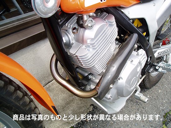

Twinrider Posted April 8, 2019 Report Share Posted April 8, 2019 I just picked up a 2004 TYS125F. The bike is in great nick overall, but the header pipe is pretty rusty from sitting outside. I'd like to replace it with a titanium aftermarket pipe. There are several choices in Japan where I am. One has a bigger diameter overall and a small expansion chamber. The other seems to be a similar diameter to the stock header with a small expansion chamber. Any recommendations on which would have the most suitable power characteristics for this small motor? The use is slow speed cross-training and trail riding. Some road riding as well to connect trails. Cheers. Quote Link to comment Share on other sites More sharing options...
