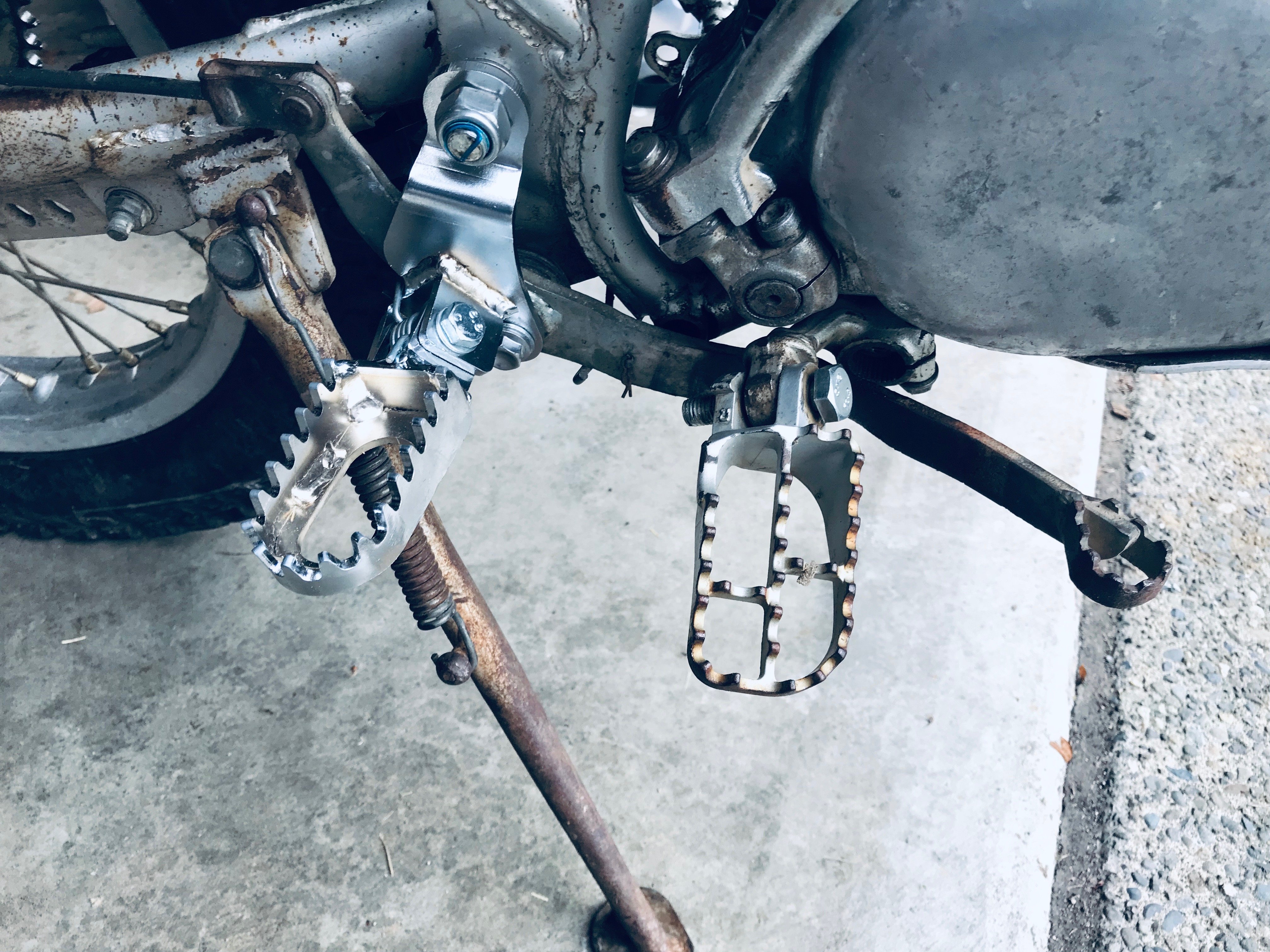

robd0gg Posted May 16, 2019 Author Report Share Posted May 16, 2019 (edited) so not sure how this got turned in to a TY250 footrest post, as was stated by others, the 250 mounts and 175 mounts are not the same.. also, I am not talking about a simple lowering kit that only drops the rests a half inch or so and moves them back a half inch.. but a bolt on the frame replacement kit such as shown below. I remounted the aftermarket pegs, in the original position to show the difference.. having mounted the new kit, I think the shifter and brake lever distances are manageable.. as I have owned other modern trials bikes before.. so no changes other then adjusting the resting height of the levers since the new position is about an inch higher; and five inches or so further back.. now I just need to figure out how to keep the right footrest up out of the way so I can kick the motor over.. probably just a simple elastic band or old bicycle innertube arrangement thanks to those that stayed on topic and were helpful.. the rest of you, make your own threads.. hehe Edited May 16, 2019 by robd0gg 1 Quote Link to comment Share on other sites More sharing options...

jon v8 Posted May 17, 2019 Report Share Posted May 17, 2019 I can't be bothered with "Thread" politics, but one thing I would say is that those bolt on footrest kits are not very strong.I had something very similar or maybe identical from SM products on my TY250, they bend very easily. I ended up welding a thick gusset down the front face of them. Quote Link to comment Share on other sites More sharing options...

feetupfun Posted May 17, 2019 Report Share Posted May 17, 2019 5 hours ago, jon v8 said: I can't be bothered with "Thread" politics, but one thing I would say is that those bolt on footrest kits are not very strong.I had something very similar or maybe identical from SM products on my TY250, they bend very easily. I ended up welding a thick gusset down the front face of them. On my SM TY175 pegs, the holes for the pivot pin elongated. I do weigh 95 kg though. I welded on some thick washers and they have been OK since. Quote Link to comment Share on other sites More sharing options...
