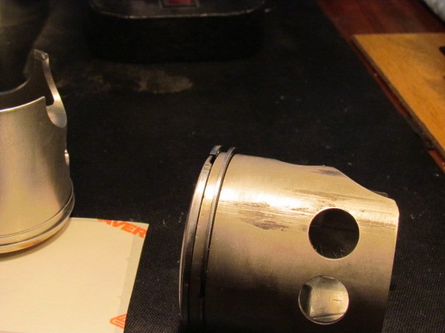

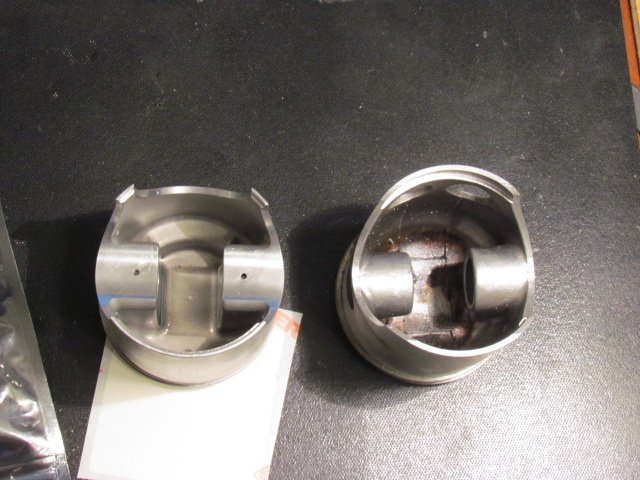

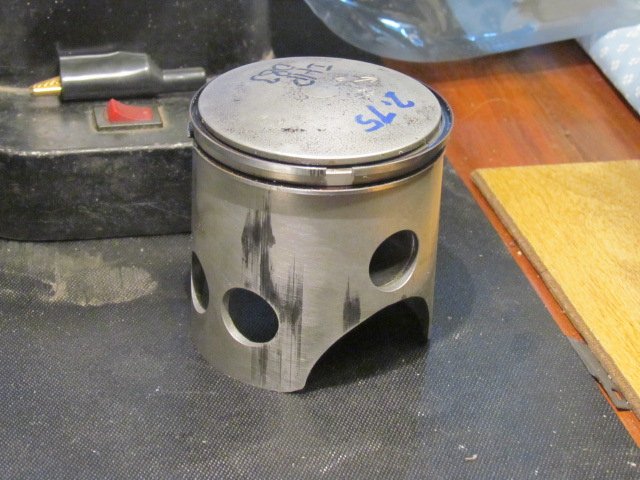

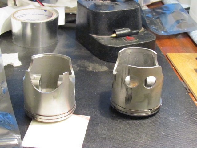

Tillerman6 Posted April 19, 2019 Report Share Posted April 19, 2019 Guys, So after getting my parts back from Millenium Technologies- new bore on Ebay cylinder and new piston- I noticed quite a bit of vibration. So today I tore it down again and weighed the new piston, pin, upper end bearing and compared those weights to the ones on the original parts. As I expected, the new piston was significantly heavier than the old original piston, even though the piston size was still the same. Old Piston 213 gm New piston 241gm a delta of 28 grams. Old pin 57 gm New pin 60 gm delta of 3 grams The remainder of the parts were too light to measure on the scales I borrowed, so I am forced to ignore those results. So with this much difference in weight it is no wonder that the bike is trying to shake itself to pieces! But there is no way to shave enough material off that new piston to make it match the weight of the old one! So the hard choices seem to come down to : A- try to find new rings? 434-11610-00 (standard size) B - I may have found a set of 1st oversize rings - but can these be shaved down enough to work in a standard size bore? C polish up the old rings and use them again? The scratches are only about .005" deep (I am guessing) and the piston has some scuffing, but is not too bad .Fresh bore on a different cylinder. The new piston ran in the fresh bored cylinder without a problem except for the vibration. D If you have any ideas? I am very tempted to put the old piston back in as is if I can't find any new rings for it anywhere else? Quote Link to comment Share on other sites More sharing options...

guy53 Posted April 20, 2019 Report Share Posted April 20, 2019 I have never seen a TY TS piston like that. Guy Quote Link to comment Share on other sites More sharing options...
Bmonk Posted April 20, 2019 Report Share Posted April 20, 2019 Looks like a YZ piston...what are the numbers on the piston crown? Quote Link to comment Share on other sites More sharing options...

Tillerman6 Posted April 20, 2019 Author Report Share Posted April 20, 2019 9 hours ago, Bmonk said: Looks like a YZ piston...what are the numbers on the piston crown? 0899F AND UNDER THAT 234M07000 . Says it fits YZ250 76-79 and IT250 78-80 9 hours ago, Bmonk said: Looks like a YZ piston...what are the numbers on the piston crown? 9 hours ago, Bmonk said: Looks like a YZ piston...what are the numbers on the piston crown? Quote Link to comment Share on other sites More sharing options...
