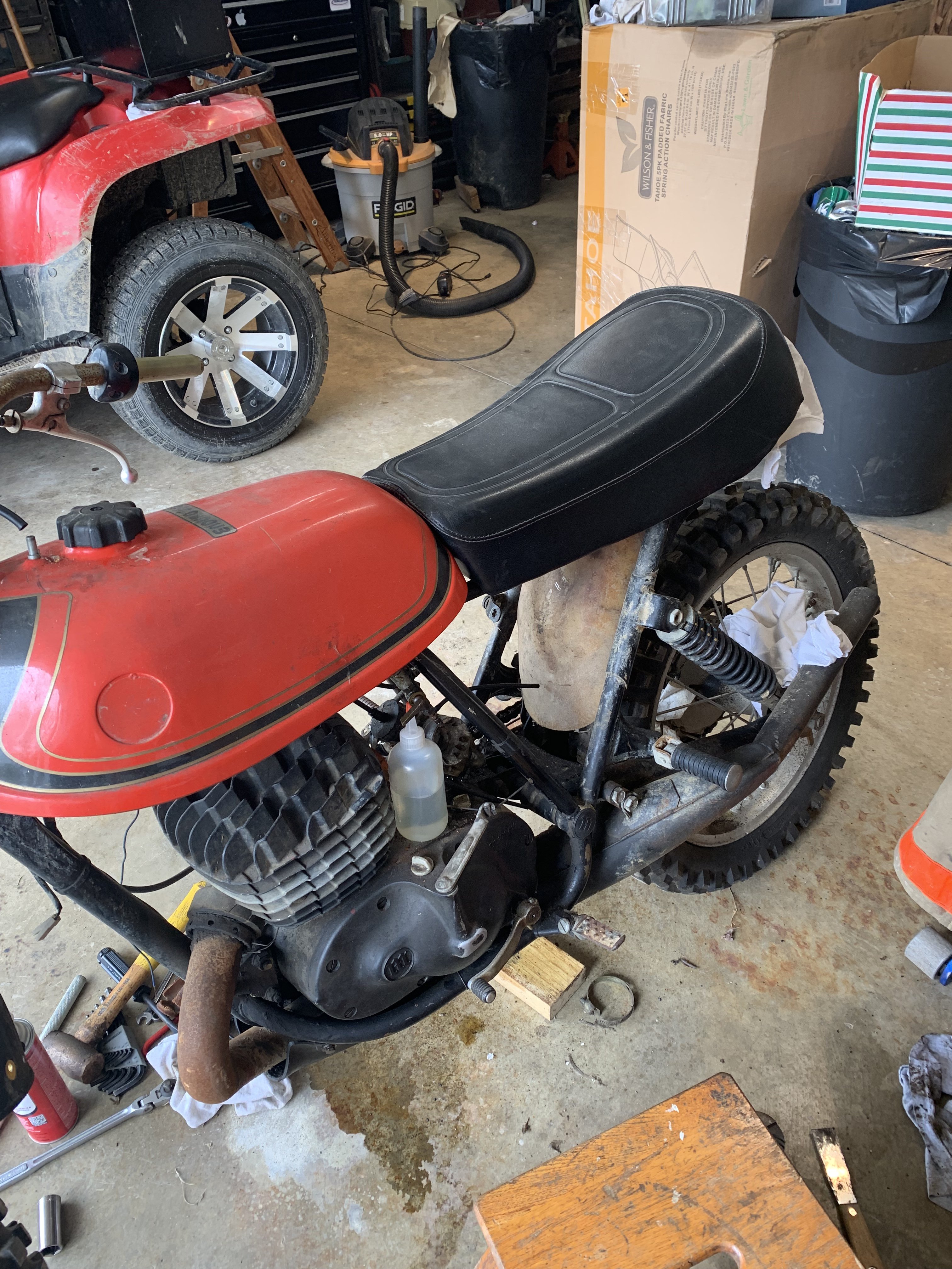

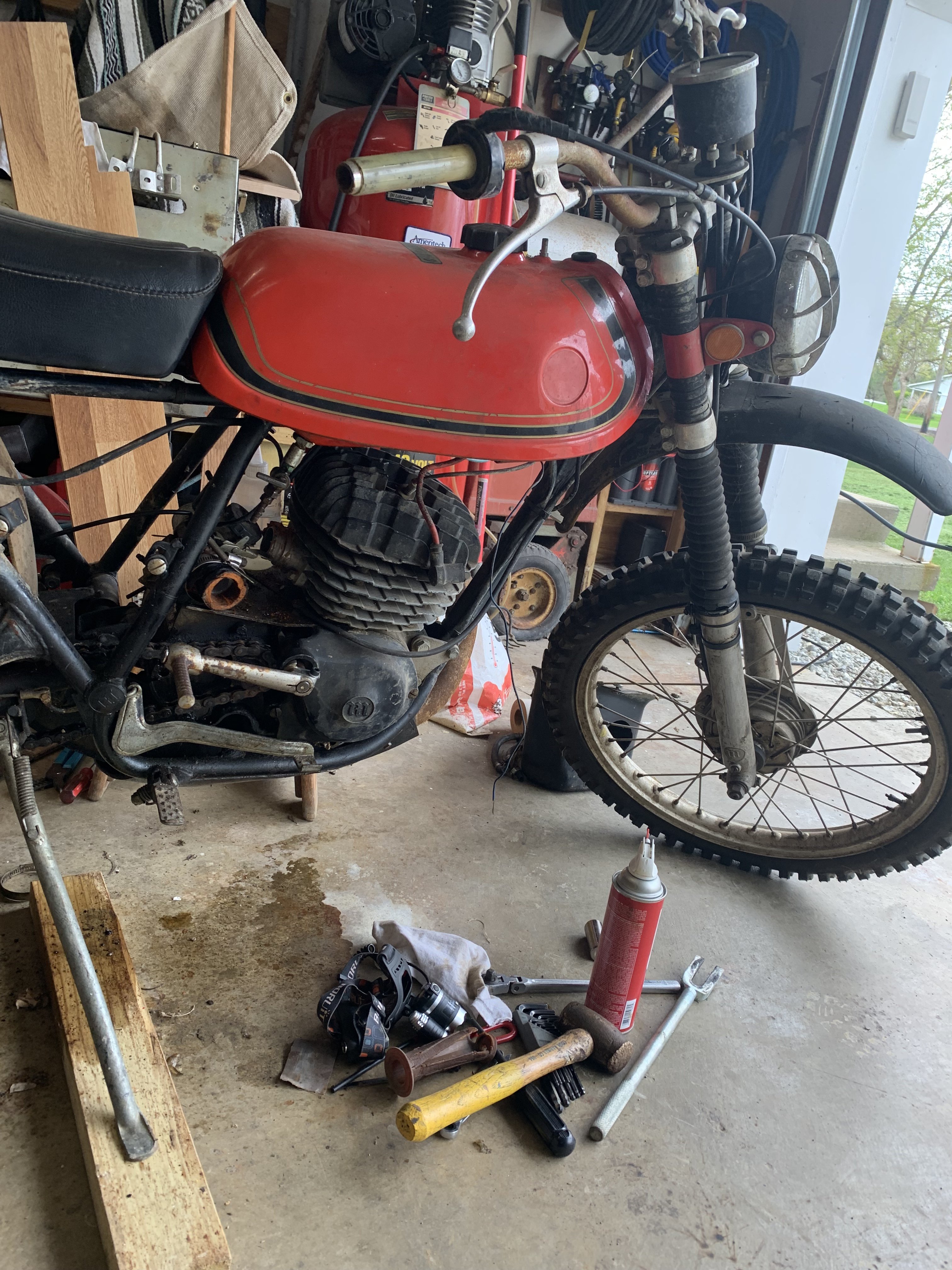

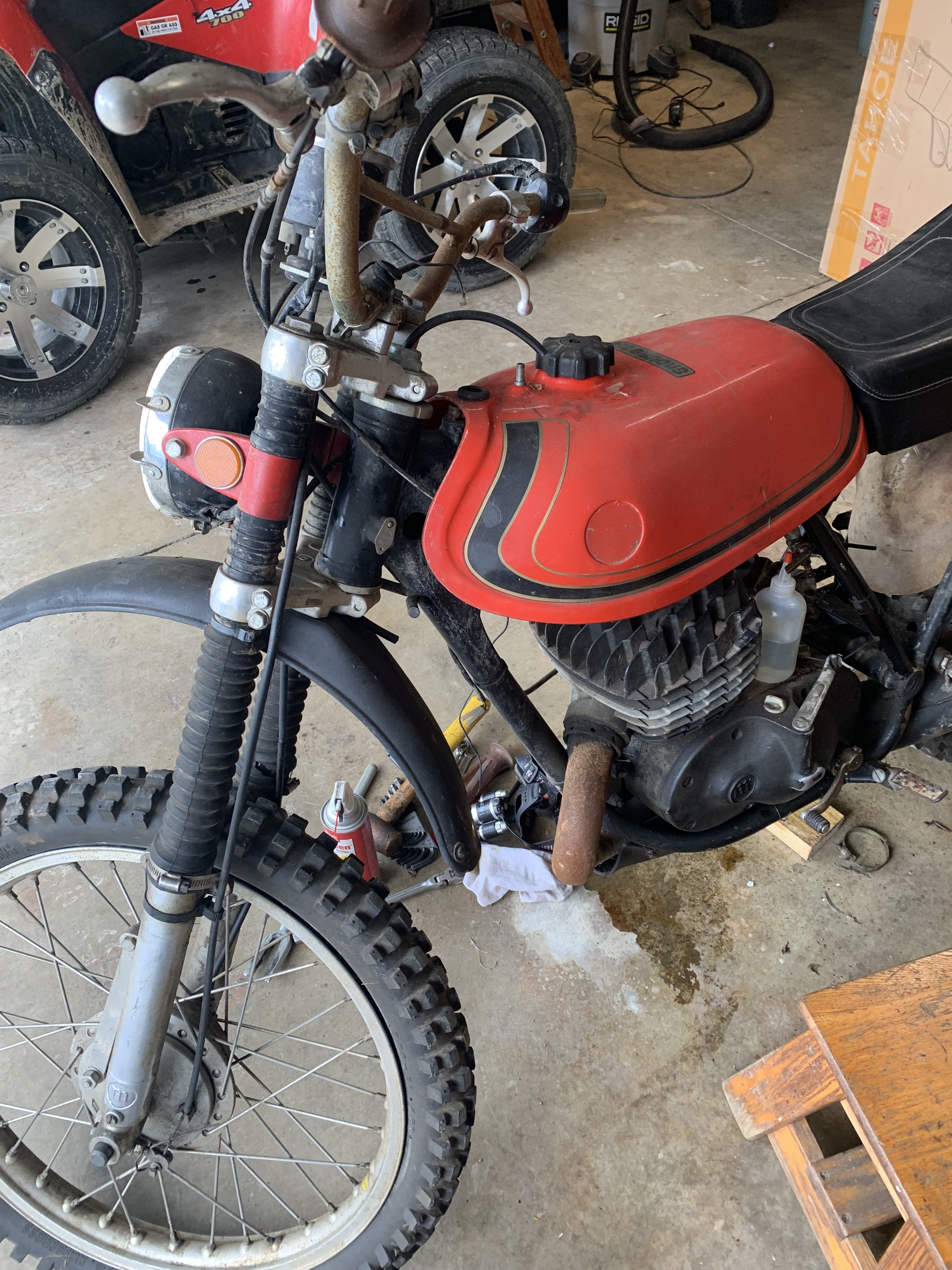

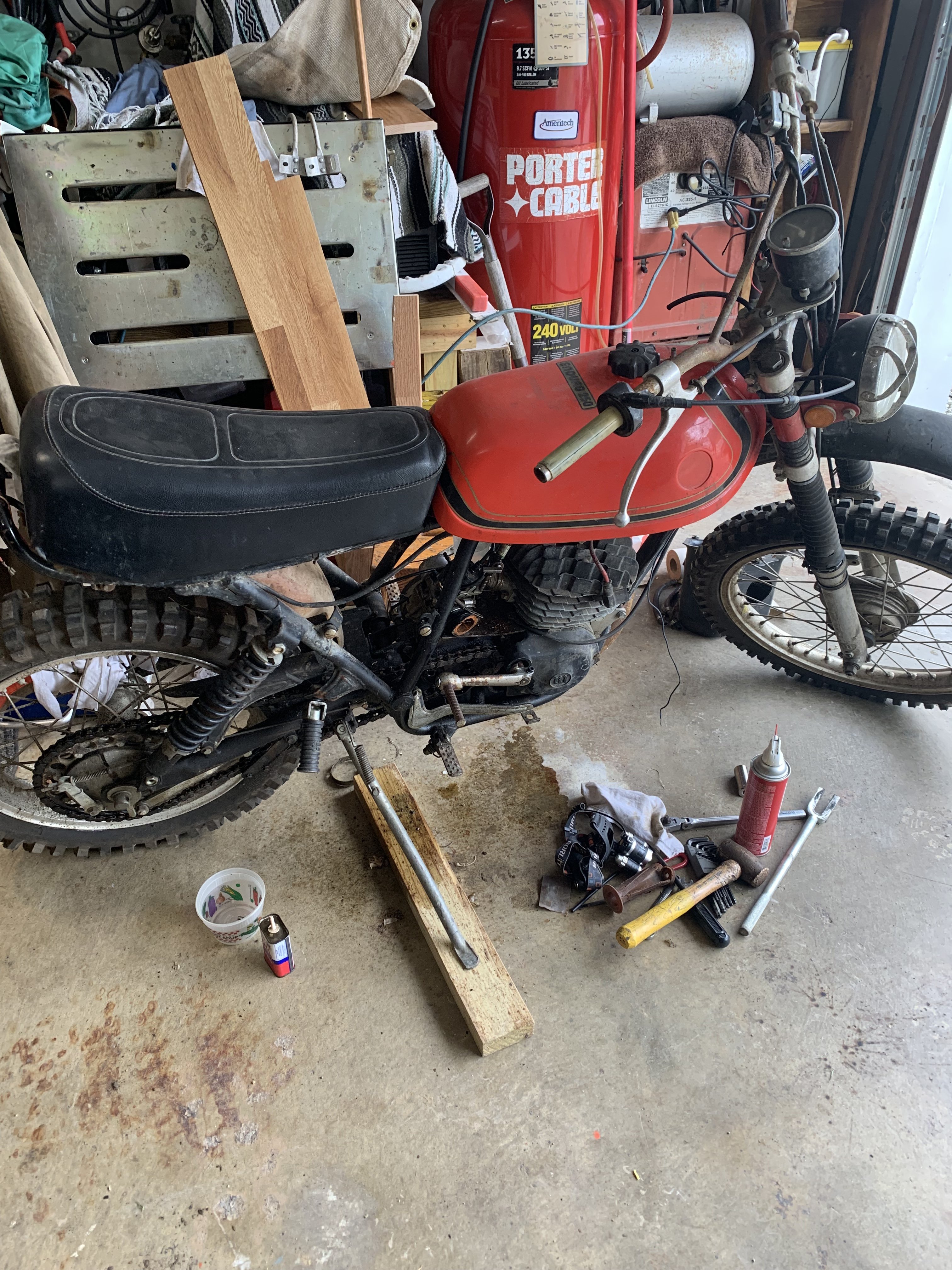

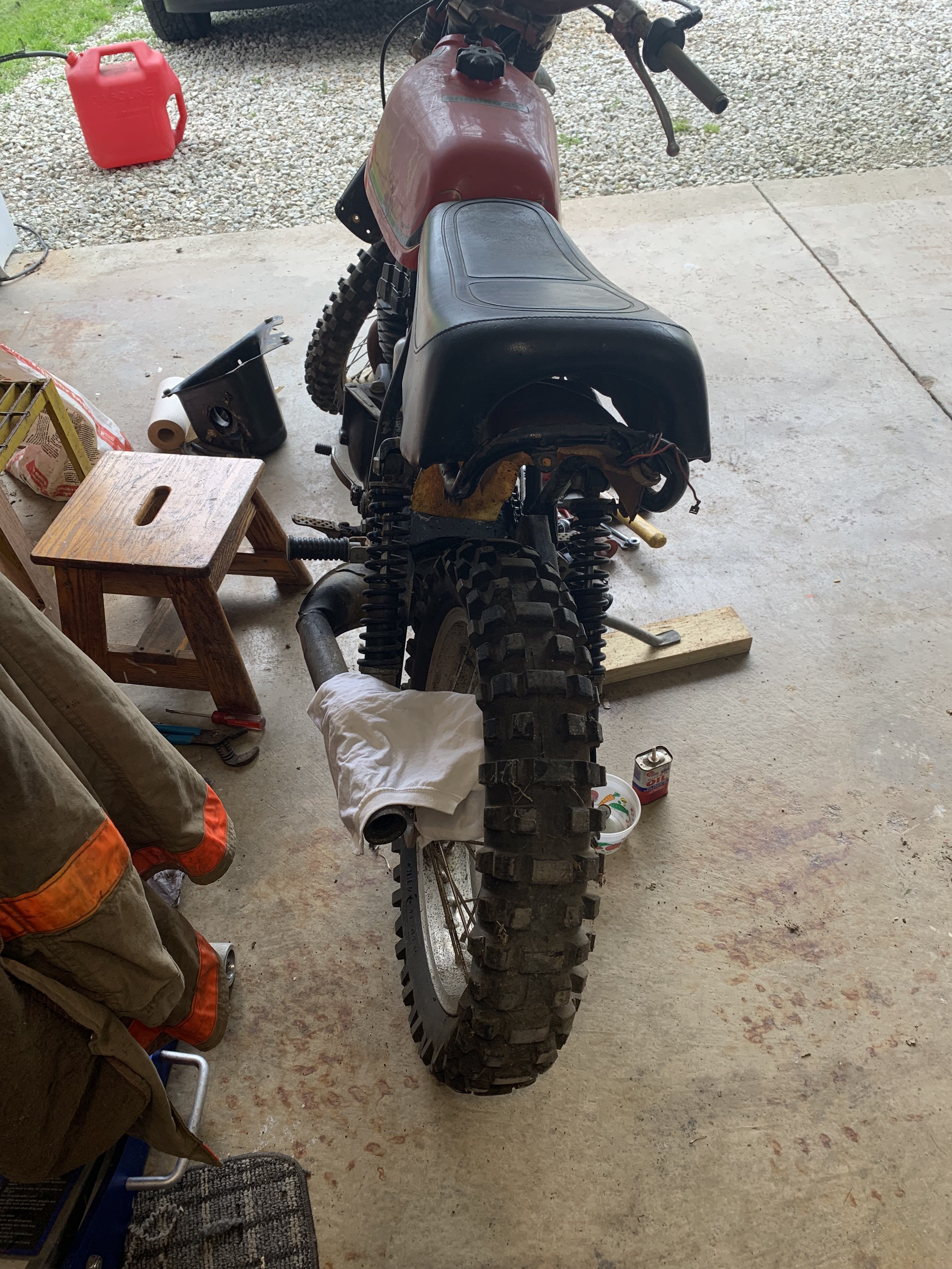

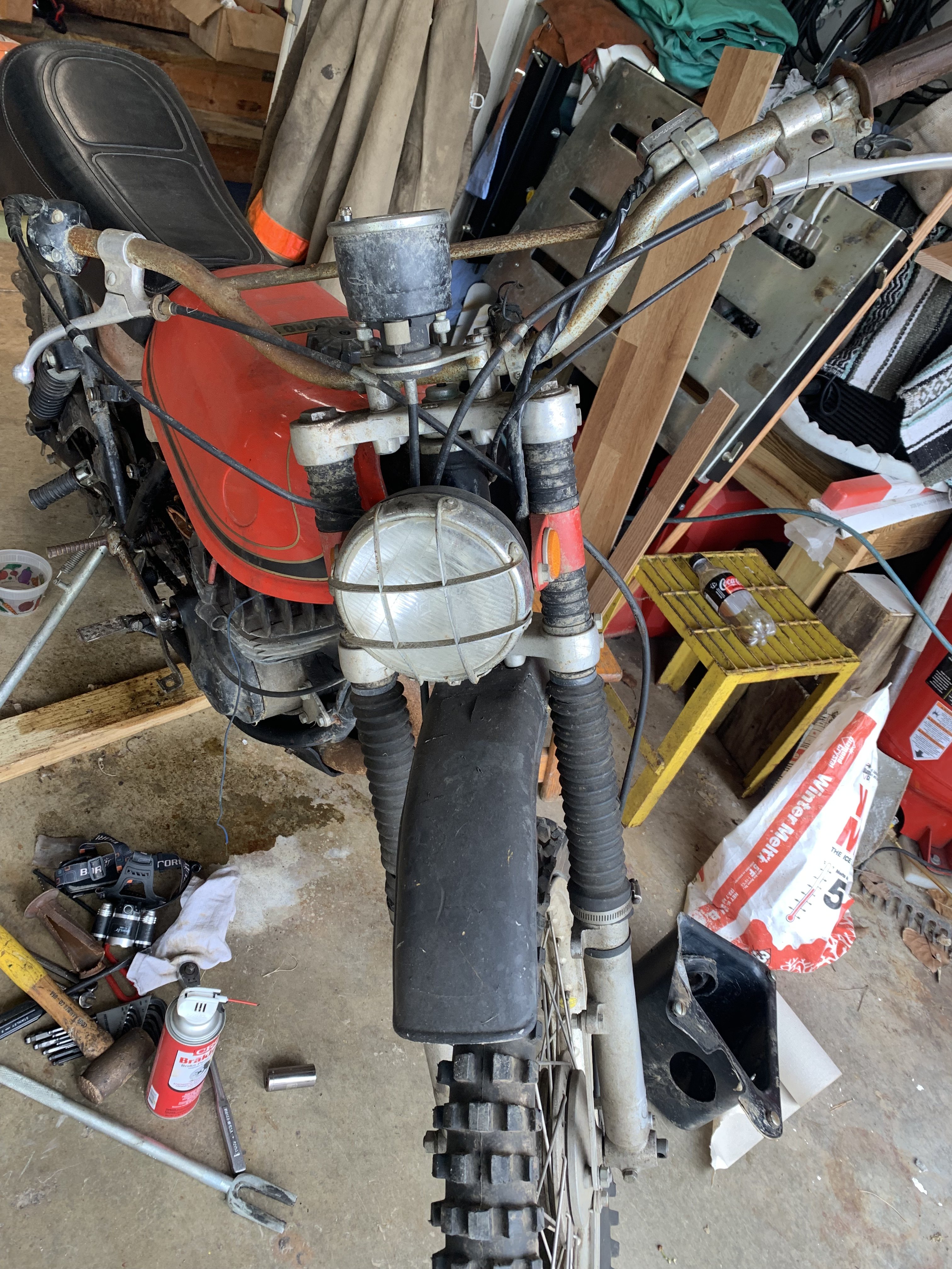

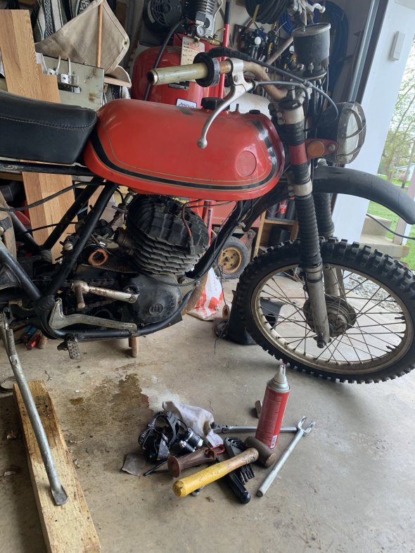

Liquidpopraver Posted April 29, 2019 Author Report Share Posted April 29, 2019 I’m going to contact southwest Montesa today for a manual. Here’s some of the pics of it Quote Link to comment Share on other sites More sharing options...
