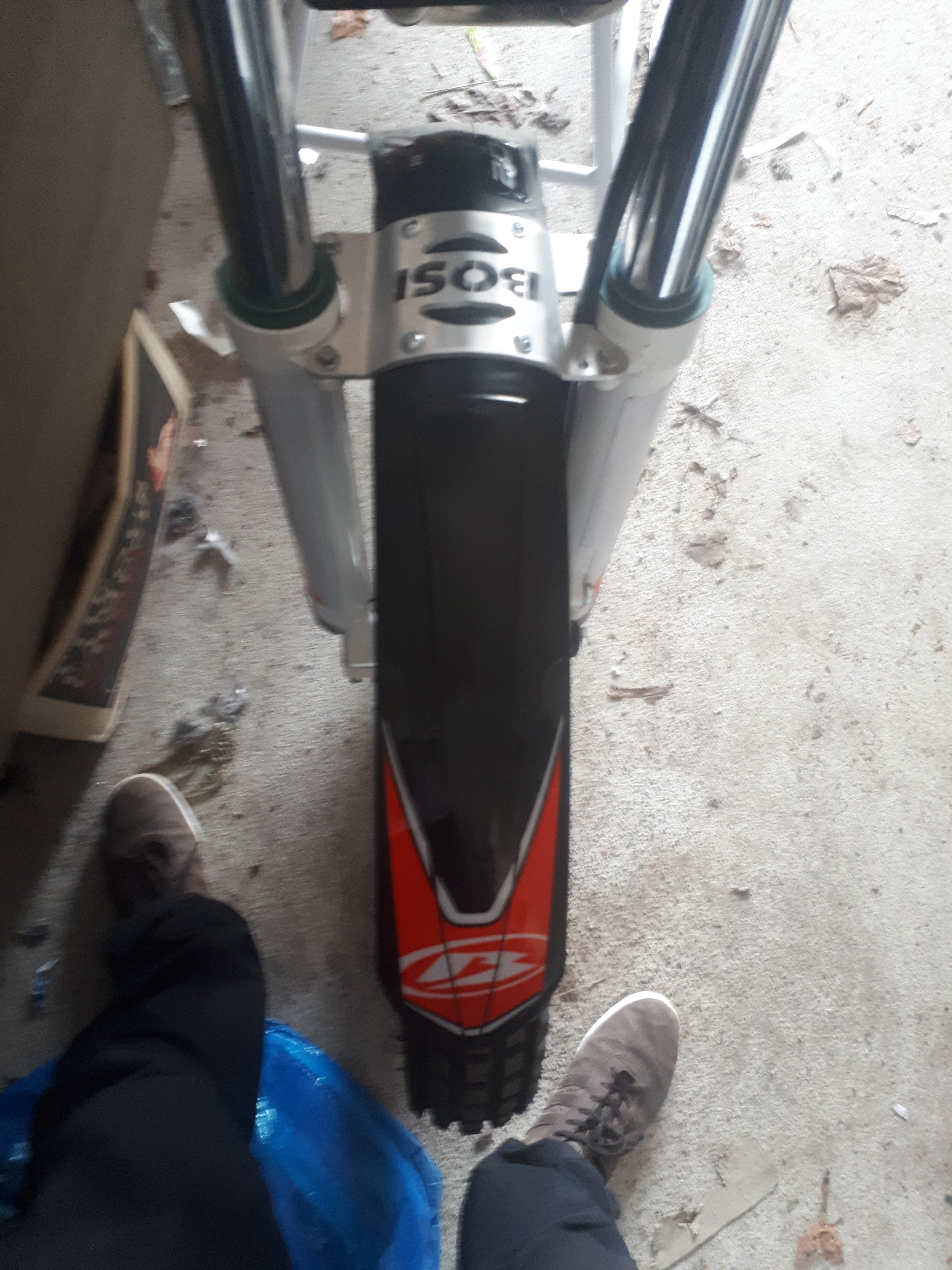

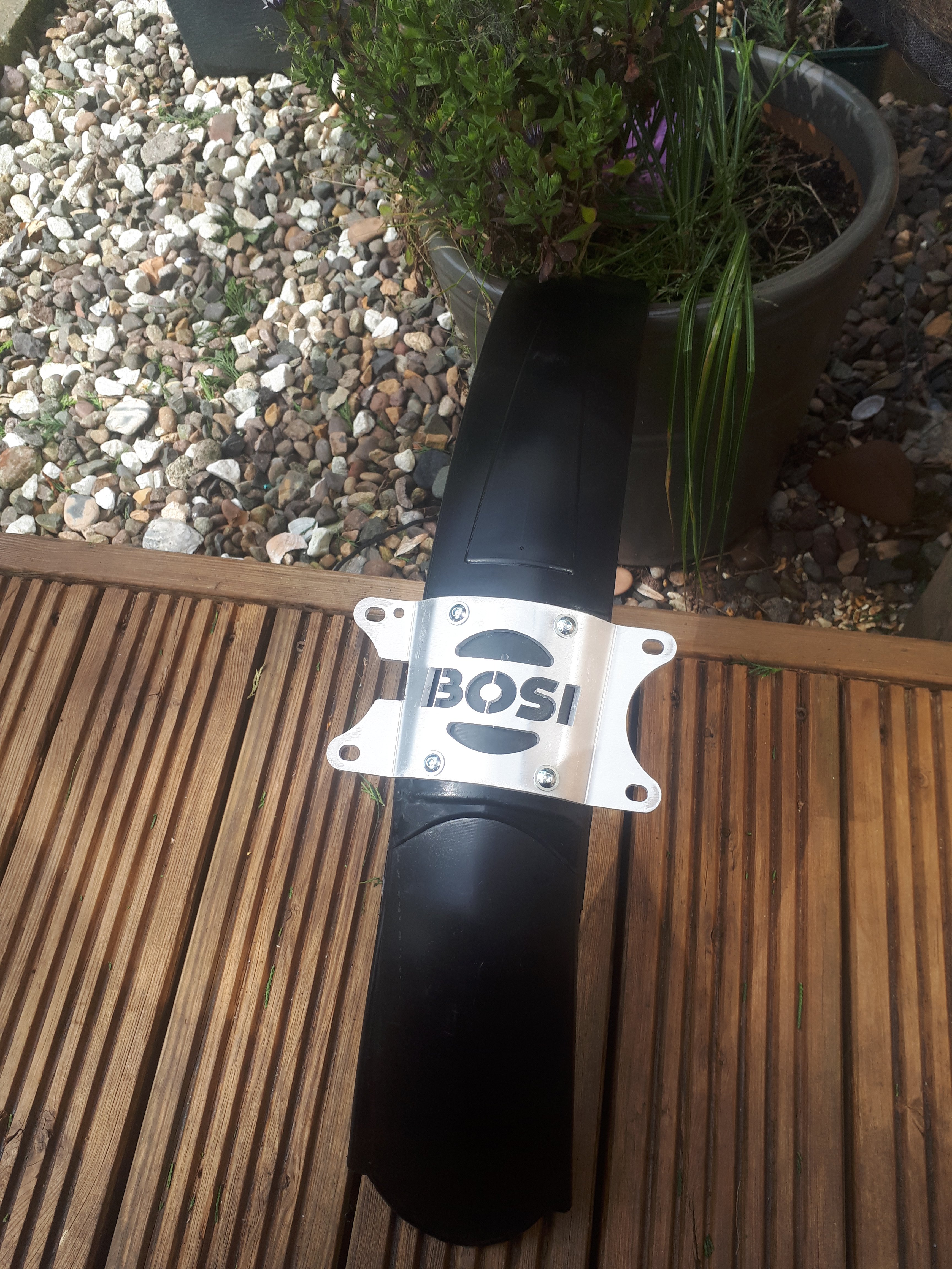

gazz Posted May 11, 2019 Report Share Posted May 11, 2019 I dont think there is any difference in the position of the mudguard fixings on the forks. Just fitted one to my 2019 Beta 200 and found when fitted there was no space on the brace to feed the brake cable through unlike the original beta mudguard. I cut out and filed a space for the cable to sit neatly and it looks good. There is a hole pre drilled on the Bosi brace and I was told this was for attaching a cable tye to keep the cable secure.Thought It looked crap so cut out a notch. Gaz 1 Quote Link to comment Share on other sites More sharing options...
misscrabstick Posted May 11, 2019 Report Share Posted May 11, 2019 I just cable tied my hose to the hole, a cut out is a nice idea though I may do that. (2017 300ss) 1 Quote Link to comment Share on other sites More sharing options...
rcgods Posted May 13, 2019 Report Share Posted May 13, 2019 I am running mudguard spacers (10mm) so have cable tied the brake hose to that. Quote Link to comment Share on other sites More sharing options...
