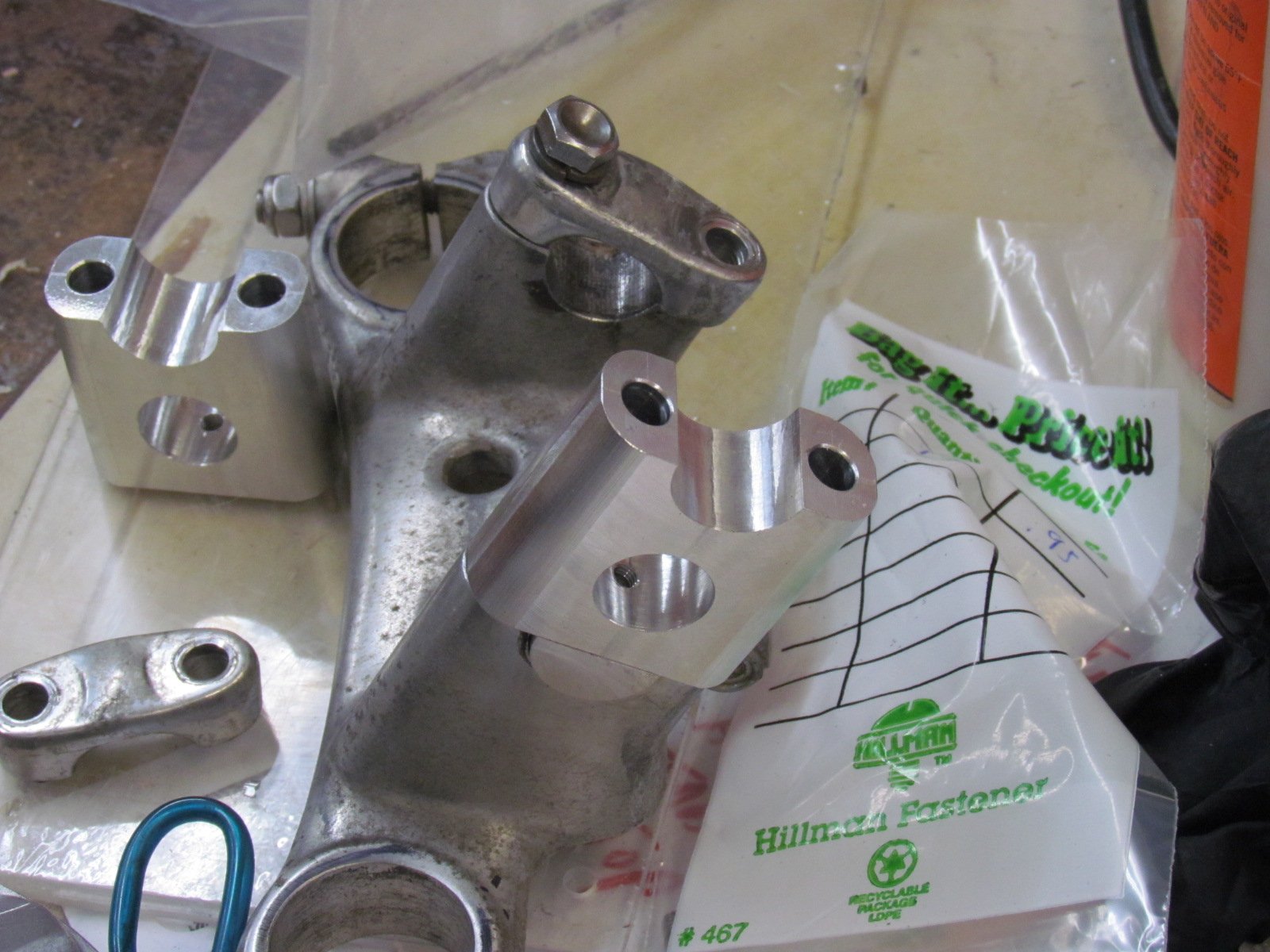

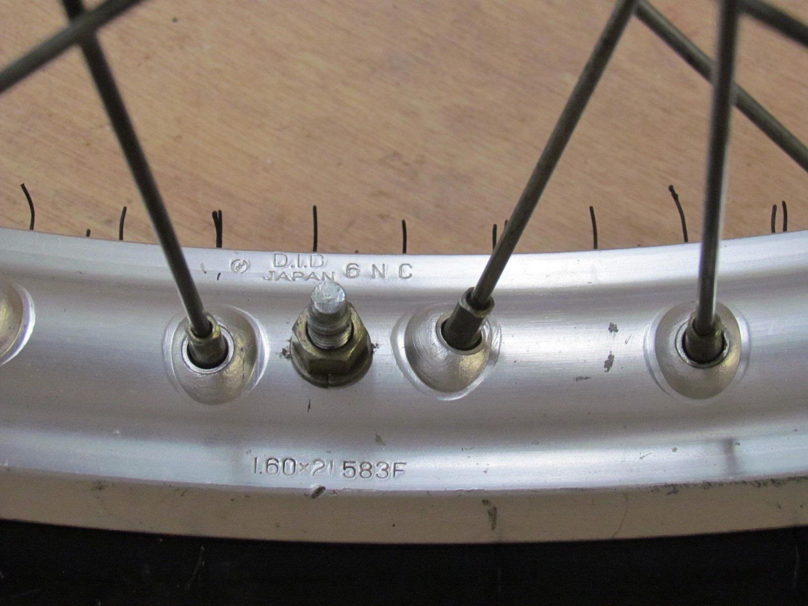

Tillerman6 Posted May 24, 2019 Author Report Share Posted May 24, 2019 Rim pic below. I's a DID rim. So are the "speedo drive lugs" right near the axle on the side away from the brake drum? 3 little tabs that stick out just a little? Did a little painting of the frame today. It's supposed to rain for 3 days starting tomorrow, so I had to get that going. Handlebar risers just need longer bolts to finish up. Quote Link to comment Share on other sites More sharing options...
feetupfun Posted May 24, 2019 Report Share Posted May 24, 2019 5 hours ago, Tillerman6 said: So are the "speedo drive lugs" right near the axle on the side away from the brake drum? 3 little tabs that stick out just a little? That's them yes those three little lugs. The speedo drive casing normally fits between the hub and the fork leg. It's a good design because you can take the wheel and backing plate away from the bike easily without having to undo the speedo cable. The speedo drive and cable can just hang there waiting for reassembly. I've been trying to take some rim stamping photos of my mystery wheel but my phone battery went flat. Photos coming later Quote Link to comment Share on other sites More sharing options...

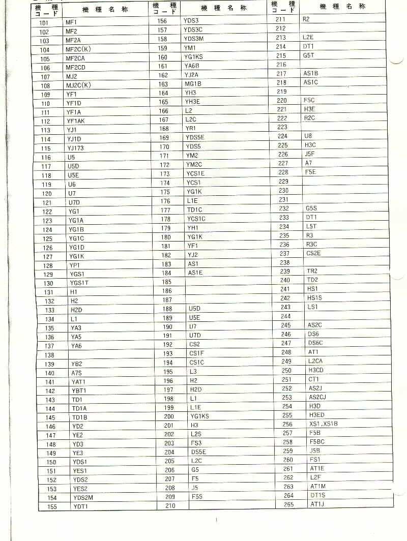

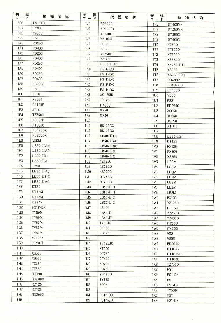

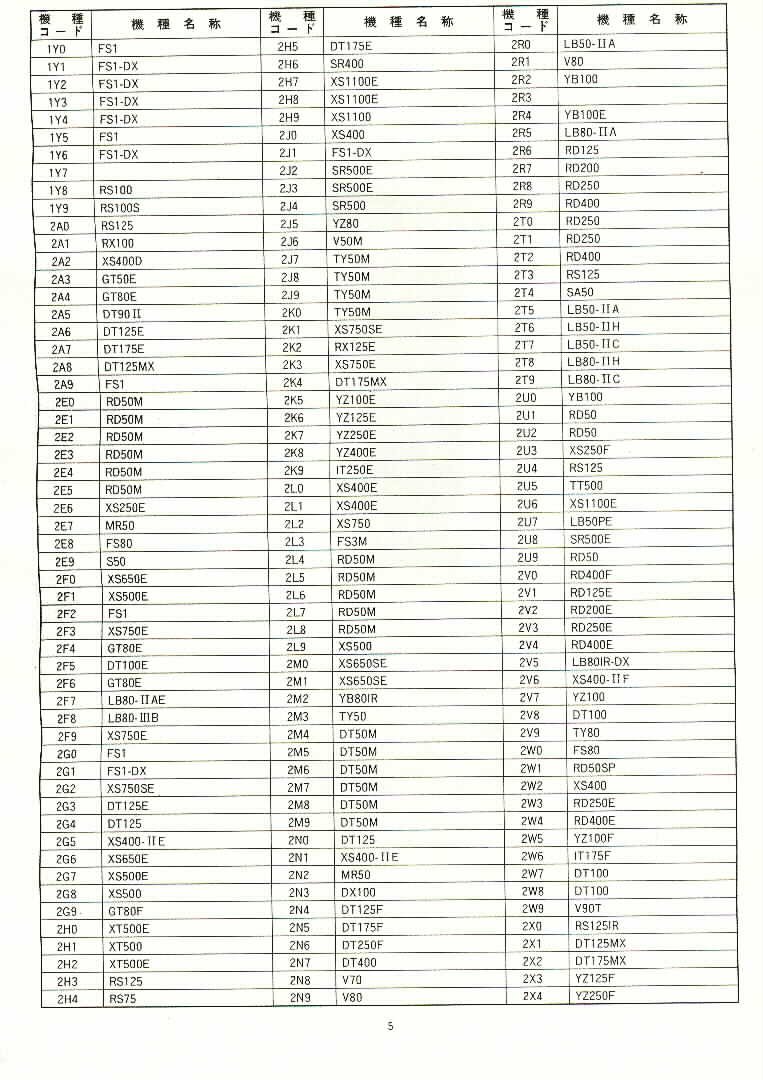

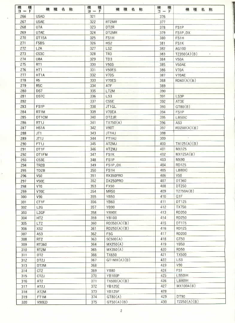

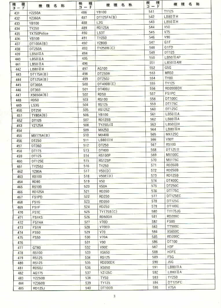

Tillerman6 Posted May 24, 2019 Author Report Share Posted May 24, 2019 3 hours ago, feetupfun said: That's them yes those three little lugs. The speedo drive casing normally fits between the hub and the fork leg. It's a good design because you can take the wheel and backing plate away from the bike easily without having to undo the speedo cable. The speedo drive and cable can just hang there waiting for reassembly. I've been trying to take some rim stamping photos of my mystery wheel but my phone battery went flat. Photos coming later While we are on the subject of tracing parts back to their parent machines, I remembered that I had a "Yamaha Cross reference Index file on my computer. I can't seem to get it to copy and send to the Trials Central website, but I'm working on that. I think everyone that has an old Yamaha should have that information available. It's really just a list of the first 3 digits of the Yamaha part numbers and a "Tag" name for each one. The first 3 digits are code for the original bike that the parts were built for. Other bikes use the same parts later on, but having the 3 digit code on a part tells you what other bike the parts were originally used on. That way you can look up that year and model on Ebay or whatever under the original year and model and possibly find your missing parts that way. For instance, the part numbers beginning with 434 were TY parts. My brake shoes off the front wheel were 322 which was from an RT2 MR ( maybe a street bike?) I used Windows Photo Viewer to open these. Hope this helps! I will keep trying. Quote Link to comment Share on other sites More sharing options...
feetupfun Posted May 25, 2019 Report Share Posted May 25, 2019 (edited) Yes that is a cool way to help ID Yamaha parts if they have the prefix on them. That list can also be found using google. I was told by a Yamaha dealer that there is a system that records each time someone asks for a Yamaha part that is "no longer available" and once enough people have asked, they start making them again. I suspect that TY175 kickstart levers might be one such part that they now sell. That prefix on your brake shoes doesn't help much with identifying your backing plate though because many Yamahas models use that same pattern of brake shoe. Edited May 25, 2019 by feetupfun Quote Link to comment Share on other sites More sharing options...
